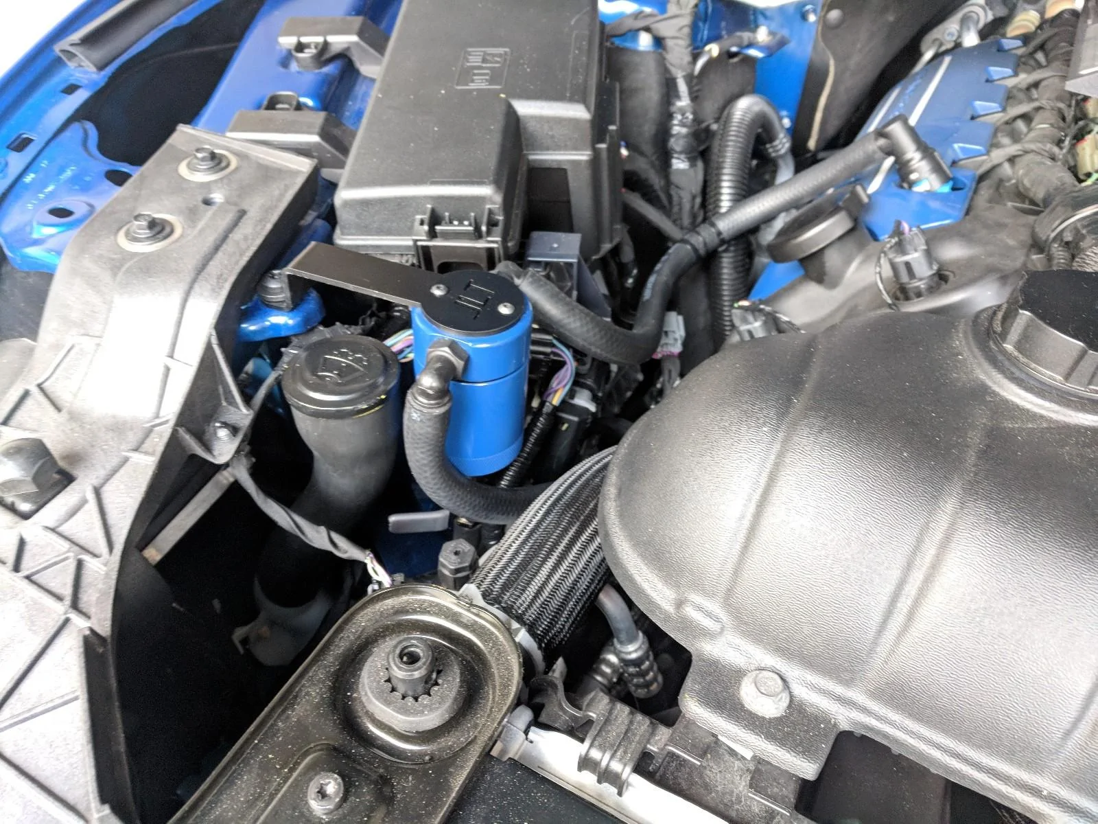

I sold my frpp catch cans because they suck. They don't catch as much as jlt and it is a hassle to take it out and empty it.
I bought a driver side jlt catch can that comes with bracket and installed it on the passenger side. I also added a quick drain valve and ran a hose under the car. It catches more oil than the frpp.
Driver side is a waste.

Did you have to extend the hose or did it snap right on? I have the passenger side one now, but I feel like it sags and might be rubbing against one of the sensor harnesses. I think i might copy you

I did not use the hoses that came with the kit. I bought power steering hoses and ran it myself.
