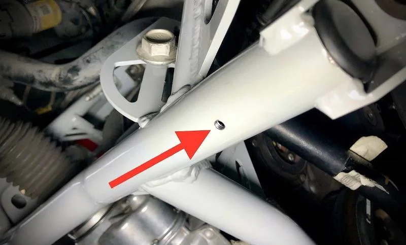

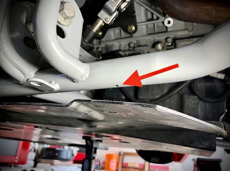

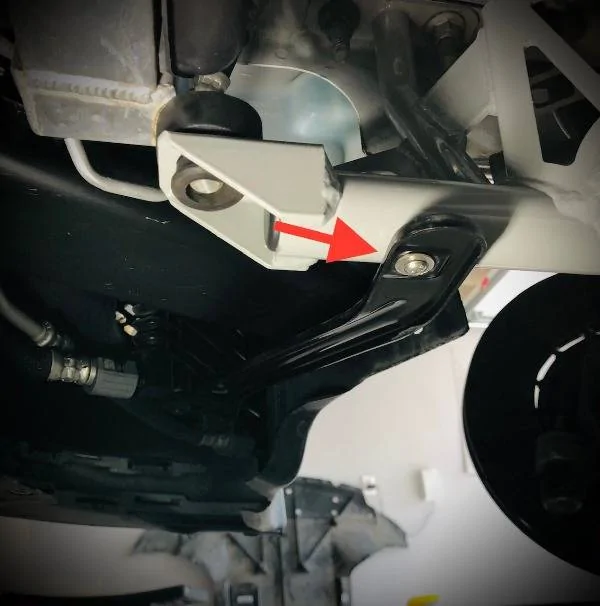

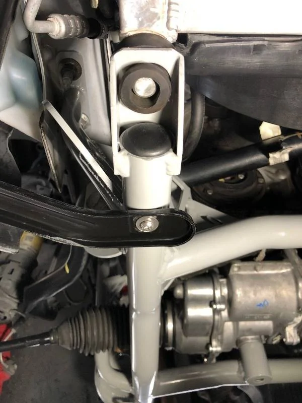

You can in fact mount the oil and trans coolers to the Steeda K-Member. I drilled and tapped the K-member for those brackets and also in various places for the undertray. You can reach out if you have any other outstanding questions about the install. I dropped a few photos so you can see where and how I mounted those pieces.
