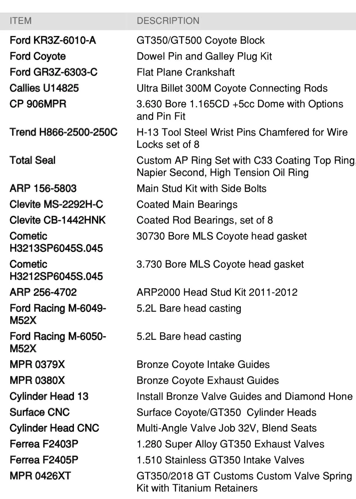

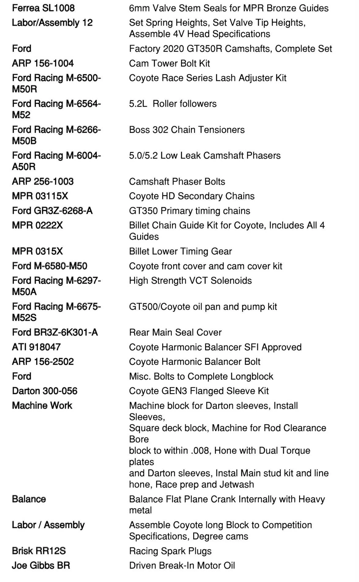

The Engine will be fully built by MPR racing engines in South Florida. Going full tilt. This is a brand new engine being built separately. My stock engine is still in my car. I’ll be driving it and racing it while I’m procuring parts for this build. I’ll keep my stock engine as a backup once I make the swap. Engine will be able to hold 1600-1800 crank HP. RPM good to 8800-9000. Although I don’t plan on setting it that high, maybe 8500.

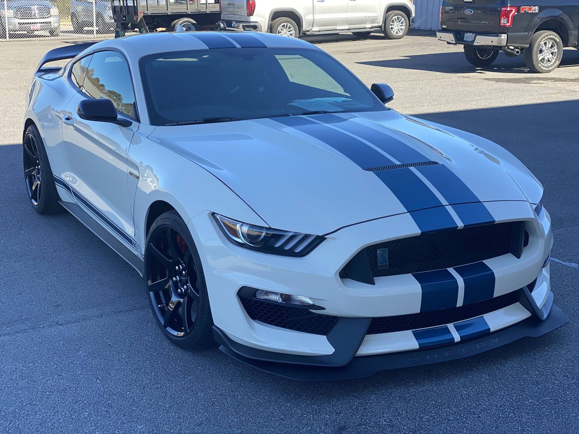

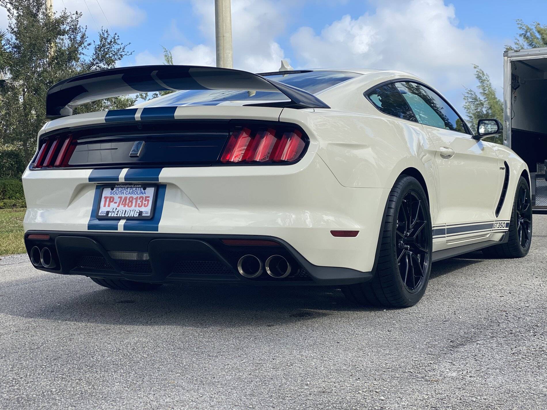

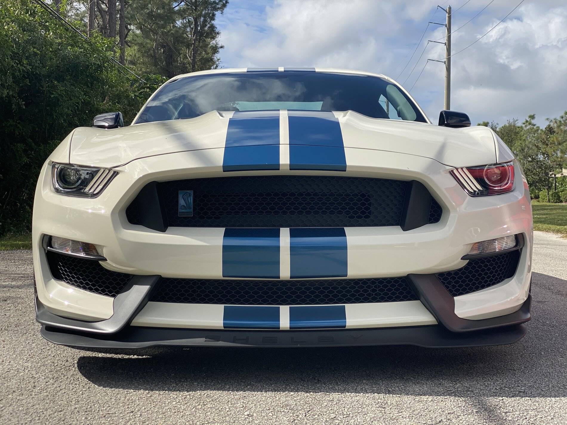

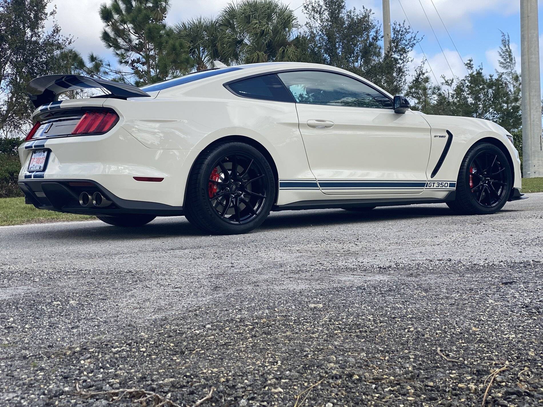

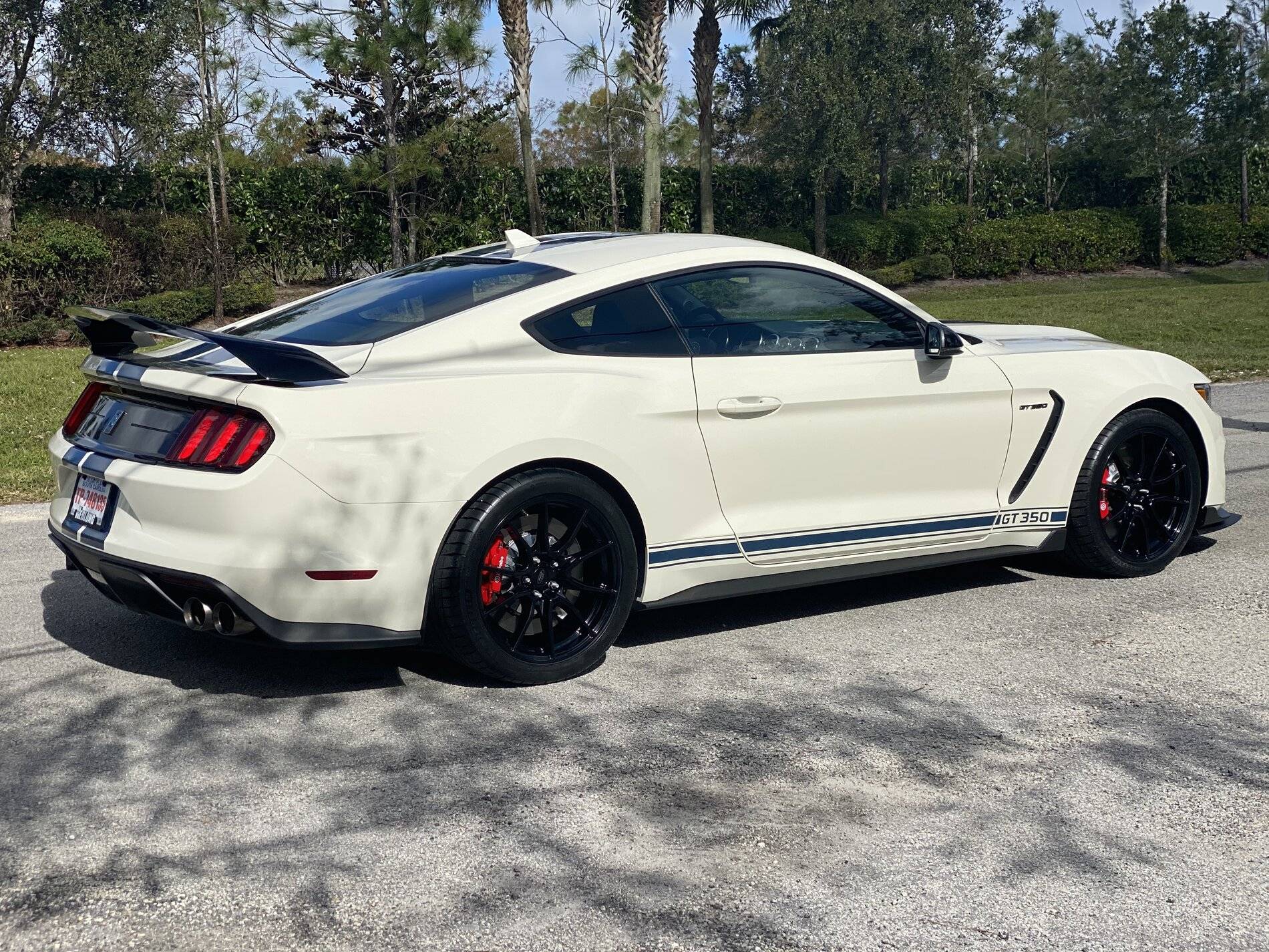

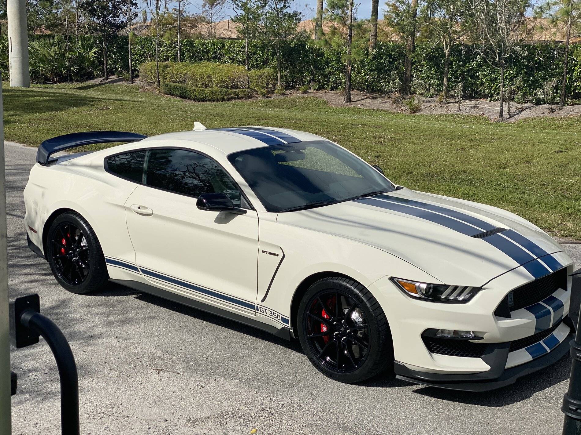

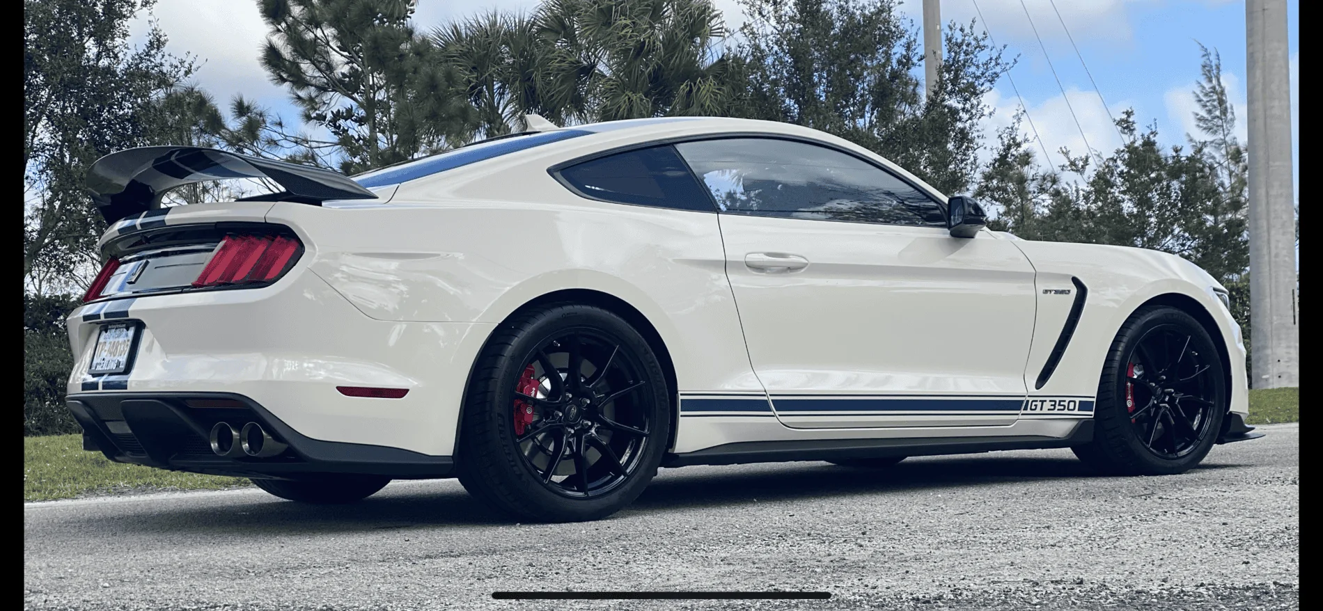

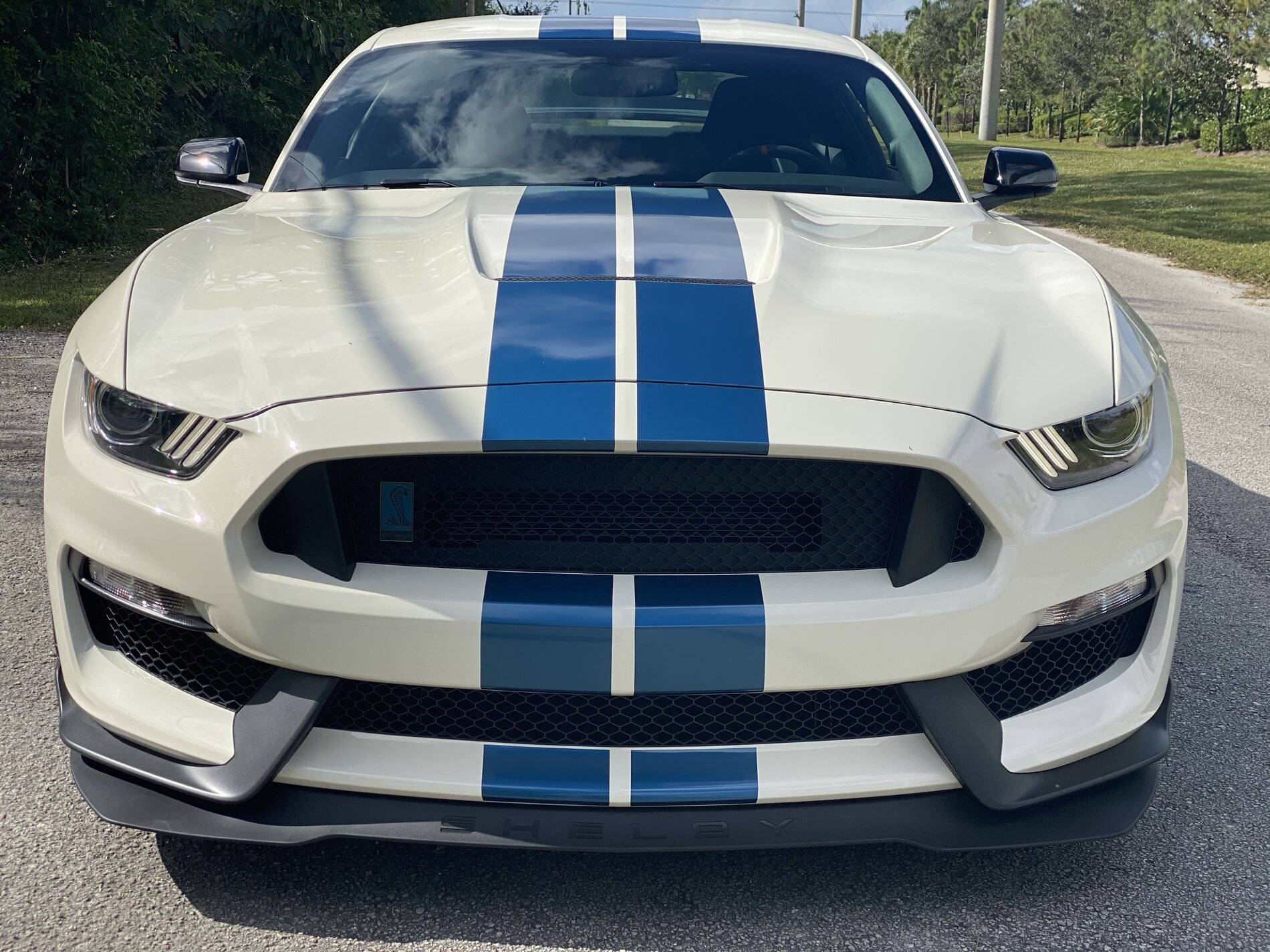

THE DAY I PICKED IT IP.
CERAMIC COATED AND WEARING STREET SHOES
