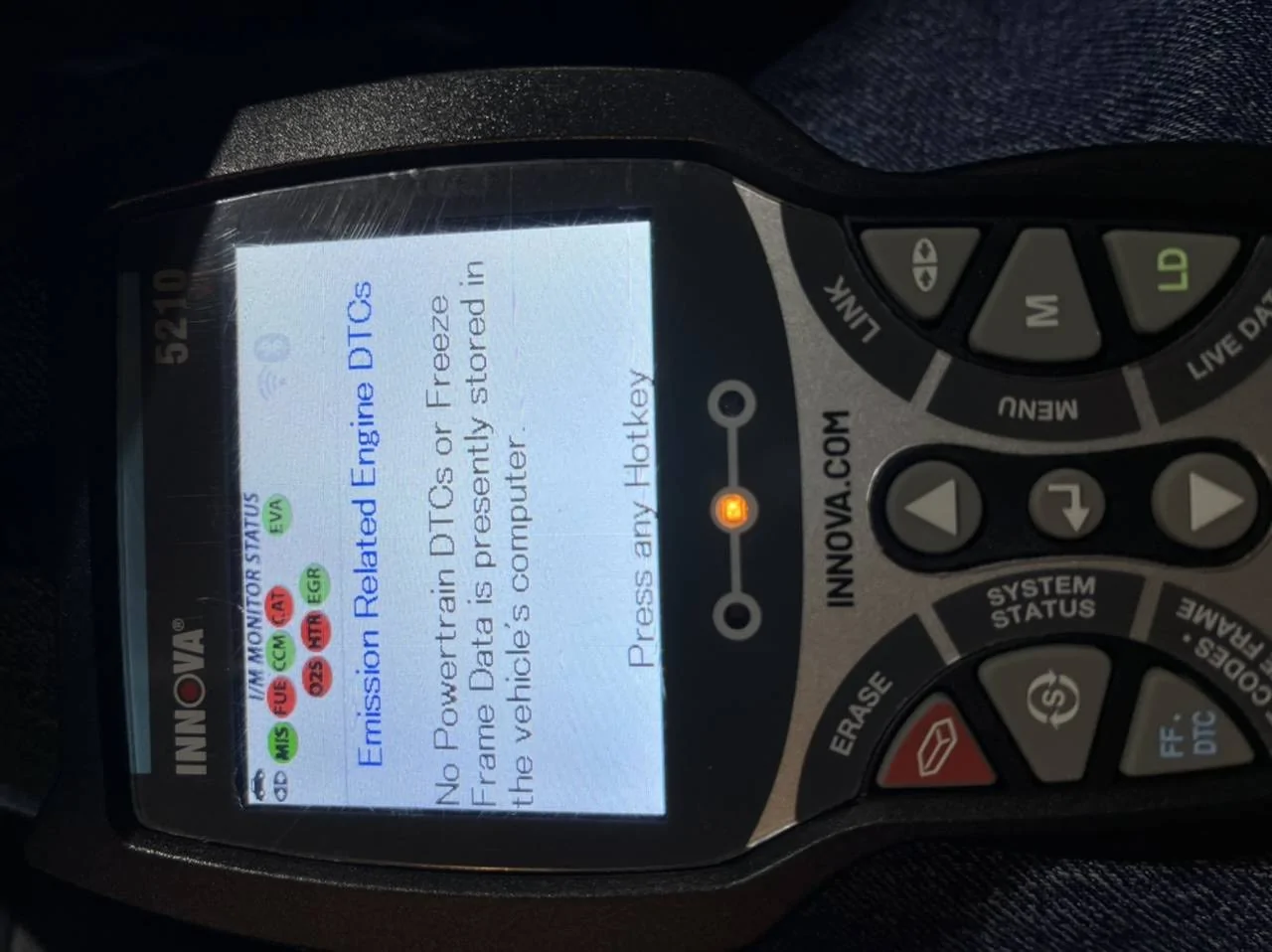

Last year the car was stock, and it passed inspection. Since then, I installed myself a full 3” catback (with stock cats and headers) and the Ford Performance Power Pack 2 (M-9603-M8A). Now I’m struggling to pass the inspection. I’ve gone through enough threads here that it should be the kit/tune. The cat-back should not impact emissions.
Early September of this year, at 5,763 miles, I cannot pass the NYS emissions readiness, which is part of the inspection process. The tech is stating I have 4 out of 8 monitors that are not ready. They said to drive it more and they should ready.
I have been driving it and been back to the shop several times. Now I’m up to 6,384 miles and I still cannot pass the emissions readiness. I did traffic, highway, all sorts of driving. Same results.
They gave me a full printout and the OBD Drive Cycle for the 2017. I ran through the printout drive cycle and bought a good OBD2 scanner. I’m still seeing four monitors not ready:
  1. FUE
  2. CAT
  3. O2S
  4. HTR
They also suggested it could be the tune. This is the vanilla PP2 tune that came with the kit. I believe I can really test that without removing all parts and the tune as the car would run like crap with the stock tune and the kit installed. I reached out to Ford Performance and I’m waiting for a tech to respond.
I’m looking for suggestions:
  • Keep driving (seems pointless)
  • Reflash with Pro-Cal, check settings. Maybe there is a switch I should check
  • Pull the PP2 and de-tune
Has anyone seen issues with Ford Power Packs and NYS inspections? I’ll be happy to answer any questions.

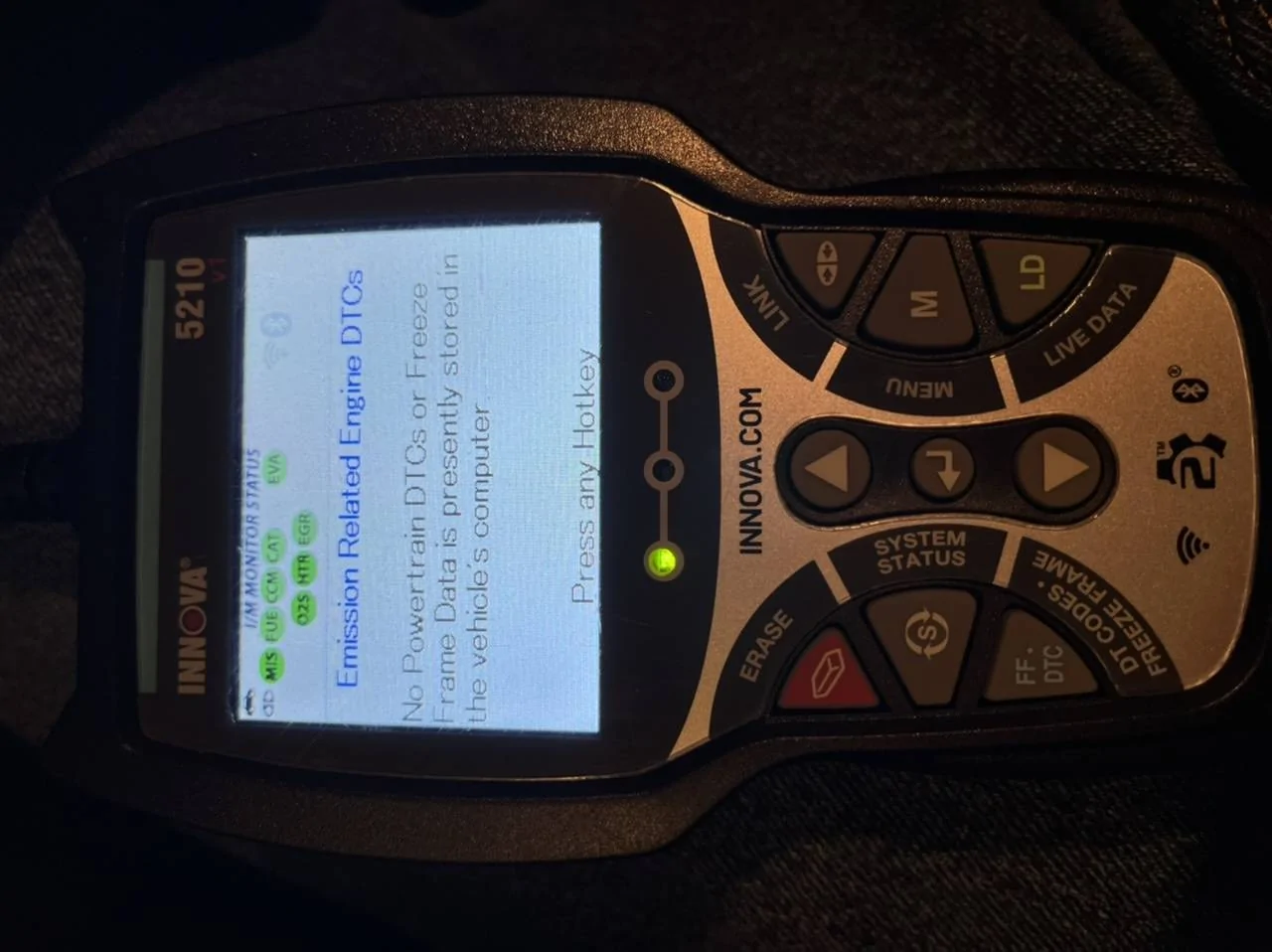

One last college try. Pulled the battery for 45 minutes and drove 65 for 5 minutes twice, then went to 65 to 40 without braking for at least 5 times and got all Green!
Thank you all again. I knew the PP2 kit was 50 state good, I just don’t think I was hitting all points for the drive cycle
