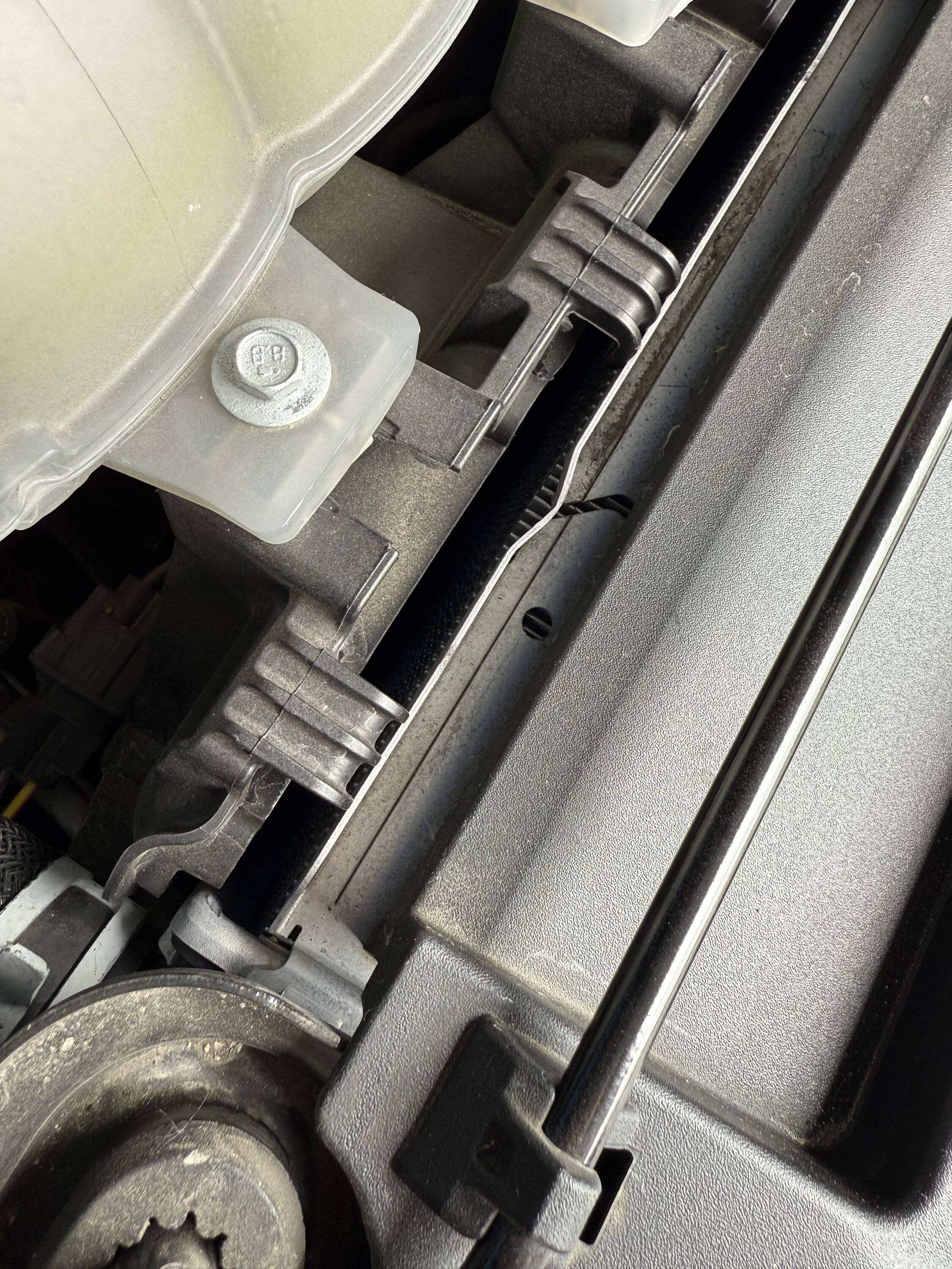

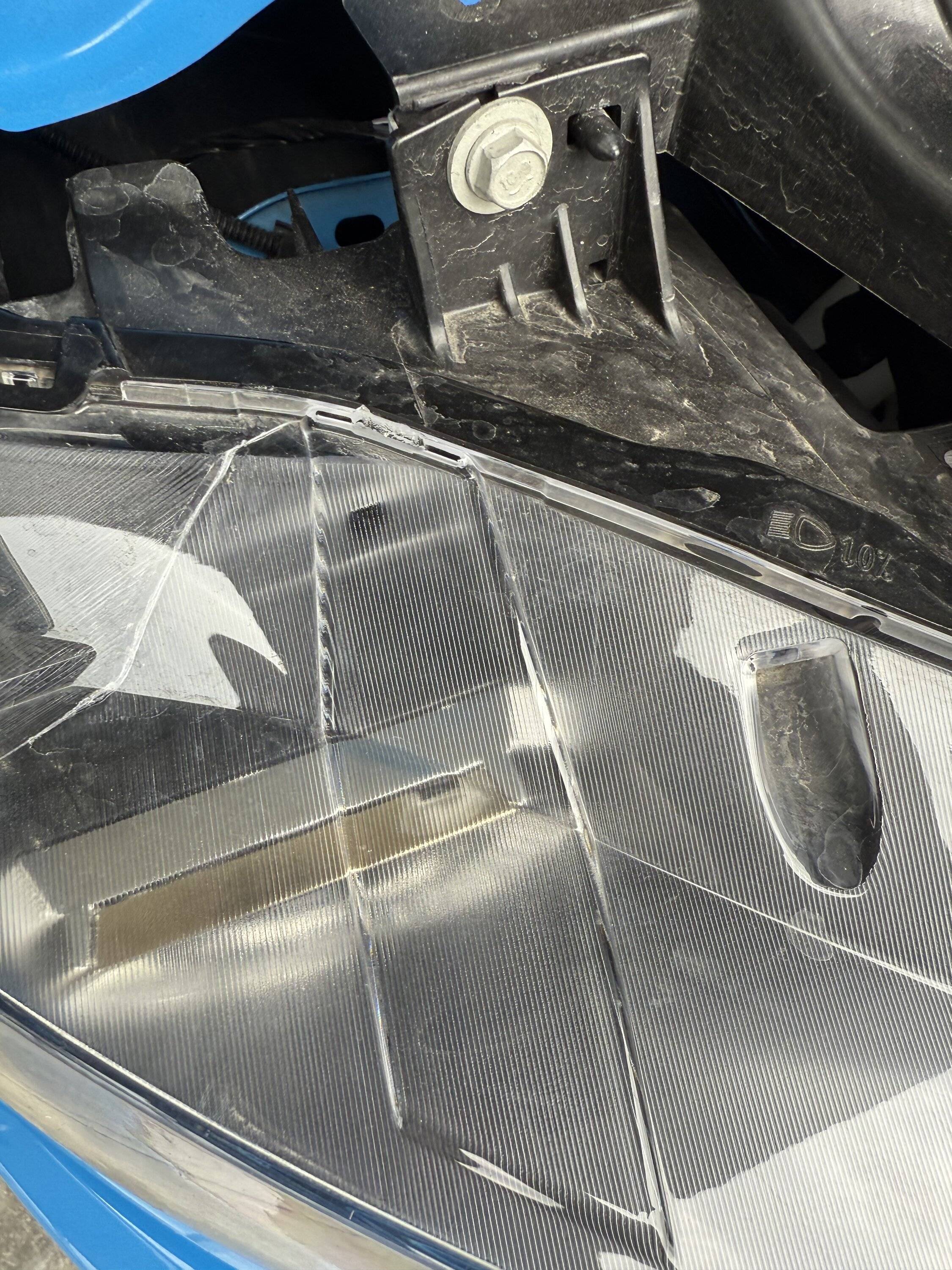

So, I got hit on Saturday (I put it in the What did you do to your S550 today thread). I’m going to be calling to get a repair estimate but was looking under the hood to check a few things. 1) I’ve noticed my coolant level is going down (driven a couple short trips post-accident). No visible leaks that I can tell and it’s dropped since I marked it before a short 2 mile drive the other day.
2) Can someone confirm the radiator shroud clips are positioned correctly in the attached pic? I don’t have a good “before” picture for that.

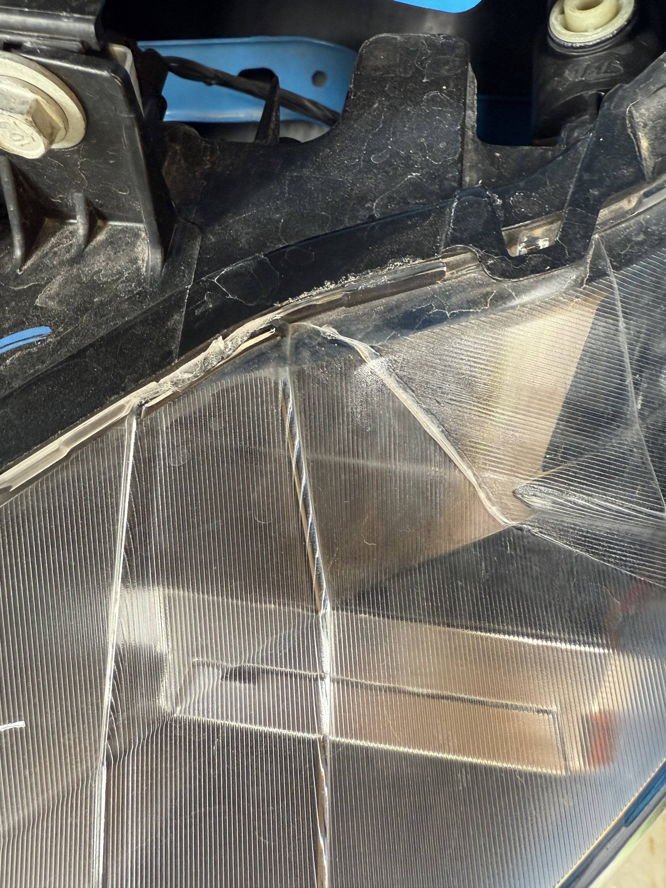

I’m thinking some things may have gotten pushed more than I initially thought. I lost a push pin in the driver side fender liner that was there pre-accident (I got hit on the passenger side). Now I’m worried there was some movement in the engine bay, there’s a piece on the driver side headlight that appeared to be a clip that looks sheared off too. Now I’m starting to worry there’s other issues that I need to think about.

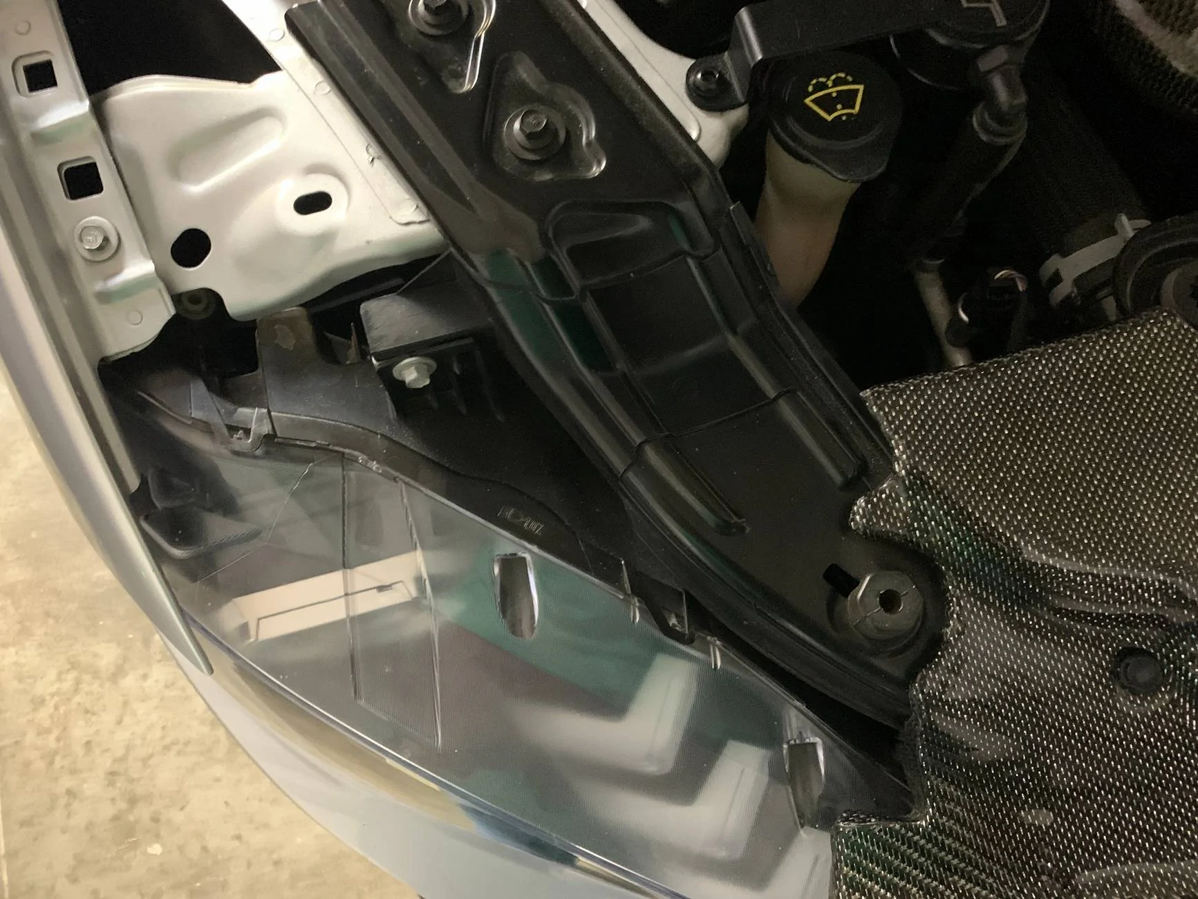

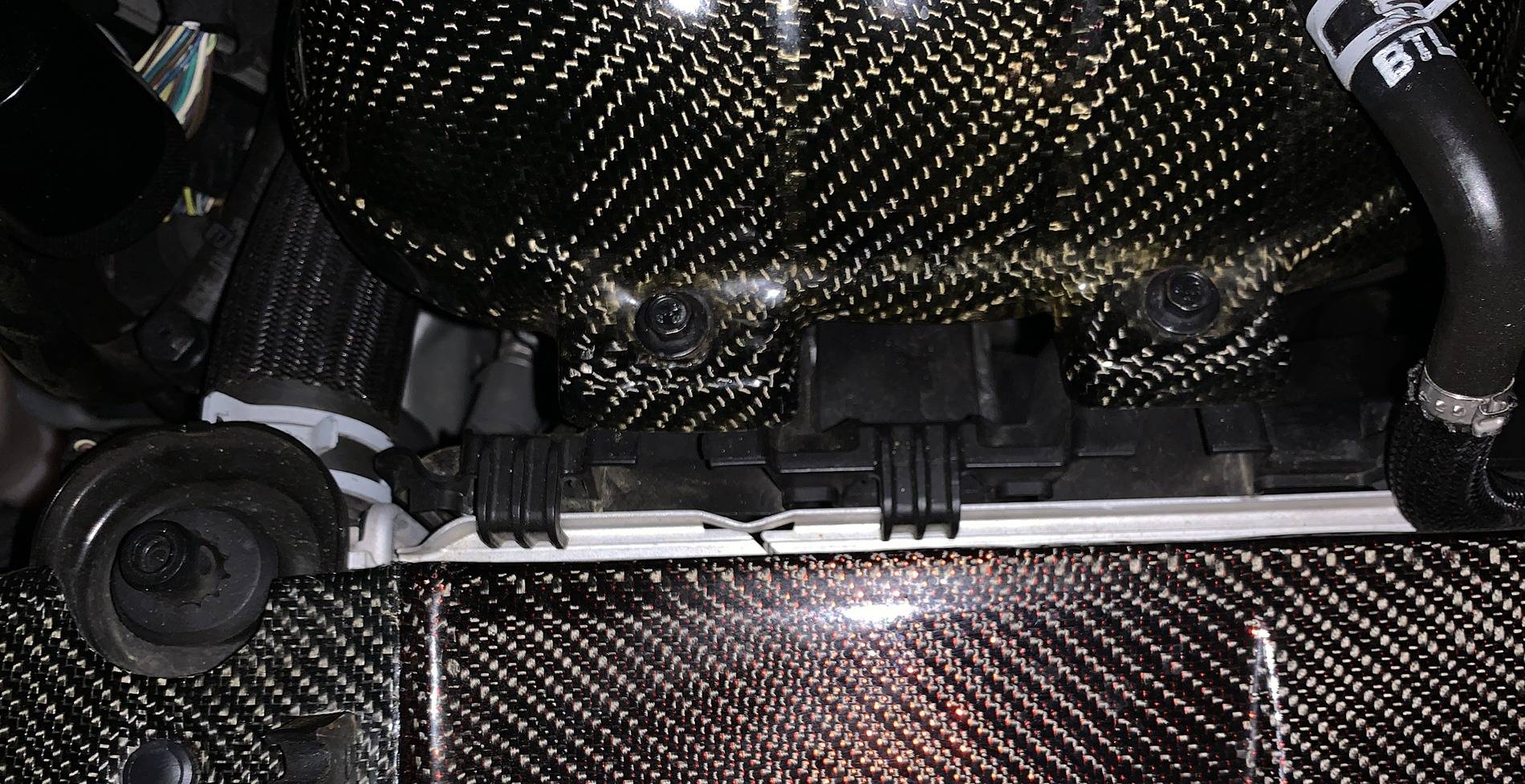

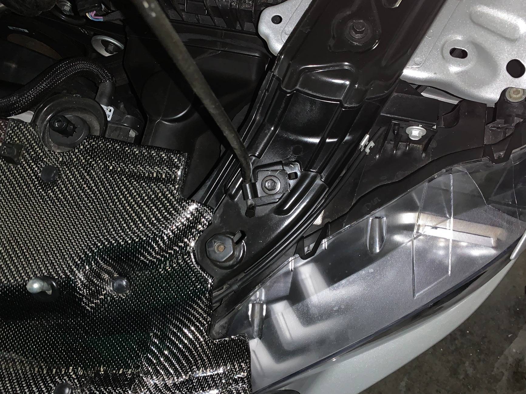

You did take a bit hard of a side hit. it is good you are investigating potential damage to both sides on your own. I went to a reputable repair shop and found its technicians were not as particular as the owner.
I wonder if your composite radiator cross-support frame is intact. You'll want to check for cracks once the front bumper cover is off. Here are pics of my assembly. Hope they help.

I just went out and checked my expansion tank.
Sorry to say your radiator has taken some sort of trauma. The hook-like holds of the tank, those should be going over the metal edge portion of the radiator, not rest behind them.

Same with the headlight. The edge you're interested in is in-tact with mine.

Thanks for the pics and they do confirm my suspicions. I’ll have the shop take a good look at everything in there

BTW @MAGS1, I took a closer look on my car at the area on top of the headlight just in front of the 90 degree mounting bracket, and mine looks like it was not a broken clip, but rather leftover mold sprues from which the headlight was removed during the mold process (both LH and RH are exactly the same on my car it seems).
Your LH headlight mount pick seems to have some "fuzziness", but that may just be road dirt/film; I cannot tell for sure.
Edit,
Thanks, I didn’t think I got hit that hard (airbags never deployed) but probably got hit in the right spot to move things. My coolant is below the minimum line so I’m getting a bottle and will fill it up so I can get over to the body shop. I’m totally sick over it even more now that I’ve taken a closer look at some things
Both headlights have a jagged edge where what appears a clip should go. Will see what the body shop says but I’m pretty sure the front bumper got pushed more than I initially thought
