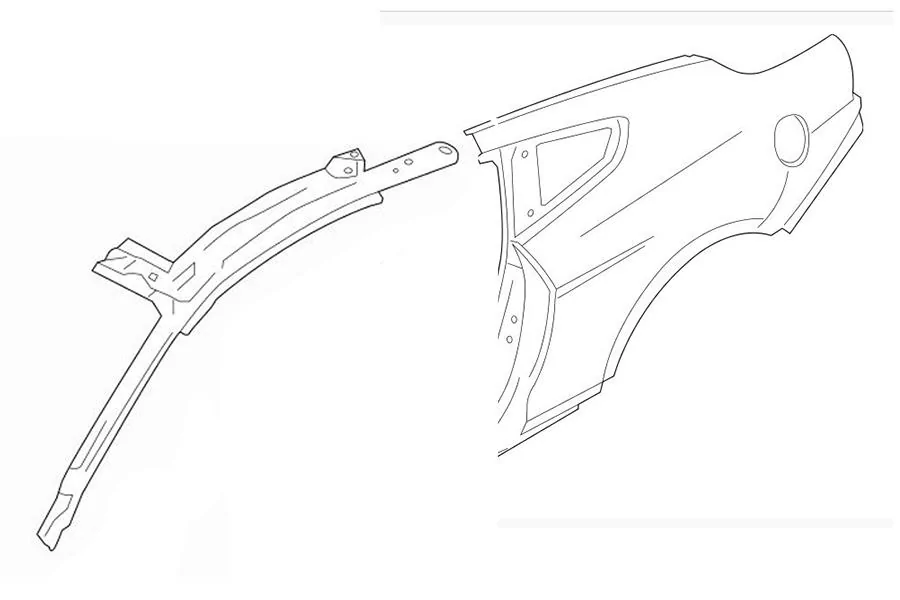

Bringing this old thread back to life with a question. I am having my quarter replaced due to a tree that got split in half during a storm.....but my damage also includes a new trunk, tail light, roof will need some dent pulling and paint, and the upper door frame (not sure what you call it) that goes from the quarter panel all one piece down the windshield pillar.
Well I was looking up these parts online and in the diagram it appears that the quarter panel is all one piece up to around the area above the door, including that flat piece between the door and quarter glass. (around where the drop cloth ends in your picture). In your pictures it looks like they made two cuts, on that flat section and on the part between the quarter and back glass. I'm wondering why they didn't do all of it?

It actually continues all the way around the side window and ends at the hood. They cut it due to the additional work that would be involved removing the front windshield and installing the new one to that point.
What I was looking at was two pieces. See diagram. Just replacing the full quarter wouldn't require replacing the other part, does it? Seems to me that they could just cut it at the point where the quarter ends. But in my case, there is some damage near the aft area of that pillar section so I wonder if they'd just cut a small piece to patch or replace the whole thing.
That second part you're seeing in that diagram is a part of the frame. Not the panel.
Looking at the Ford Parts site for the actual panel makes it appear that it is separate. Could just be a splice on the diagram to make the image smaller.
The body shop will be able to tell you exactly what they will do with that smaller damaged section.

I see I never updated this thread with the outcome of mine. Totaled. The final insurance estimate was over $13,000 for repair on a cash value of $18,000. What did it in was that top piece, they said that Ford does not allow it to be sectioned and replacing the whole thing down to the lower windshield pillar also requires replacing the roof panel because of how its welded to this door frame. Plus they put in for an inner quarter saying it too was dented in.
So I got out of the Mustang and opted to not get another one. It is now awaiting assignment at the insurance auction, it'll probably be parted out. What a shame.
Those quarters are ridiculously expensive to repair!
