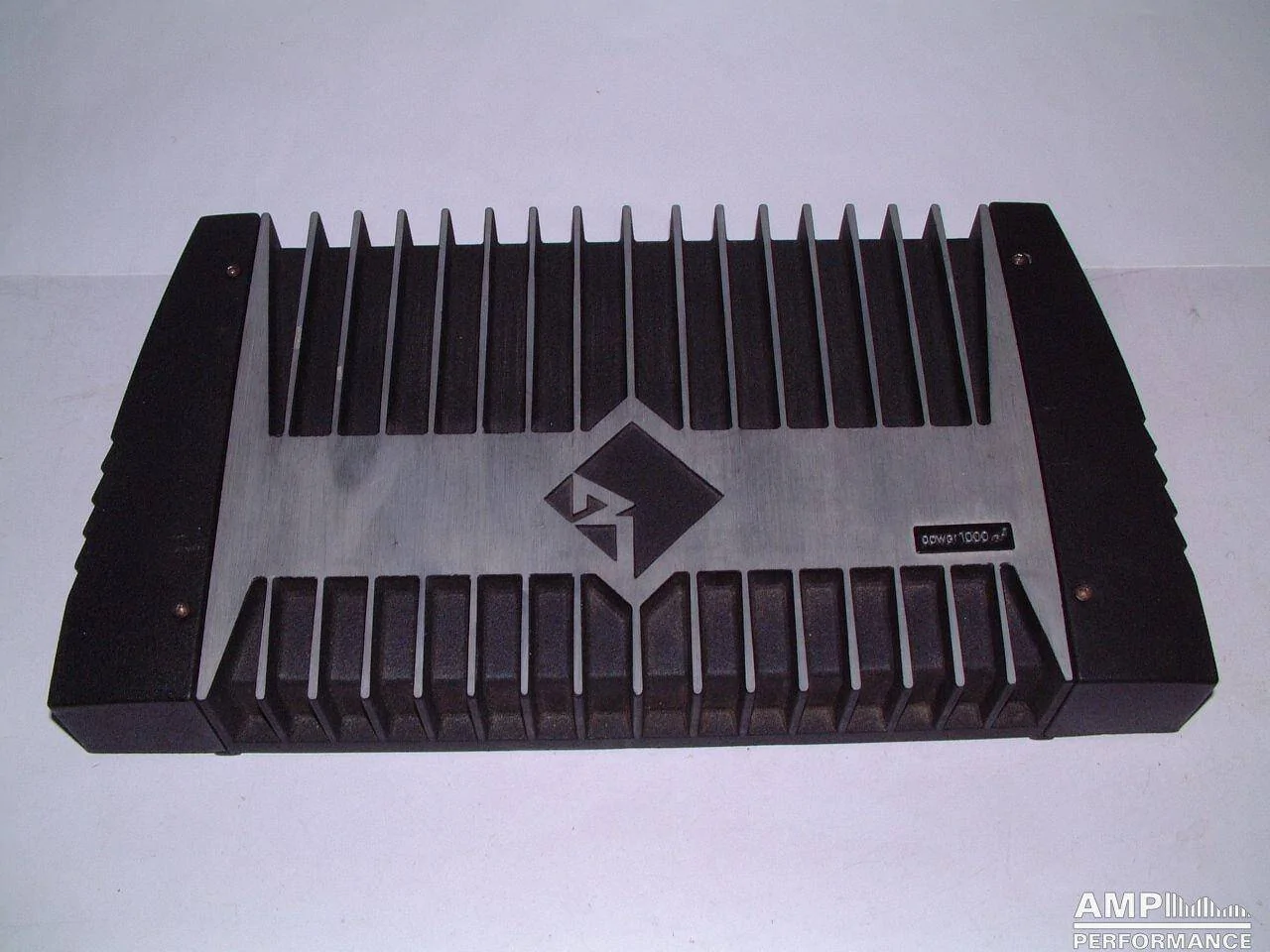

Nothing like a class A amp for sound quality but expect it to get HOT
Or are you guys talking about bass thump? Get a bank of commercial capacitors.................

Is that Rockford class A or AB? most crap today is D which I don't like for audio quality but class D amps are getting pretty good.
