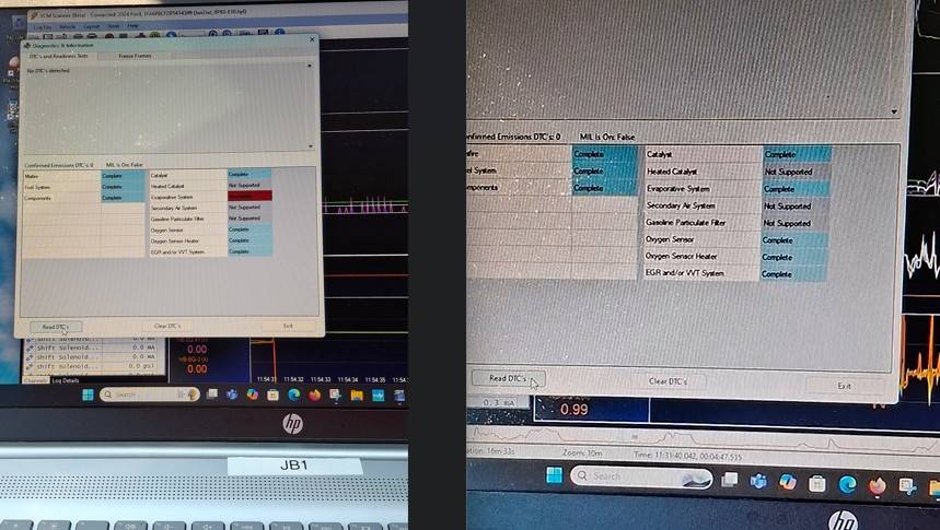

Installed the LT's Dec 16th, Drove normally for 2 weeks, checked the monitor status Jan 2nd, The O2 part of the cycle was complete, the evap was still incomplete,
I drove it hard for 2 days and all monitors were ready when I checked it again.
