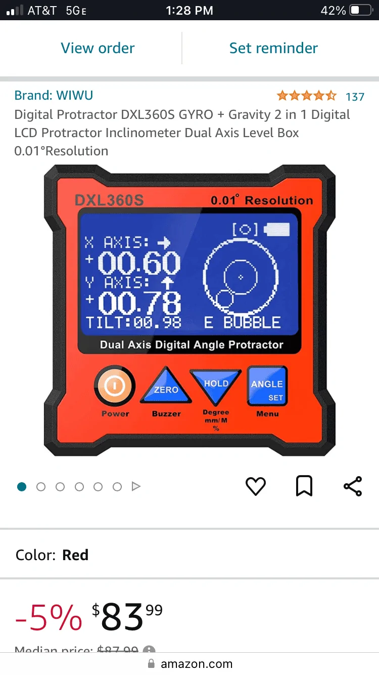

i use this gadget set on top of a level i cut to precisely the diameter of the rim.
spec sheet of level says accuracy to 0.05 degrees.

Measurement error is the most likely culprit, but you should also take ride height measurements as well to make sure there are no other contributors.
