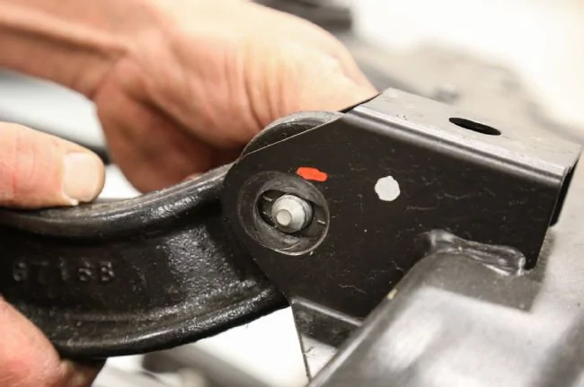

Clocking bushings can be done on the alignment rack. See below:
https://www.mustang6g.com/forums/th...hose-bushings-after-lowering-your-s550.44129/
As far as the rear camber adjustment goes, basically tell him that the inner point of the camber link is in a slot, so pushing it inboard will add more negative camber.
