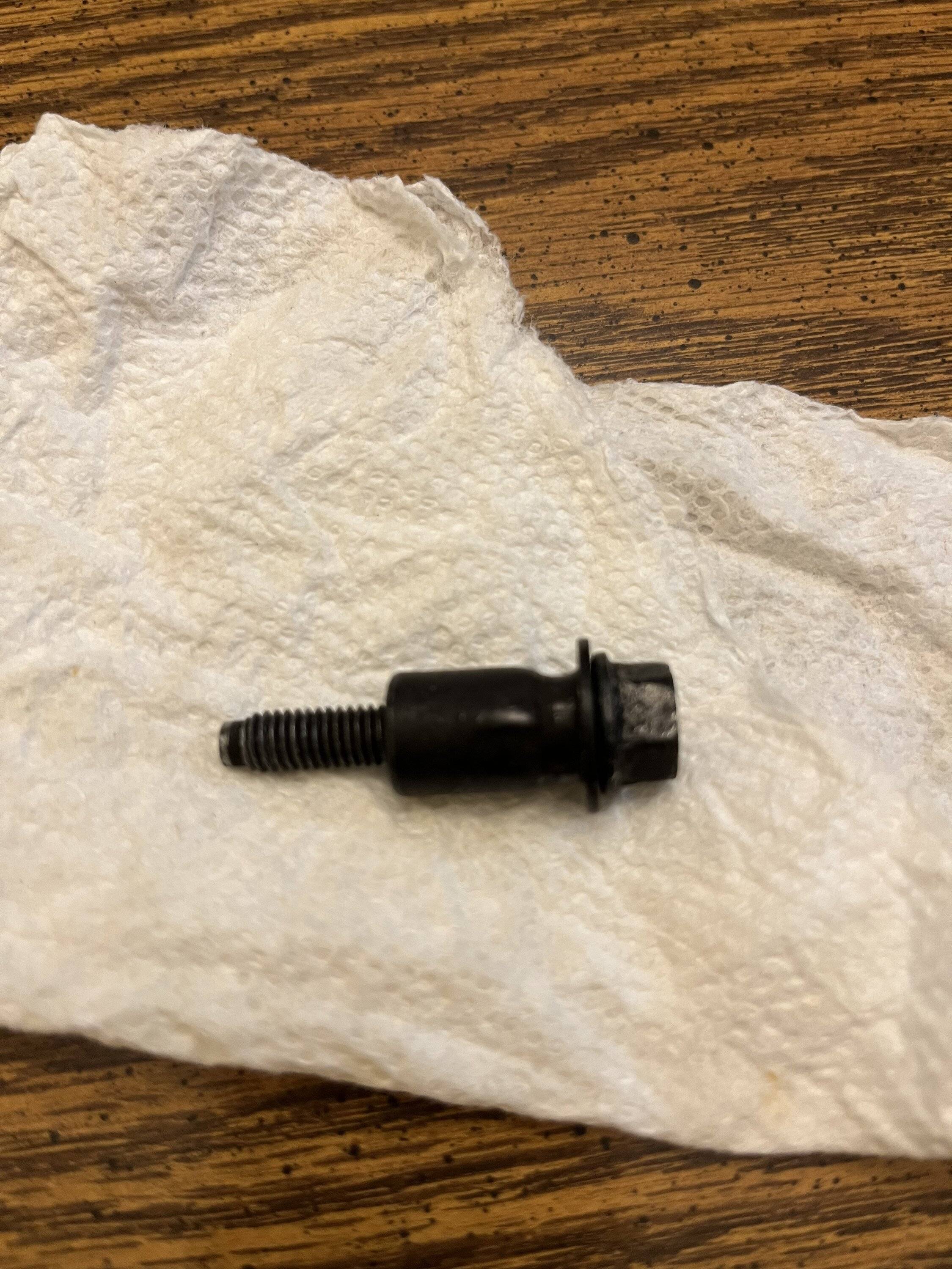

This is the OG bolt that came out of my cover. 1 pic shows the “collar” slid up to the bolt head washer. The other pic shows the “collar” slid down towards the threads as far as it goes. The “collar” stayed on the bolt as I removed it. So, yea, if this collar is still in the cover hole and all you have is a naked bolt, you’ll need to remove it.
Thanks!… I assume it just took some wrangling to get it out? The bolt came out fair easily after some pulling and wiggling.

I think a trim removal tool should be able to get the stuck collar out rather than the needle nose pliers shown in the instruction. Try lifting the collar a bit for enough clearance to get edge of tool under it and pry up. When I did mine, it was a good tug to remove it thinking why is it so hard to get out ? It’s a tight fit that collar in the cover hole.

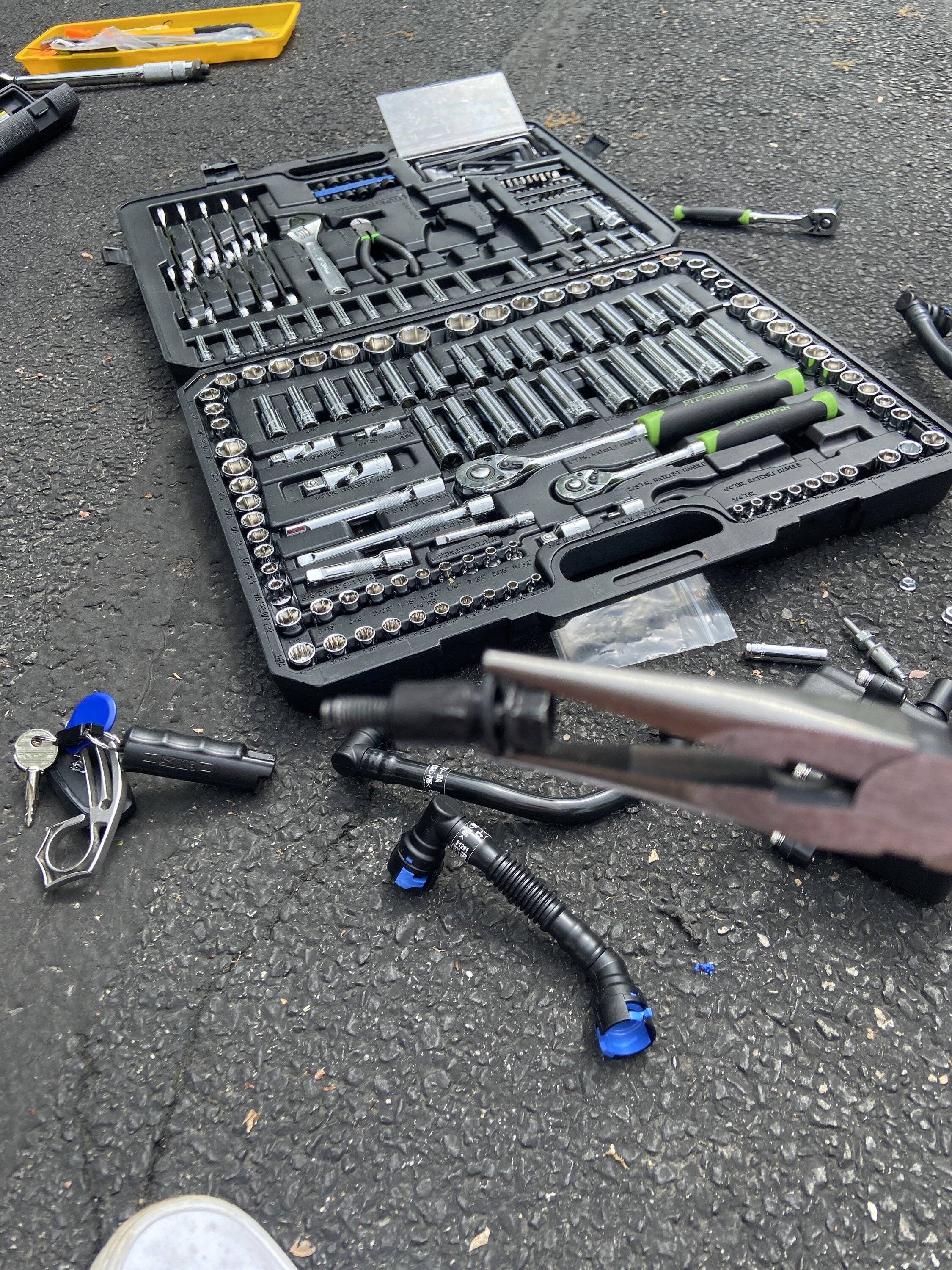

shout out to this thread, didn't know wtf I was doing wrong lol. FRPP instructions could be a little bit more specific to just use needle nose pliers and grab the whole thing like this...
