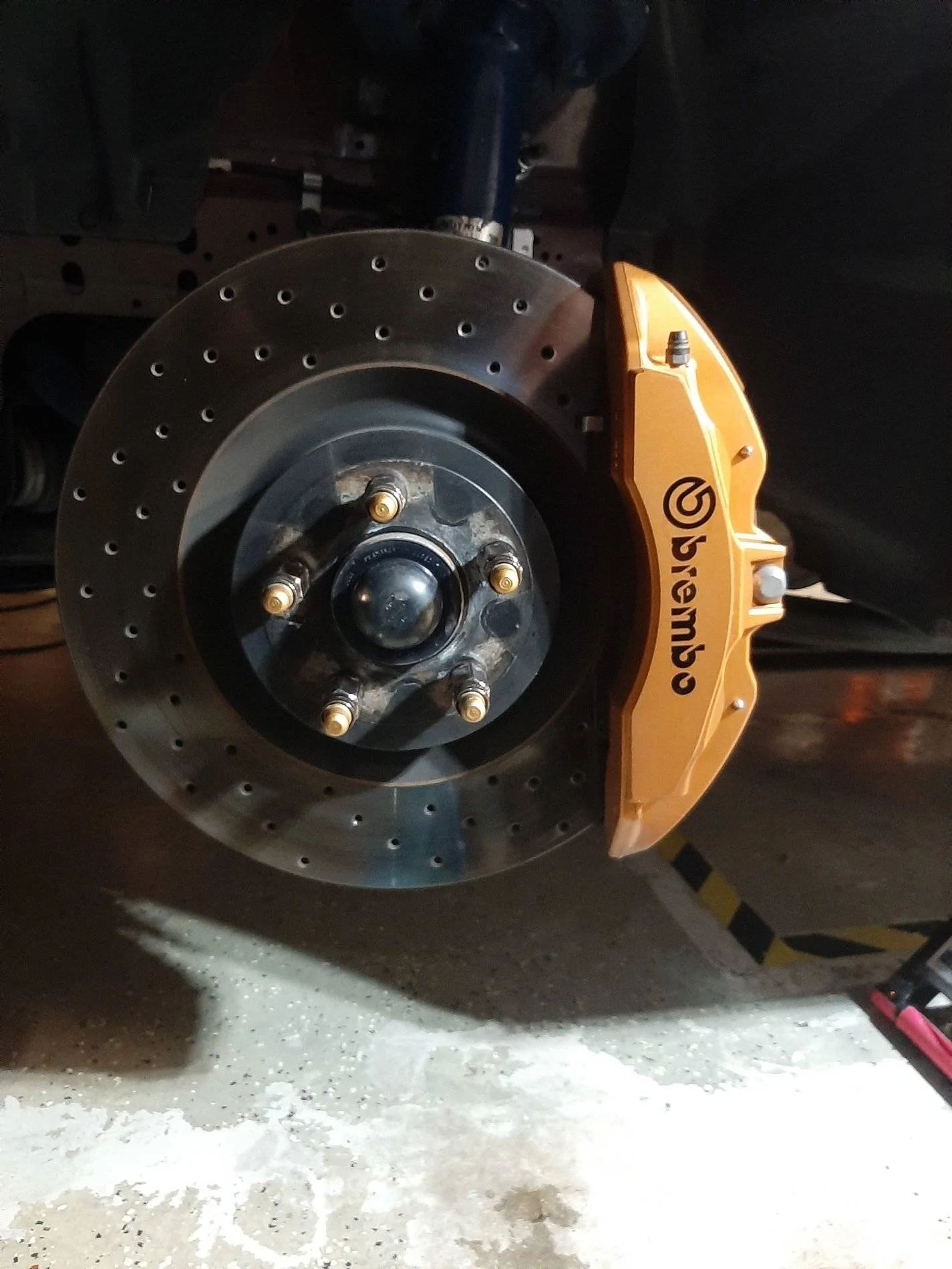

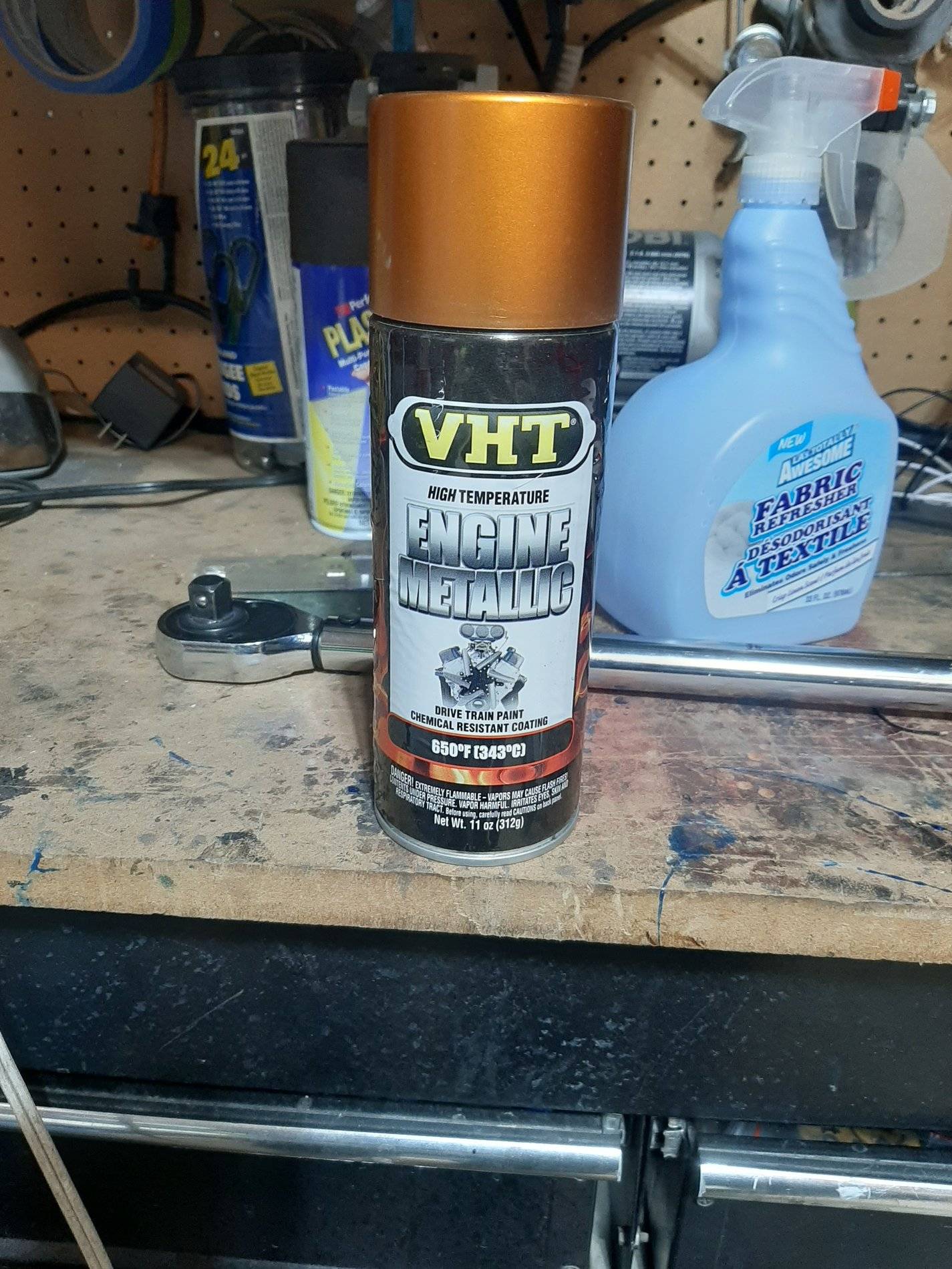

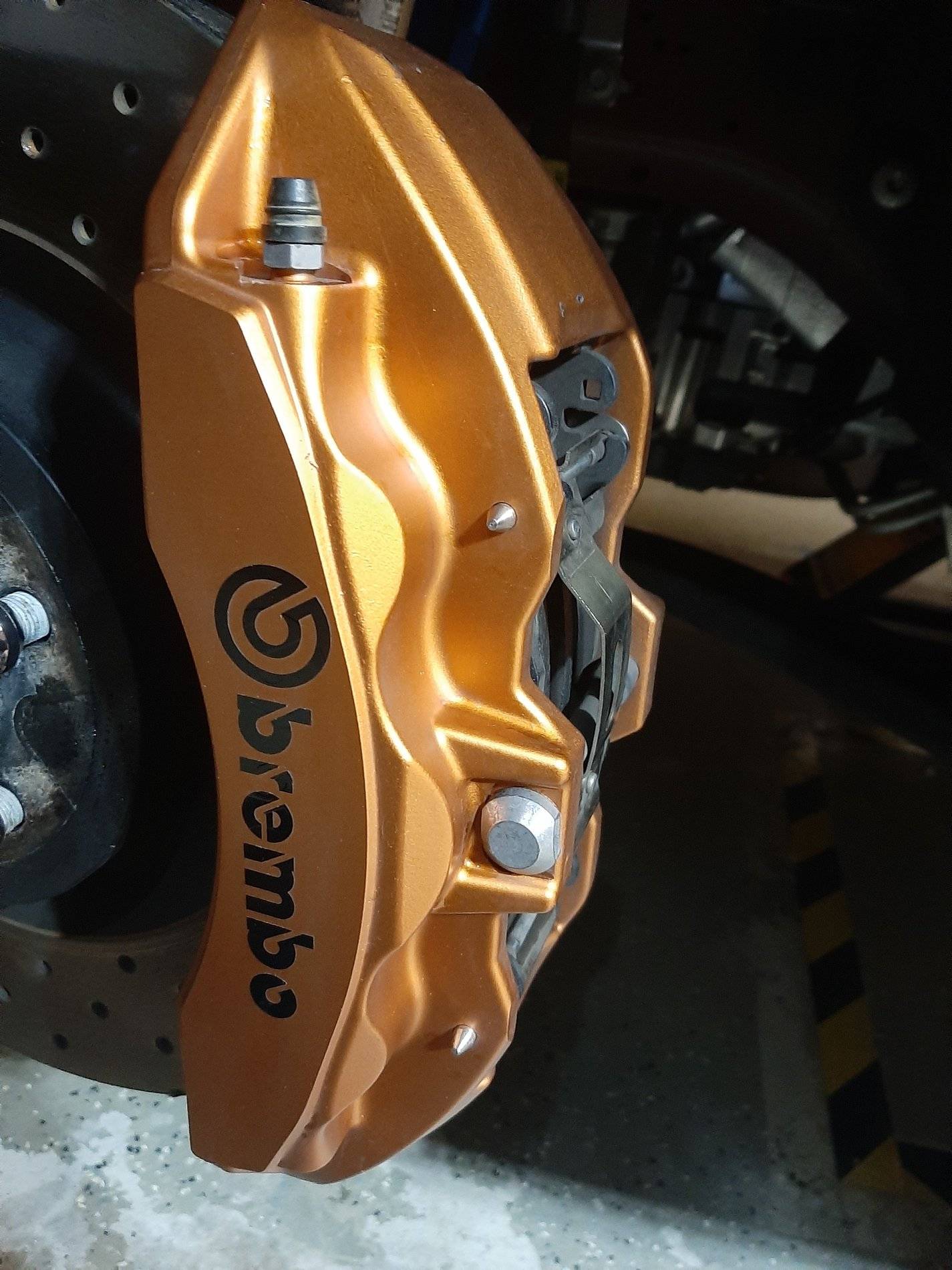

I just pulled the front wheels off to just check some things such as pad wear end link torque and stuff like that. I looked at my calipers and noticed how good they still looked after a little more then two and a half years. Back when I painted them they were done with VHT high temp engine paint both base coat and clear. The calipers were cleaned very very well with a Scotchbright pad and std dish soap. I did it completely on the car with all the hardware removed, including the rotors. Then several light coats and around three coats of clear . I did allow it to cure for at least an hour between coats. Any way I'm very pleased with the long lasting results.and yes I am very surprised. I even bought a fresh can to repaint them this weekend but I will not have too. You guys can do this job for under 30 bucks easy. Just remember the prep means the difference between long lasting and a soon to come redo.
