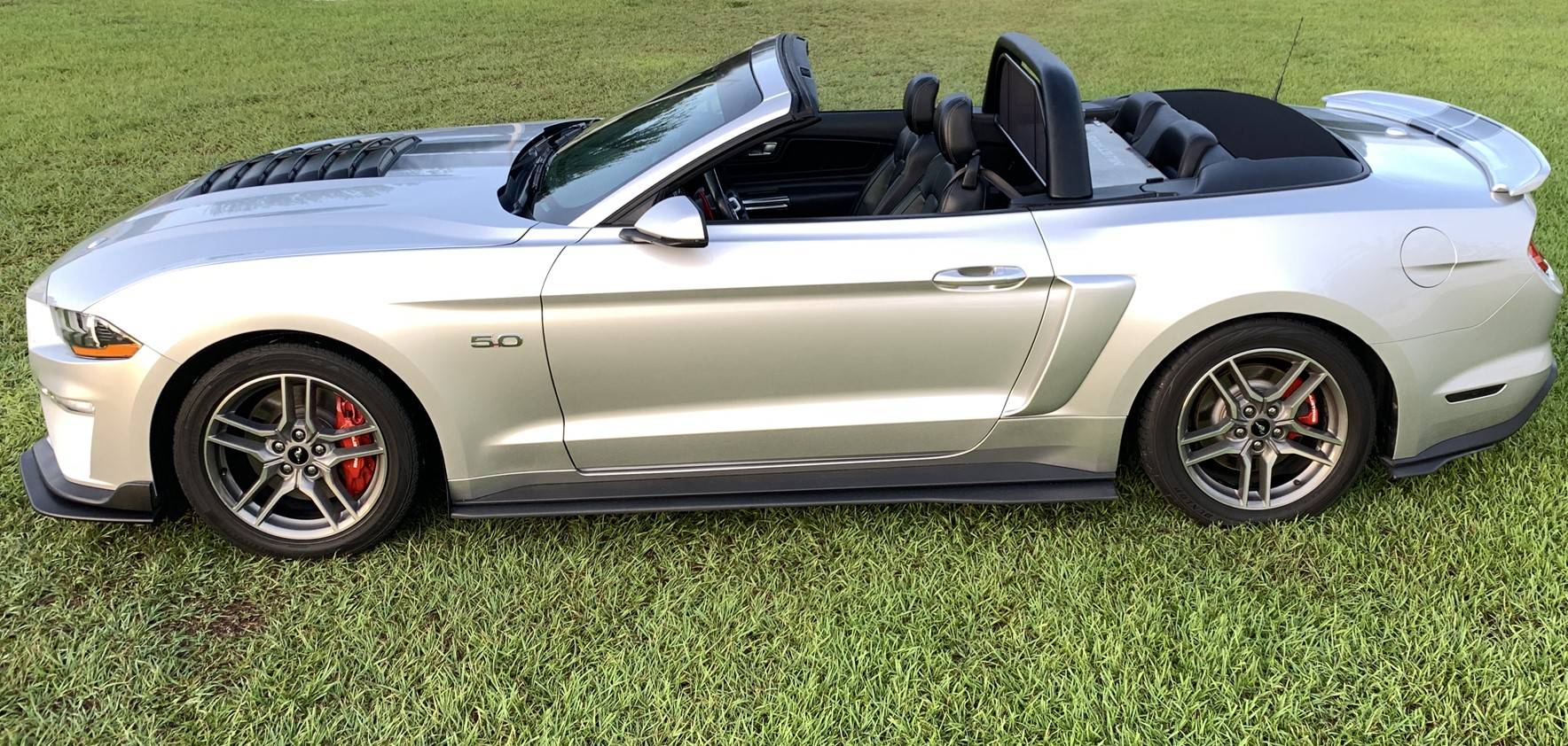

Not sure what your original paint is, but beware that some paints are not compatible to paint over with a different formula. The haze you have could be from caustic cleaners. Different paint formulations have different resistance to that of course.
I was surprised...though not negatively...that the G2 paint color shown on websites is far, far from looking like the real life color. Advertised photos illustrate a gloss, nearly purple tint that looks real rich. Not so. It is more a race red color and I would characterize the sheen as semi-gloss. See pic below for sample of what it really looks like.
If you go with G2, I suggest using a softer paint brush that gives you good application control instead of using the stiff-bristled one they supply. Make sure to pay close attention to paint application timing, as it is a 2-part that could surprise you in setting up prematurely, getting globby, especially on hot days.
Oh yes...and prep the surface well. There will be a lot of heat expansion and contraction that could lend itself to peeling/flaking. That would be no fun to deal with.

What you see on mine, though not Brembo, were painted using G2 as well.
One thing I don't like about the small rear calipers is the semi-circular cutout. In hindsight I was wondering if painting the outside of the outboard pad would have been a good option. Or....if replacing the rear pads, why not use EBC's red pads. Of course if you go with another color caliper than red, red pads sure wouldn't compliment the look very well.

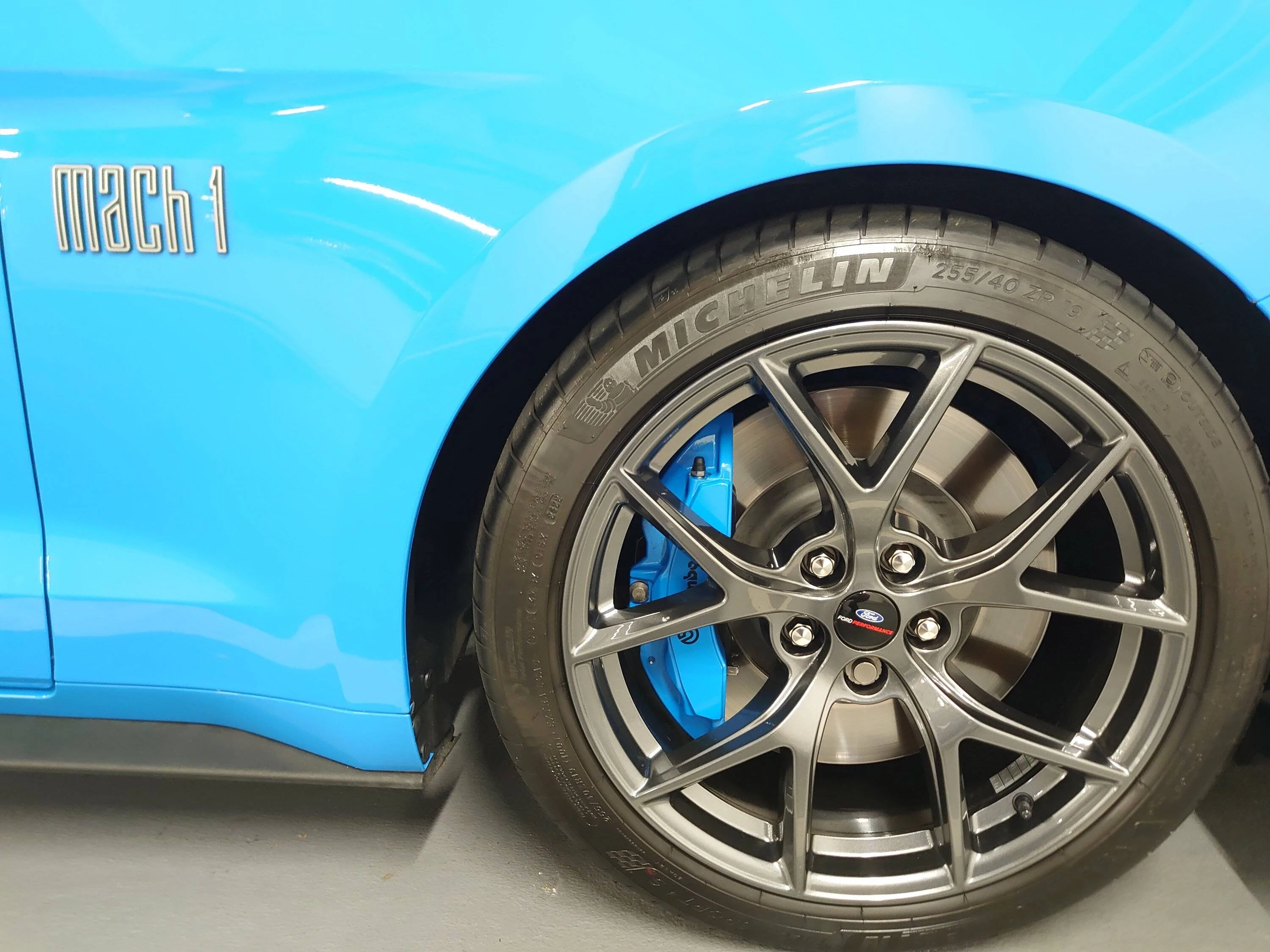

Grabber Blue đź’™ to match

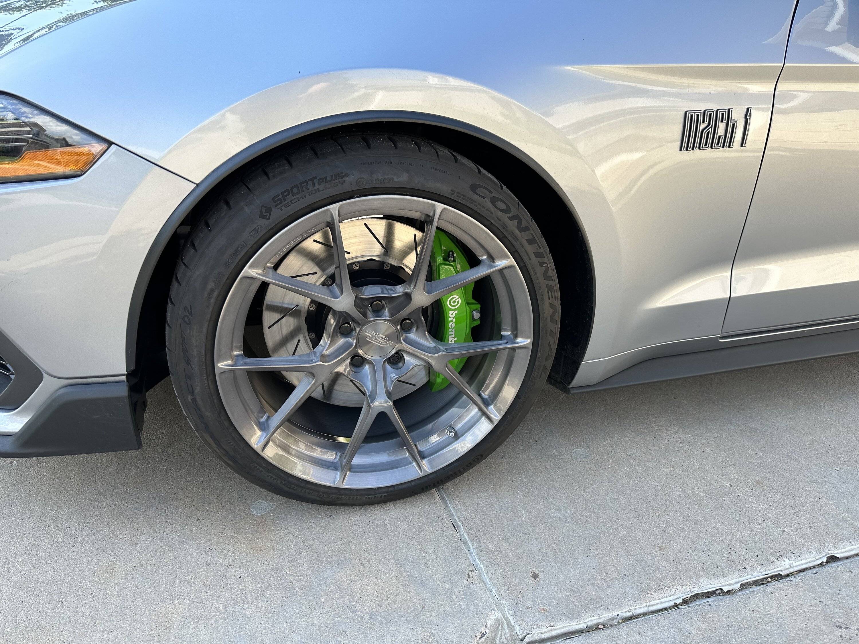

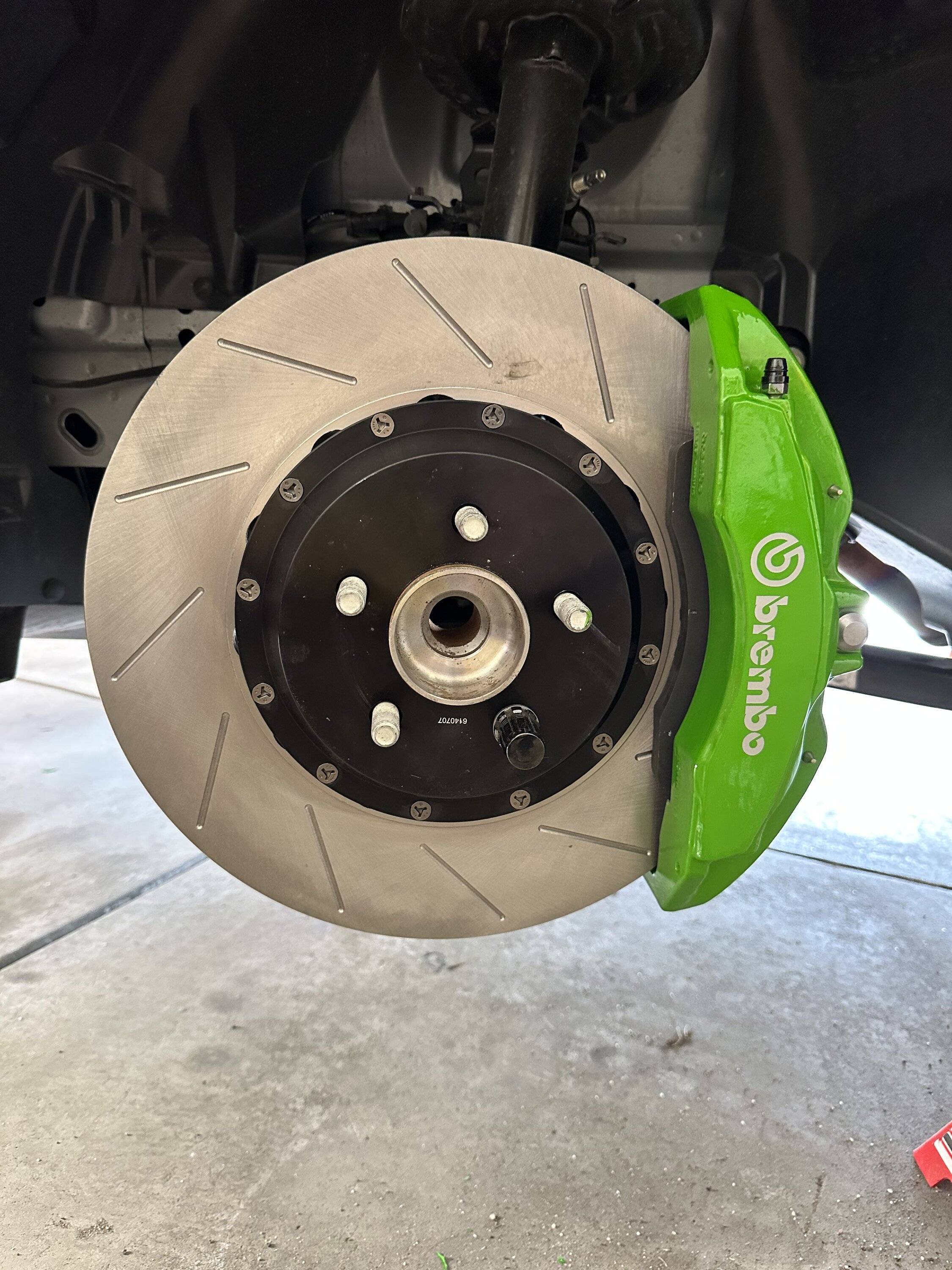

I chose the “gotta have it green” and did silver Brembo decals to match my car. I applied several coats of VHT clear over the decals to make sure it stayed in place

Which brake rotors are those? Really nice looking.

Thanks. They are the Kenny Brown (Baer) rotors
Did you notice much difference versus the standard rotors on the Mach 1? Regardless, they look cool.

In combination with the lighter forged wheels, I definately noticed a difference. Turn in, steering feel and braking all were improved.
