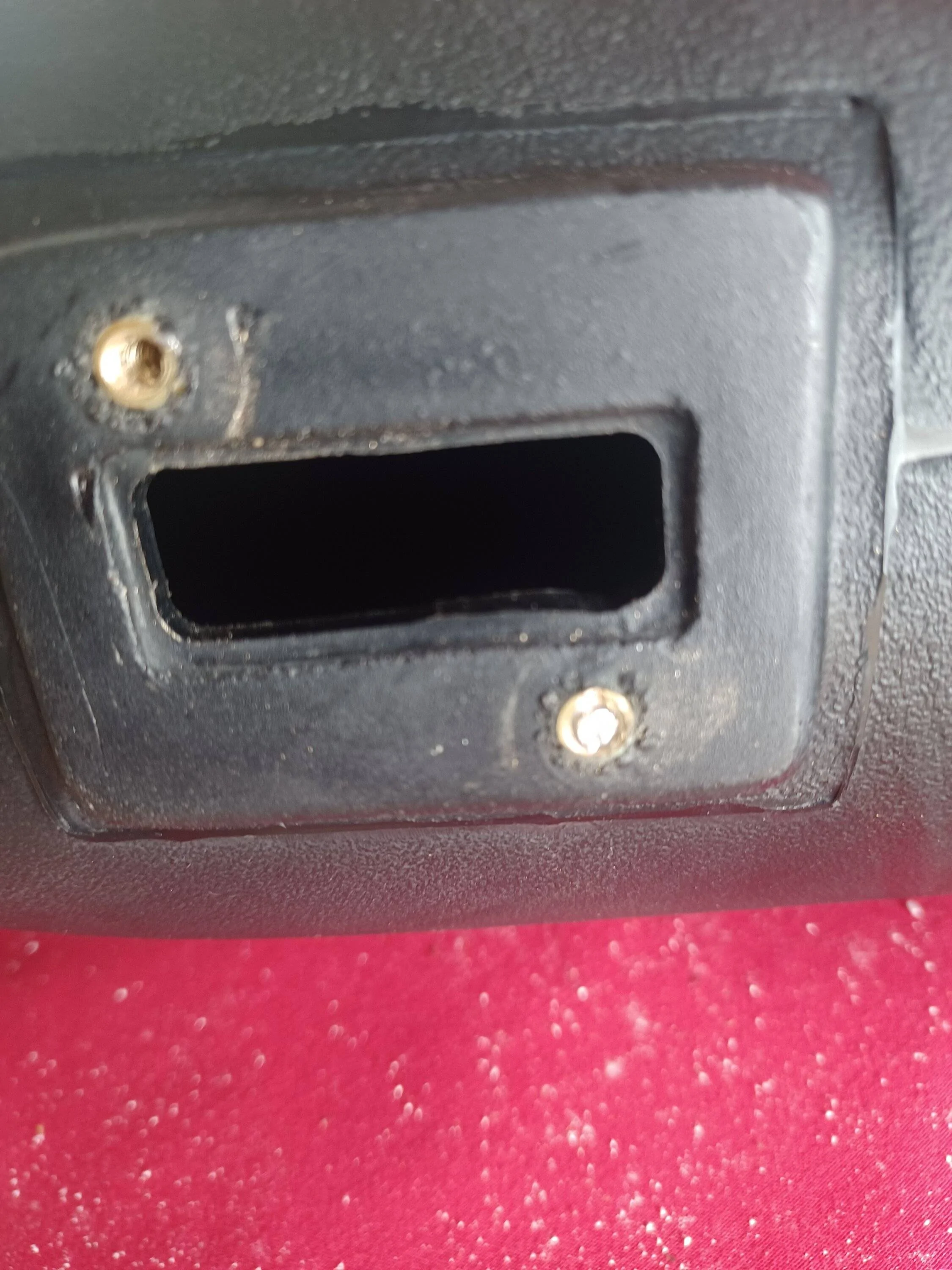

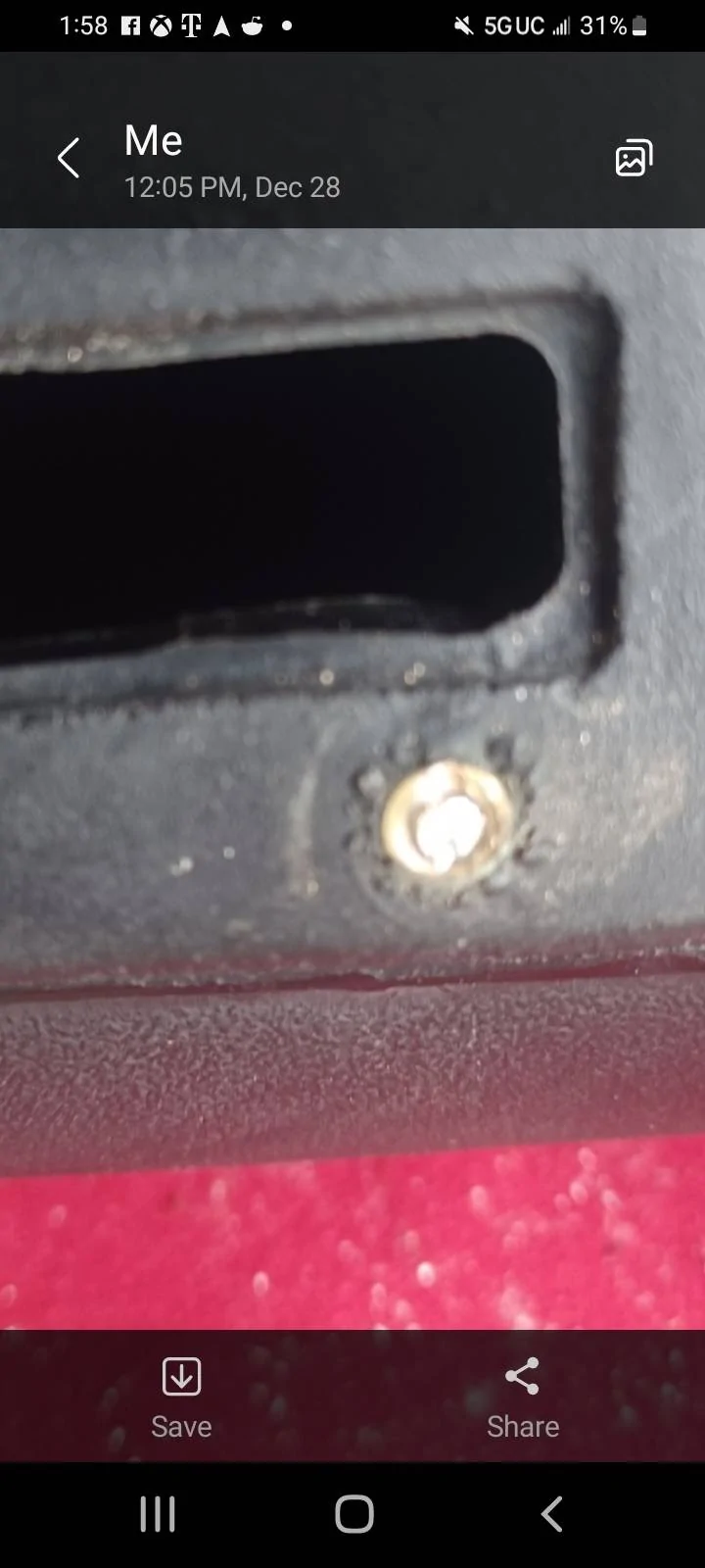

Broke a screw and need to extract it what's the best way to go about it

It's from where you mount the maf on a jlt intake. I think I need something smaller like what they use for computer and phone screws

Does it protrude on the inside? If so get some pliers on it and turn it.
otherwise, if you have a dremmel, and a thin enough cutting wheel, you can cut a slot and turn it with a flathead.
or go buy screw extractors. I have a feeling you might need them again sometime. ;)

Thanks I have a Dremel ill try your suggestions

Center punch the hell out out of it and use a left handed drill bit. It will probably unscrew itself quickly like that.

Speed-Out, sold at HD and elsewhere, double-ended a set of (4?) in a black plastic case, I removed a tiny antenna screw ( broken threaded end ) successfully, may be worth a look.
