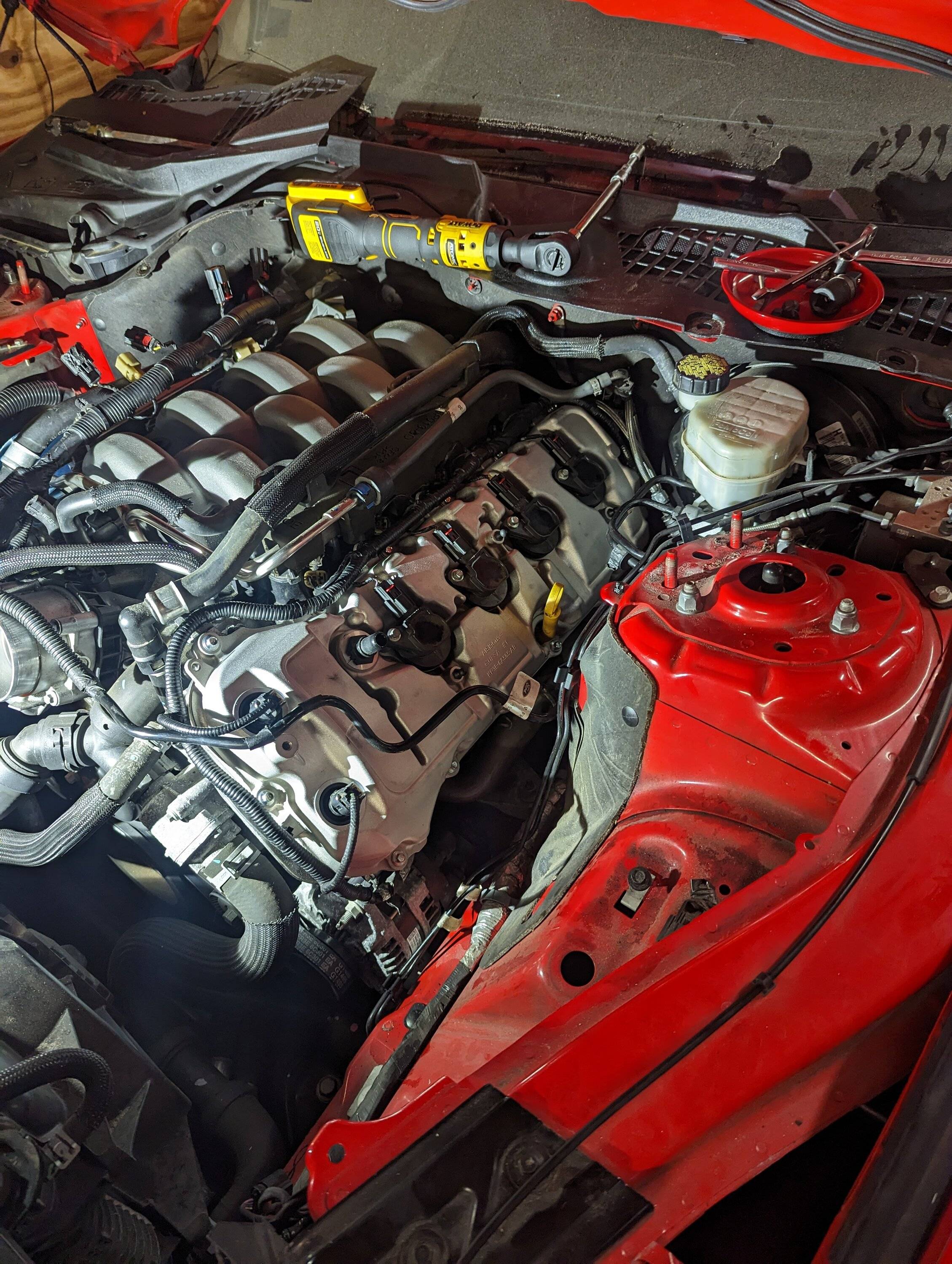

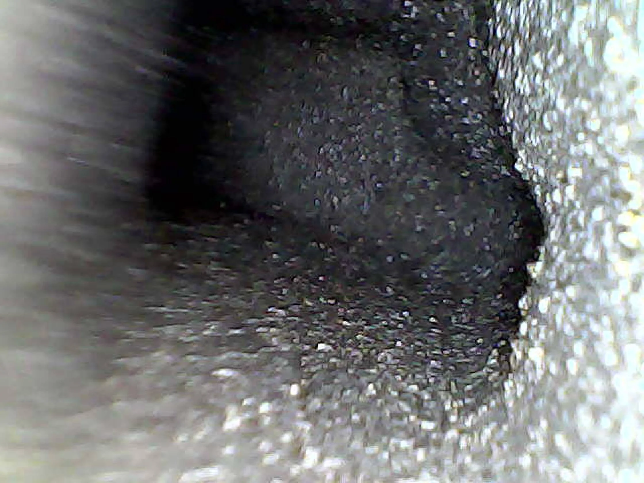

Well, I ordered the Klein Tools USB-C borescope, and it arrived today. I stuck it as far down into the oil drain back passage, and saw zero evidence of the dipstick tube having fallen down there. Given how stiff it is, I'm almost certain it would have gotten stuck where the turn is at the bottom of the passage and been sitting there.
Anyway, she's going back together. I got the driver's side valve cover back on, and all the coil packs reinstalled. It's almost impossible to torque the bottom bolt at the back of the engine, but I was able to use a hex attachment for a socket and approximate torque based on the other valve cover bolts.​
I thought I would need to use the GT350 dipstick tube, but I used the stock GT tube, and it worked fine. The other cover will go back on tomorrow. Motorcraft TA-31 RTV used for the sealing points at the front of the cylinder head, if anyone was wondering.​
