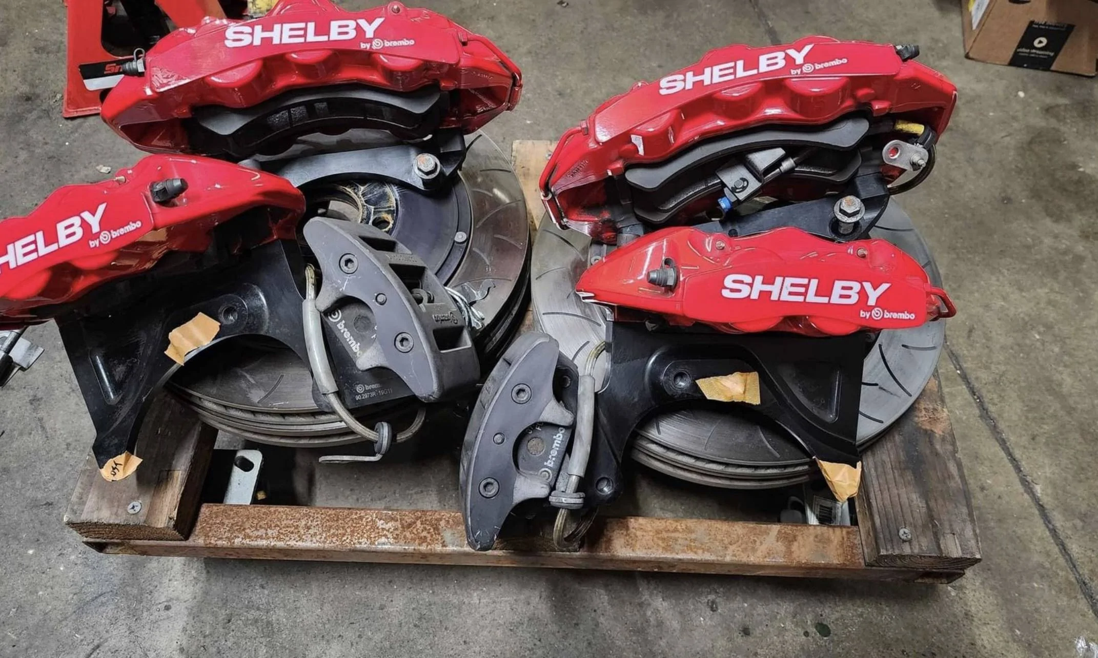

Hey guys, I got an offer for the front and rear Brembo brakes from a Super Snake. New from Shelby they’re over $8K, I can buy the set for $2,900 with about 15K miles on the setup.
Shelby Front Brakes
Shelby Rear Brakes
Does anyone have any experience with this brake setup? Is it worth the cost? I’m currently running the base 4 Piston setup and just ordered the red Bullitt Brembo front brakes for $600, but I’m aiming to swap in a GT500 engine and DCT(along with all the wiring etc) at some point in the future after all the handling and frame reinforcement is complete. I’m wondering if these would out perform a OEM GT500 brake setup.
Probably not, but they are still a good upgrade over your base brakes and that's a decent price for what you get.
However it still all seems way overkill especially compared to a more budget option that you already mentioned (Bullitt or GT350 brakes).
Unless you're a hardcore road racer and are looking to shave the last few tenths per lap I think these are kinda pointless.

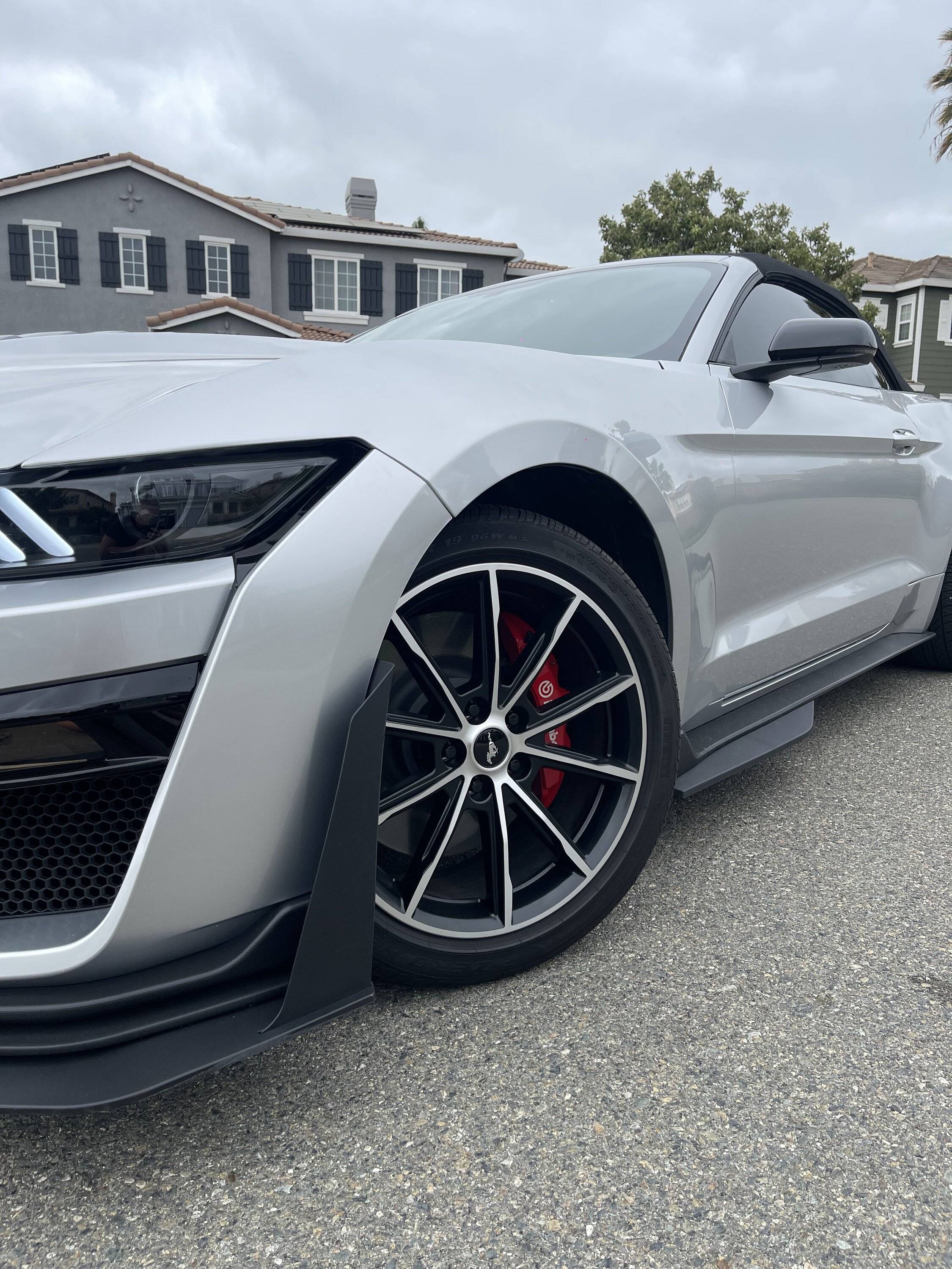

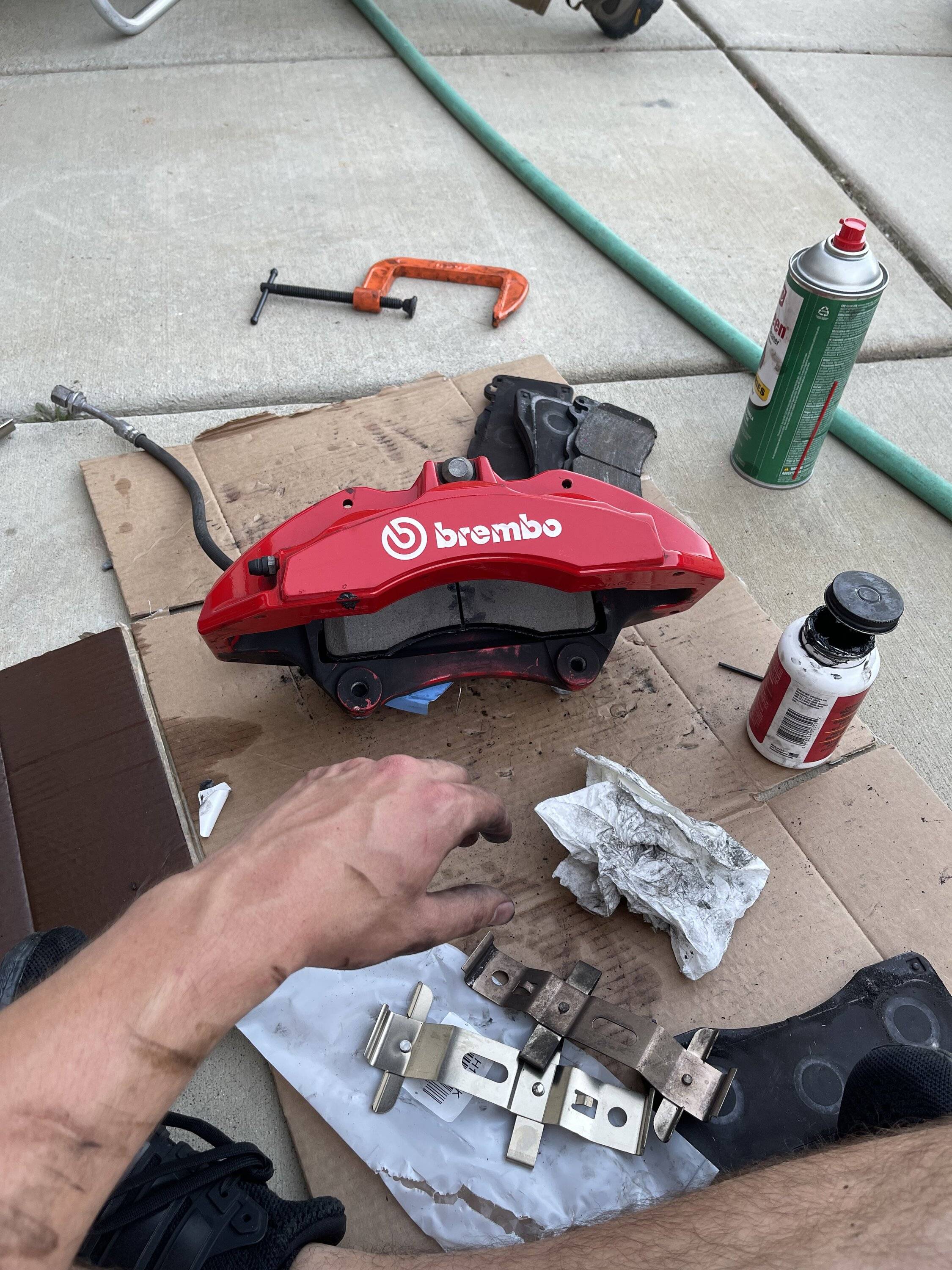

Hey, thank you for all the replies! You’ve all got some really great points that helped.
I’ve decided to go the Bullitt 6-Piston setup instead, already had new OEM rotors and got some new StopTech Z26 pads. Cost about $700 when all done and made a huge difference.
I wasn’t sure if it’d be some major difference in performance with the Shelby setup, but in comparison to the rest of the car it’s overkill. When I looked more into the Shelby setup it looks like the fronts are the same size as the GT PP/Bullitt setup (15” 6-Piston) and the pads alone are about $900 for a full set. I don’t track it at all and I want the added safety of stopping faster as I’ve had several situations/close calls with bad drivers where the added stopping power has saved me, plus it’s an excuse to have Brembo’s ha ha 😂
The wheels would be one of my next upgrades, would like an OEM GT500 setup to match the rest of the car, but I’ve never had 20” wheels and don’t know if the extra inch would mess up ride quality as it’s a daily driver.
One issue I did run into with install was the shields, I thought I had the small GT PP shields and didn’t. So I reused the larger 4-Piston shields as they fit just fine and I’d assume are better for daily driving protection than the super small PP shields as I don’t track it and oddly my fender liners don’t have any airflow tunnels for the brakes either.
