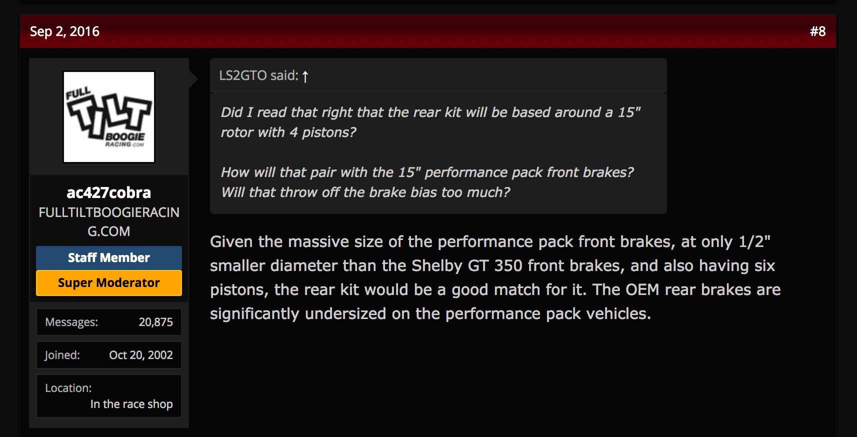

Oh heyyo, that's me that FTB replied to...completely forgot about my account on SVTP.
I'm also curious as to the improvements of the rear GT350 brakes over the stock GT ones. It better be something significant for the 2k price tag.
Sorry they were comparing the fronts of the PP to GT350 rotors as a means to justify the rear change... I absolutely hear what you are saying though!
