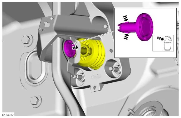

Car removed for clarity
  1. NOTE: The booster push rod clevis-locking pin is a one-time use only part. Any time the booster push rod clevis-locking pin is removed, a new booster push rod clevis-locking pin should be used.
    Remove and discard the booster push rod clevis-locking pin and position aside the booster push rod.

Here ya go, different application, BUT most likely the same pin design or part - does this help any?
https://www.svtperformance.com/threads/brake-booster-clevis-pin.1140320/
EDIT:
@fmc_smt - LMAO - we must have been responding at same time, same thoughts!! The thread I provided has some close up pics of actual pin, it IS the same seen in your supplied diagrams.
EDIT 2:
The PIN is actually 2 parts as seen in the images.
If you have a pick or something with a very pointy end, insert it under the “head” (male pin part that is inserted into the larger female body) - pry up on the head to remove that pin (male). Once that is removed, it will allow compression of the remaining part (body).
These type of push pins are similar to what holds on the front inner wheel splash shields (2-part black pin, removal is same by popping head out first then removing body).

The male part is actually metal and is a pia to get out .

Yes it is, because the pedal bracket is 1/8 inch from the end. And the pedal is concave in nature where the pin exits the pedal which that diagram shows the easy opposite side.
