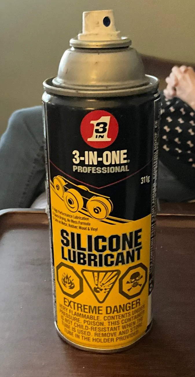

Sounds like have some grit in the seals.
Clean the window seals inside door top and side seals with alcohol on a cloth wrapped on a flat edge of some some sort so can get in there.
See it that stops it. Then use spray silicon and put on cloth to get in the seals.

You might try putting some silicone grease on the rubber temporarily to see if the noise goes away. Dont use lithium as it is not recommended on rubber
