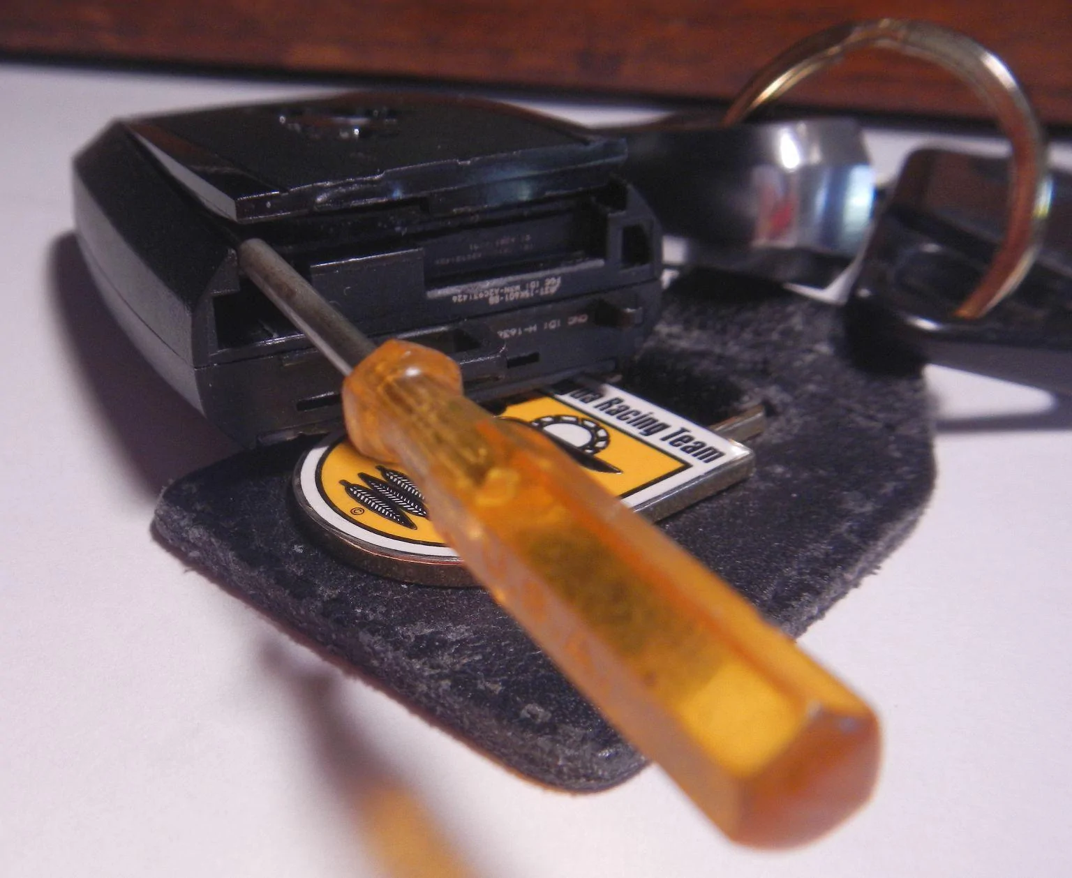

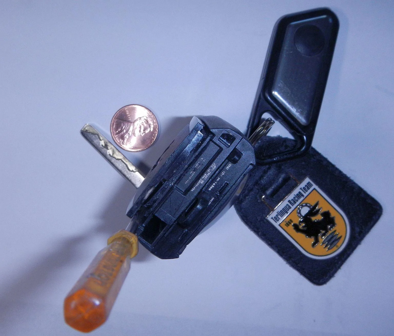

Short version: Fob's coin-cell cover won't come off. Couldn't replace the cell if I needed to.
A littler more searching led to THIS Page, where it indicates one must apply more than a thin coin to one slot; thin screwdriver to a couple more slots. For the 2018 and 2819 cars the battery/cell is CR2450, if I got it right.
I really prefer against getting involved in this kind of dead-horse beating, but some of the splatter might save someone else some frustration and effort.
Attached pictures show a bit more of the "thin-screwdriver" operation. In the 2018 video the operator experiences a little difficulty popping off the cover, and mentions a couple of slots in the fob base that I can't find. The Very Small screwdriver in my photos is inserted in the only place that accomplishes "pop-off": one of the ramps the cover rests on, both of which can be used to leverage the cover free. You can likely see the slot that a thin coin fits to gain access to the ramps.
For the first year I could lean into the driver area with the fob in my left front pants pocket, and the car found it and ignition would respond as expected. Just after the start of its second year, the car would tell me it couldn't find a key, and I'd have to either get in the driver seat or take out the fob and wave it around inside the car.
I looked in the Owners' Manual and found the instructions for replacing the fob battery. Figured I'd look at what was inside there so I could have a replacement coin cell on hand for eventual failure. Following the manual's instructions, I used a thin coin to twist in the designated slot to open the fob. The slot end of the battery cover popped up, but the cover itself remains firmly attached. I tried tipping, sliding and pulling and twisting, but the cover won't come off. I hesitate to apply any more pressure.
Is there some secret sequence of pushes, pulls, and twists that will release the fob cell cover? Does my Ford dealer have a special tool to allow access to the coin cell?
