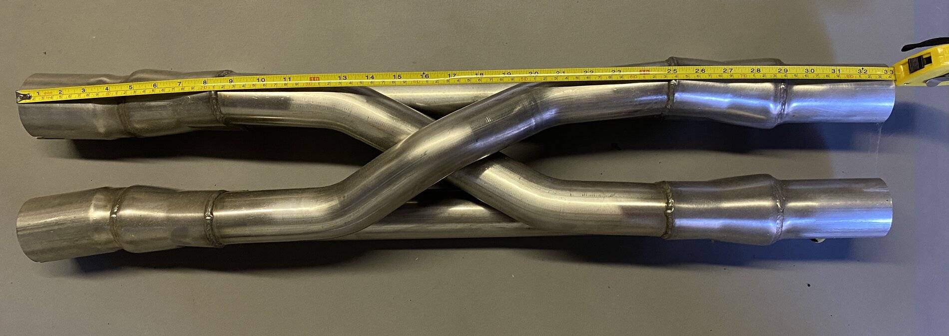

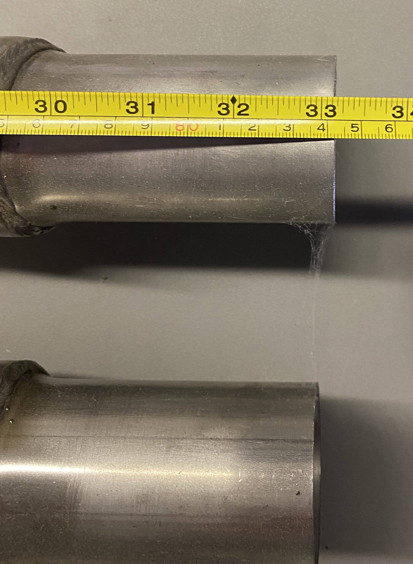

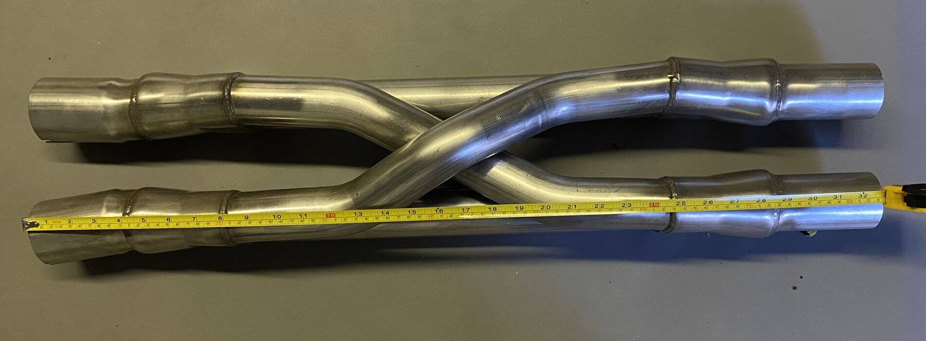

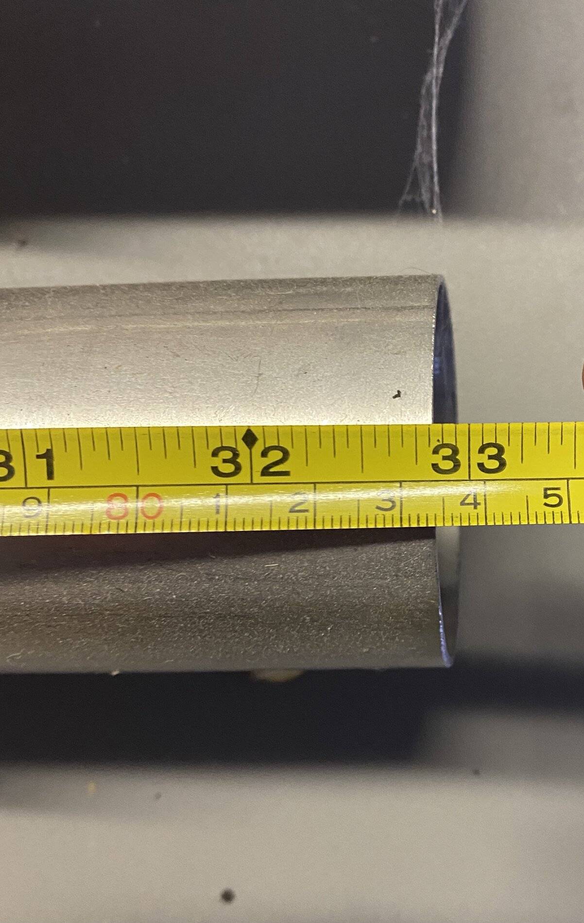

Don’t think you would have any issues you’ve got plenty of wiggle room on each side of the switchfire to make it fit.
pipes into the switchfire can be pulled out slightly.
equally the same with the muffler end. Surely you can pull or push the mufflers slightly to compensate, they’re only on hangers that have a bit of play too?.
Am I correct ?

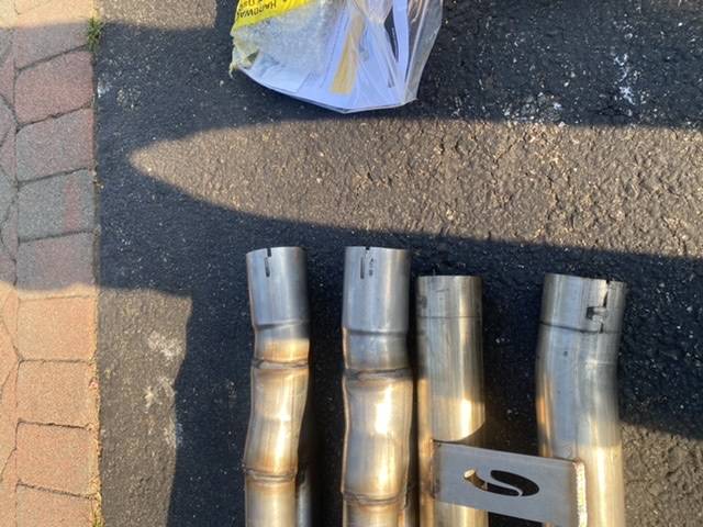

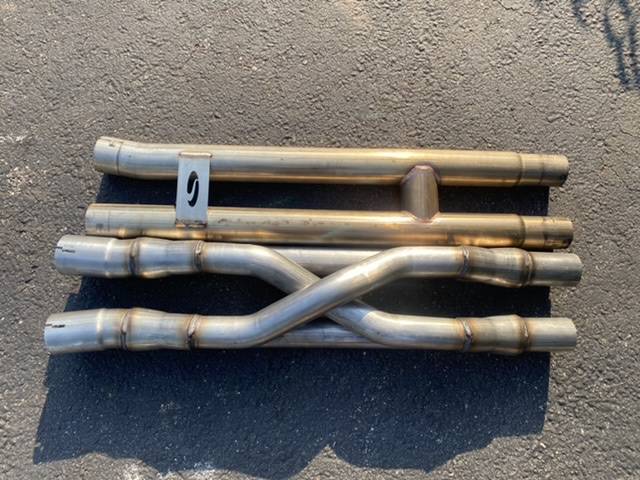

The switchfire fits perfectly if you have already done a resonator delete with a steeda H pipe. Just be sure to push the mufflers a bit to not let the valve cables touch the chassis or you’ll get blown fuses.
Ps the switchfire is amazing
