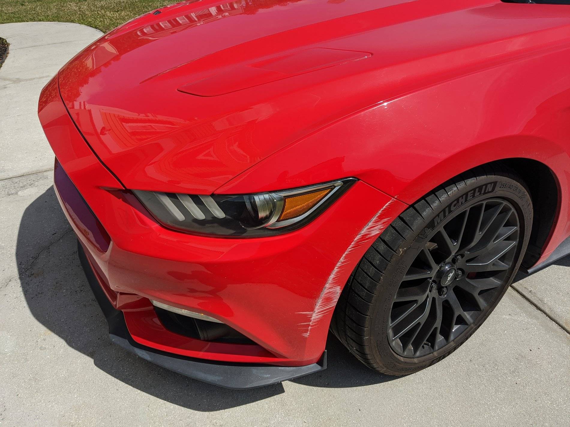

I was pulling out of my garage earlier, and not paying as much attention as I should have, and this was the result...
The bumper may need to be replaced, though the scratches aren't deep, they just went through the color and clear. The fender likely just needs a respray on the wheel arch, as there's no damage to the metal itself.

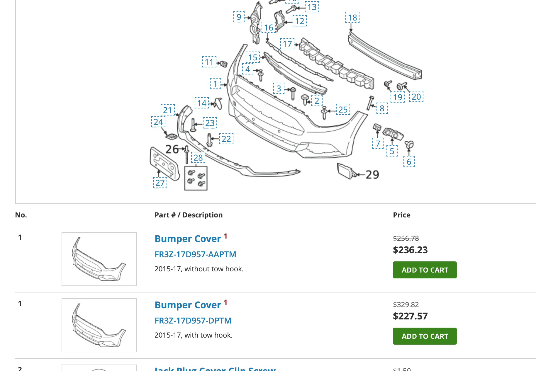

Has anyone bought a replacement bumper from AutoNation White Bear Lake or Levittown Ford? They both charge a $75 core charge. Any idea how they plan to collect the core? Also, there are two different bumpers listed, one with a tow hook and one without. I don't have a tow hook on my vehicle, have have never seen one with a tow hook. Any idea which is the correct part?

Cant answer your question but any decent body shop will be able to repair that bumper.

That part is flexible plastic, from your picture it looks like a lot of transfer from door jam. Have you tried using a polishing compound/scratch remover to see how bad the real paint is

That is a $500 or under repair. You don't need a new bumper, unless you bent something that can not be seen in the pic. Have you checked with a body shop?

Looks like it slightly rubbed the metal of the upper fender, but that can be touched up when they blend it. Get it repaired man, looks like a scrape. You might have lost a little material on the edge so without any filler it won't look factory-new, but once they clean it up and paint over it, you shouldn't notice a difference unless you really stare at it.

If they ship you a new one you will have to ship them back core or forfeit the $75.00.., if you replace it it would be better to get it from your local dealer residential freight will cost too much the dealer gets s discount.

you don’t need a replacement ..any body shop can fix that in less then 2 days down time. The damage doesn’t warrant a replacement.

Thanks all. I went to a body shop on Friday afternoon, and they quoted me $950 to remove, repair, and paint the bumper and fender. I spoke with a guy I know that runs a pretty well known race/performance shop in Charleston, European Road and Racing (the owner is a former Porsche factory driver), and he's going to repair it for about $600 with his personal body shop guy. Plus, I get to see his F1 car and various other shop projects.

Looks like it went through the base coat on the edge. Compound and polish wouldnt fix this. You need a respray.
