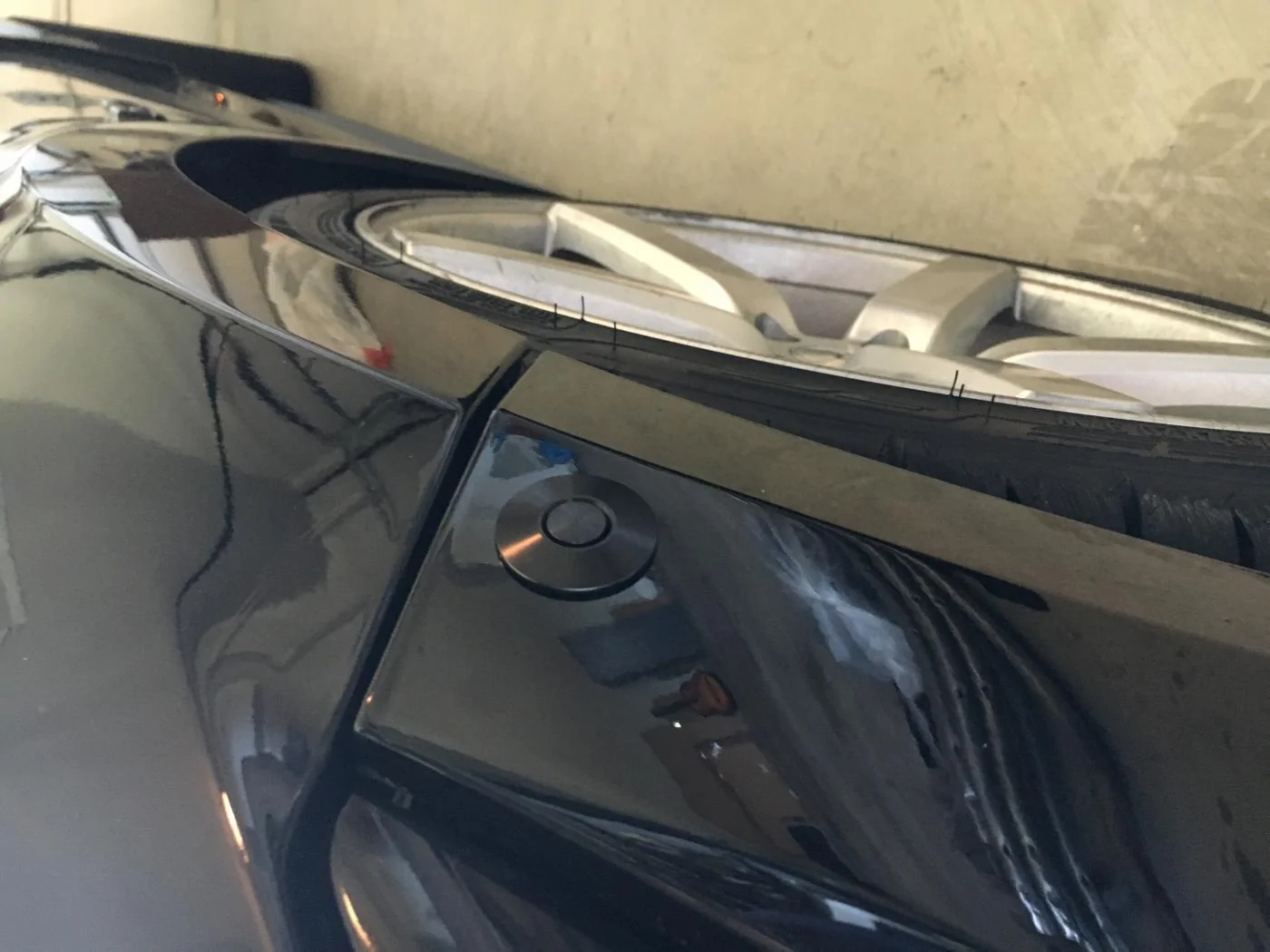

MyLilPony
Naw It's Stock
Apr 15, 2015
1,613
657
Prosper, TX
Kris
2015 Black GT, 18 JLUR, 15 JK
The clips on the bumper cover suck....both sides of mine are broken.. solution is below, quik latch...
