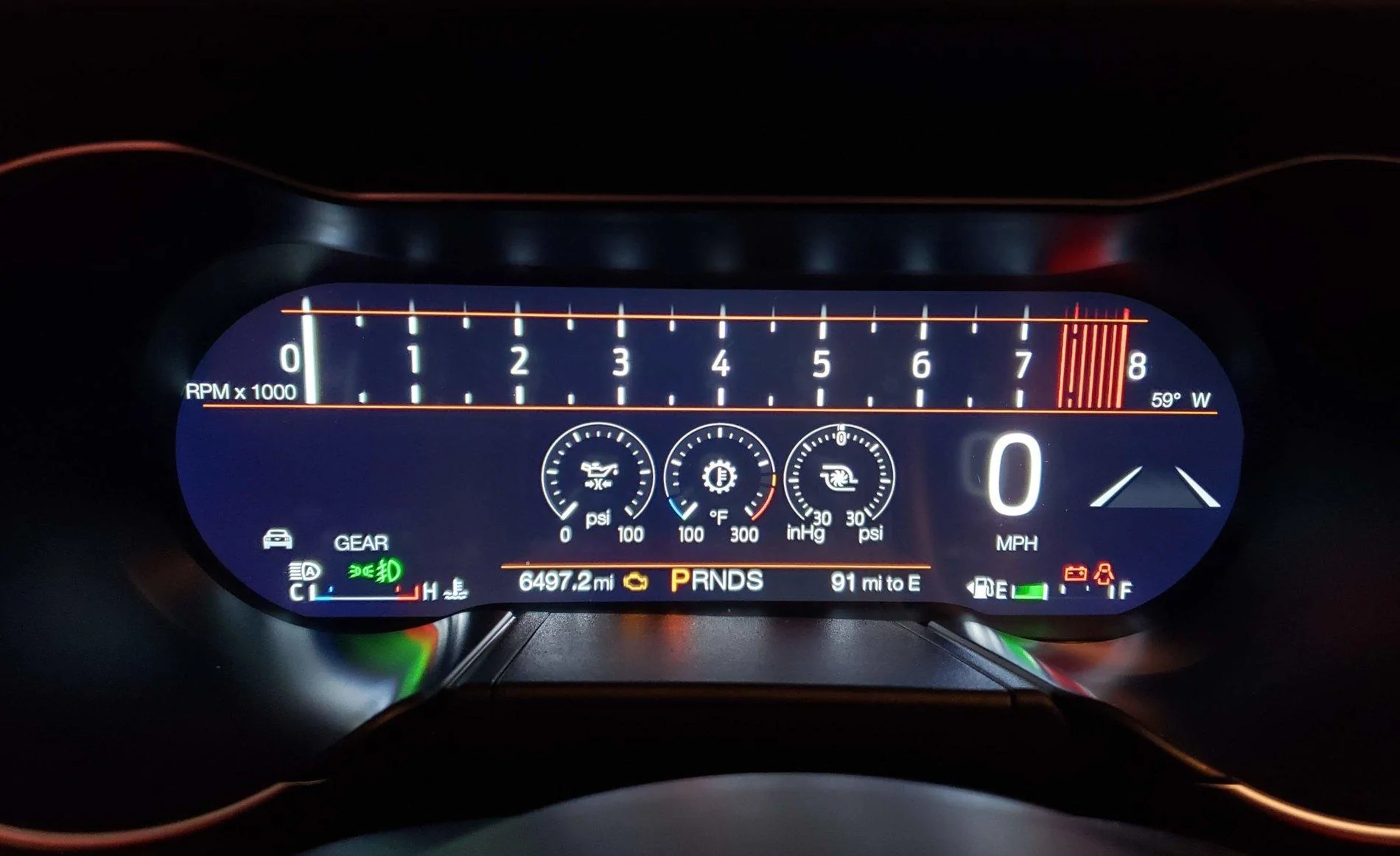

I know its an old thread, but does the xx7F- work for both the digital and analog with the digital display in the center or is it a different value for the digital? Every video I have seen on it shows the
Maybe be old news but finally got around to using Forscan to replace the Vac gauge with the Ecoboost Vac/Boost gauge. Great mod for post boost install.
Rob
I know its an old thread, but does the xx7F- work for both the digital and analog with the digital display in the center or is it a different value for the digital? Every video I have seen on it shows the 300-400a dash, not the 401a?This is the first time I have seen it on the 401a dash...and beautiful car :)

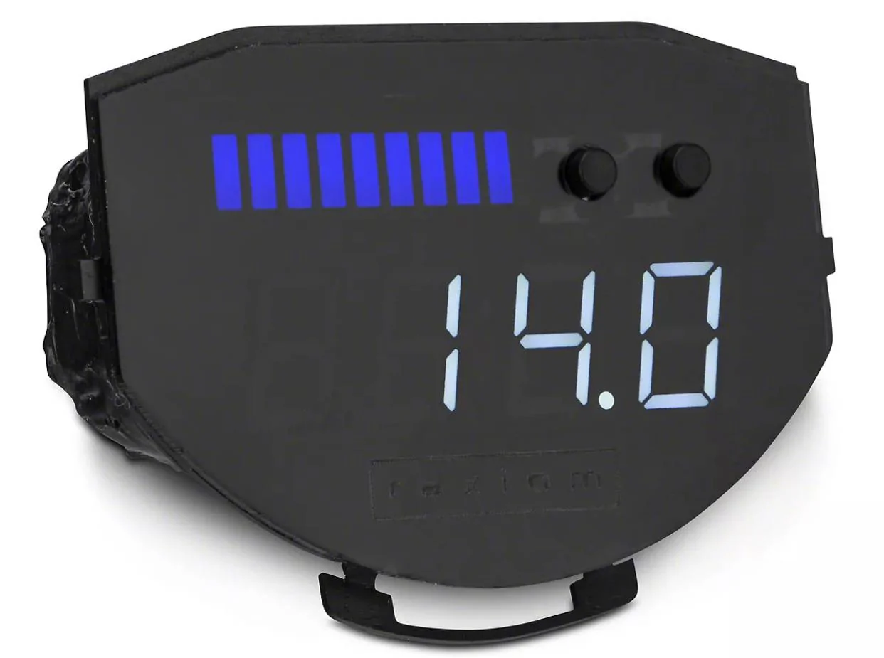

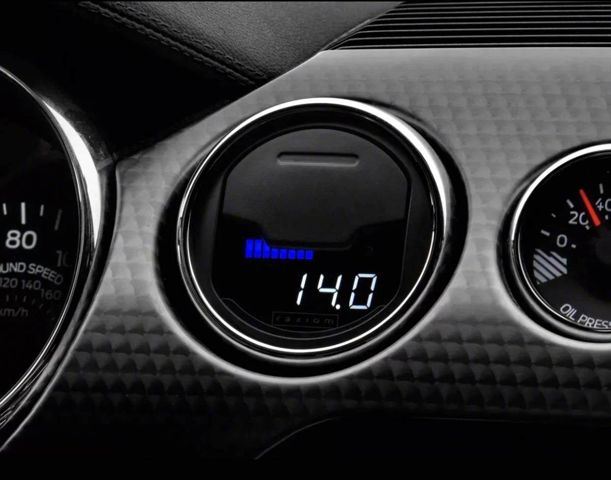

Have the same question for my 19 GT, as I am adding a Whipple and was going to get the Raxiom Vent Integrated Boost Gauge.
But if I already can do this mod, it will save me $$$.

It goes for about $280 online but if a simple forscan flash Will work on the led cluster than I will leave it on the wishlist.

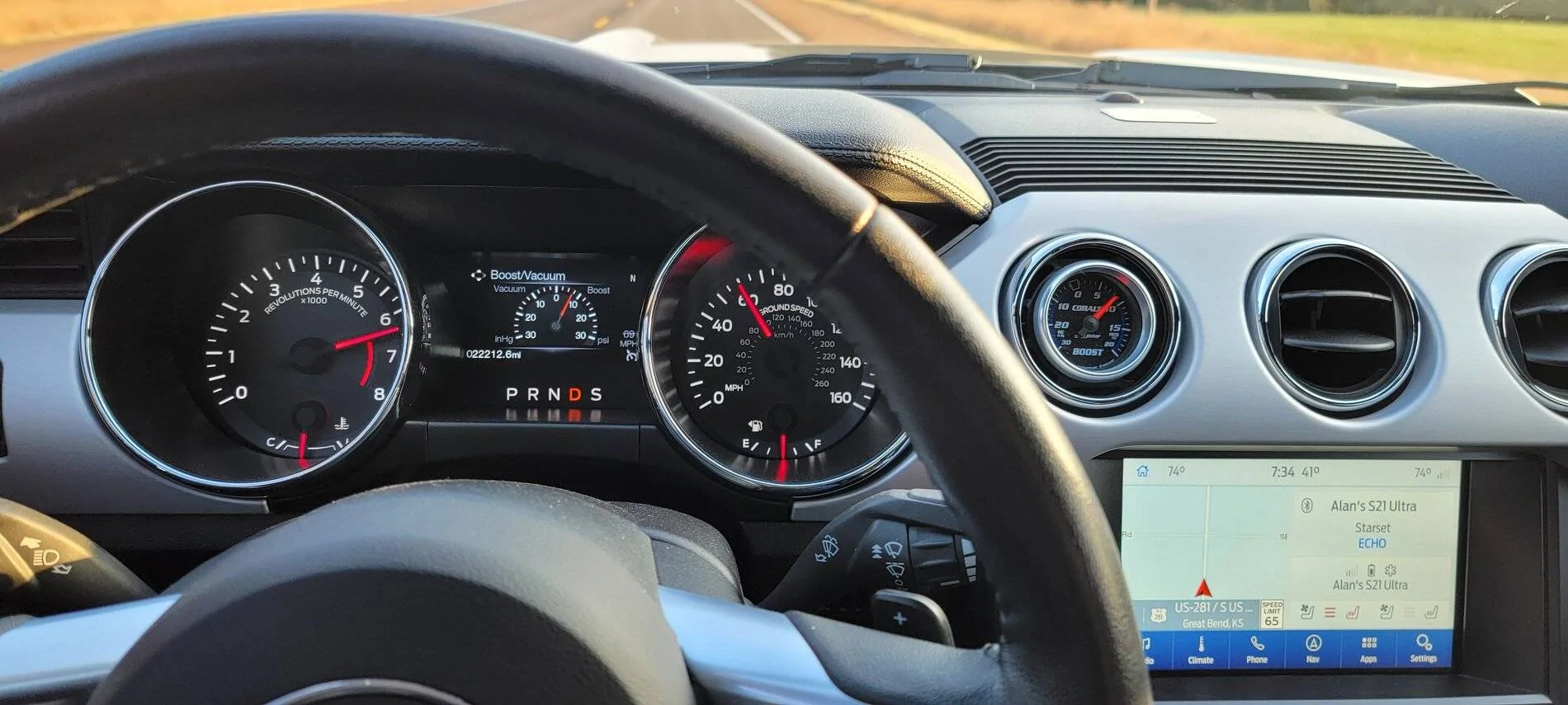

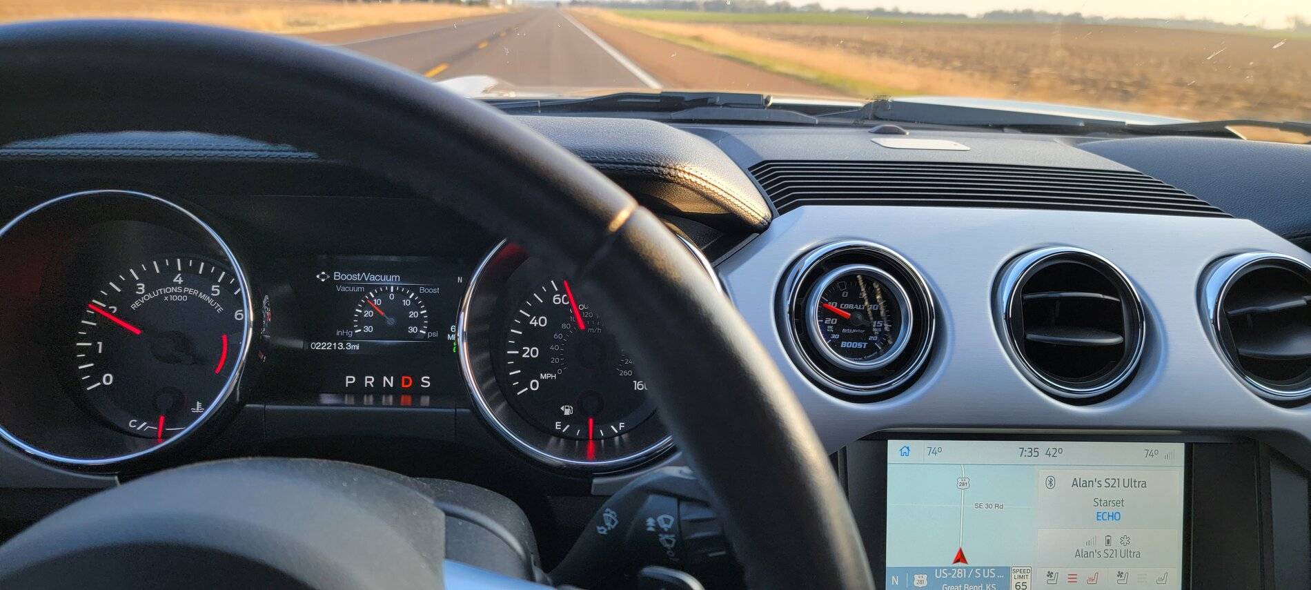

Mine's completely accurate (pics are hi-res, click to enlarge):
2017 MY here/Whipple tune. Autometer gauge on the right is mechanical boost/vacuum, attached directly to the intake manifold port, so it's legit. Agrees with the digital one.
How did you get the gauge in the duct?? That looks awesome dude, love it!!!!
Thank you!
I used the Glo-Shift vent insert, here: Glow Shift Insert
Then, pick your boost gauge of choice. I opted for the Autometer Cobalt series as they are blue back-lit, and I keep the My Color on the car's gauges on blue all the time, so they match.

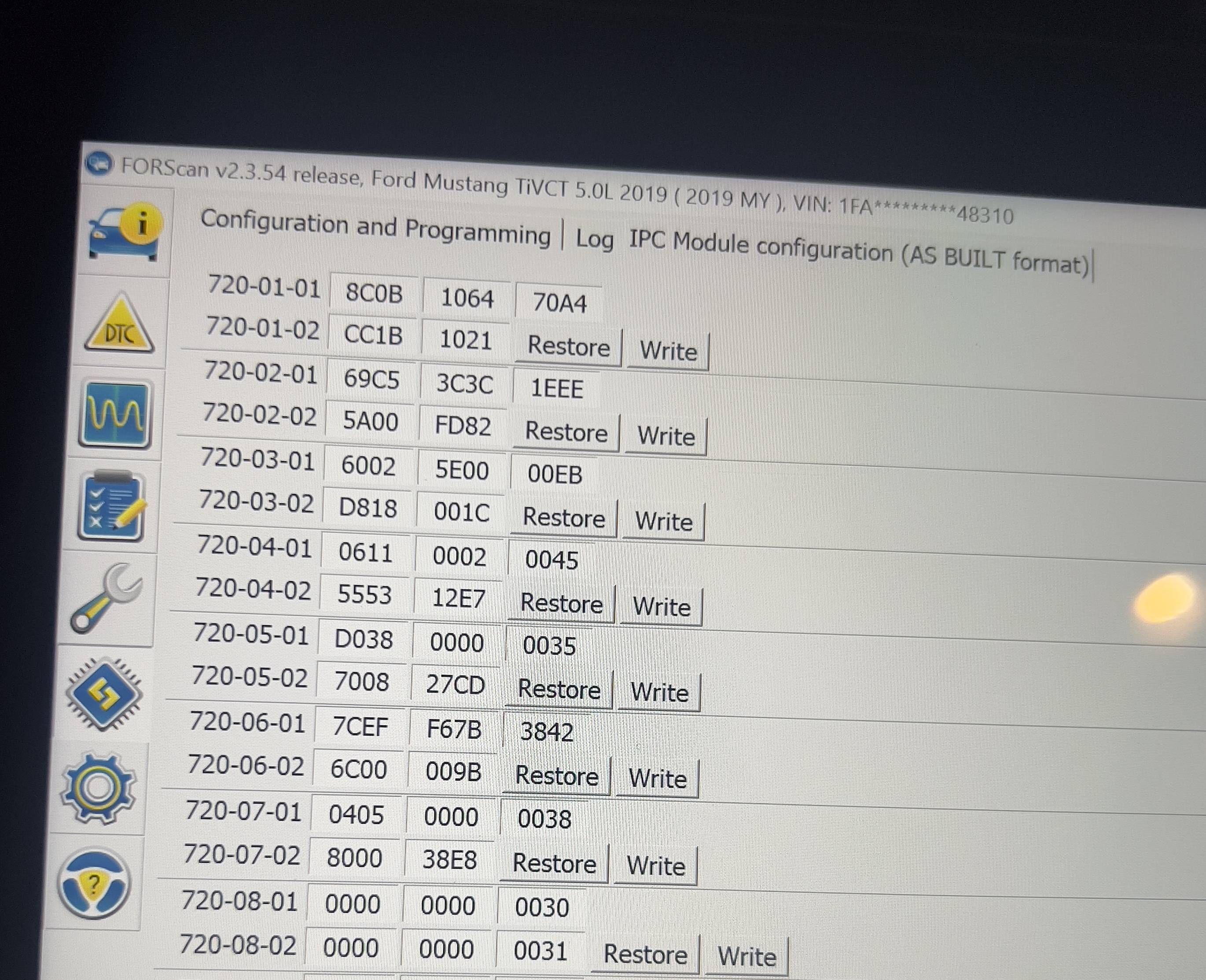

Reviving this same question. Everyone I see do this is with the non digital dash.so in order for me to get this on my 2019 401a digital dash is to change 7CEF on mine below to 7C7F
94gt
Aug 20, 2021
27
192
294
Ohio
Mat
21' F150, 21' Mustang GT
I was able to get it to work on my 401 with the digital dash.
