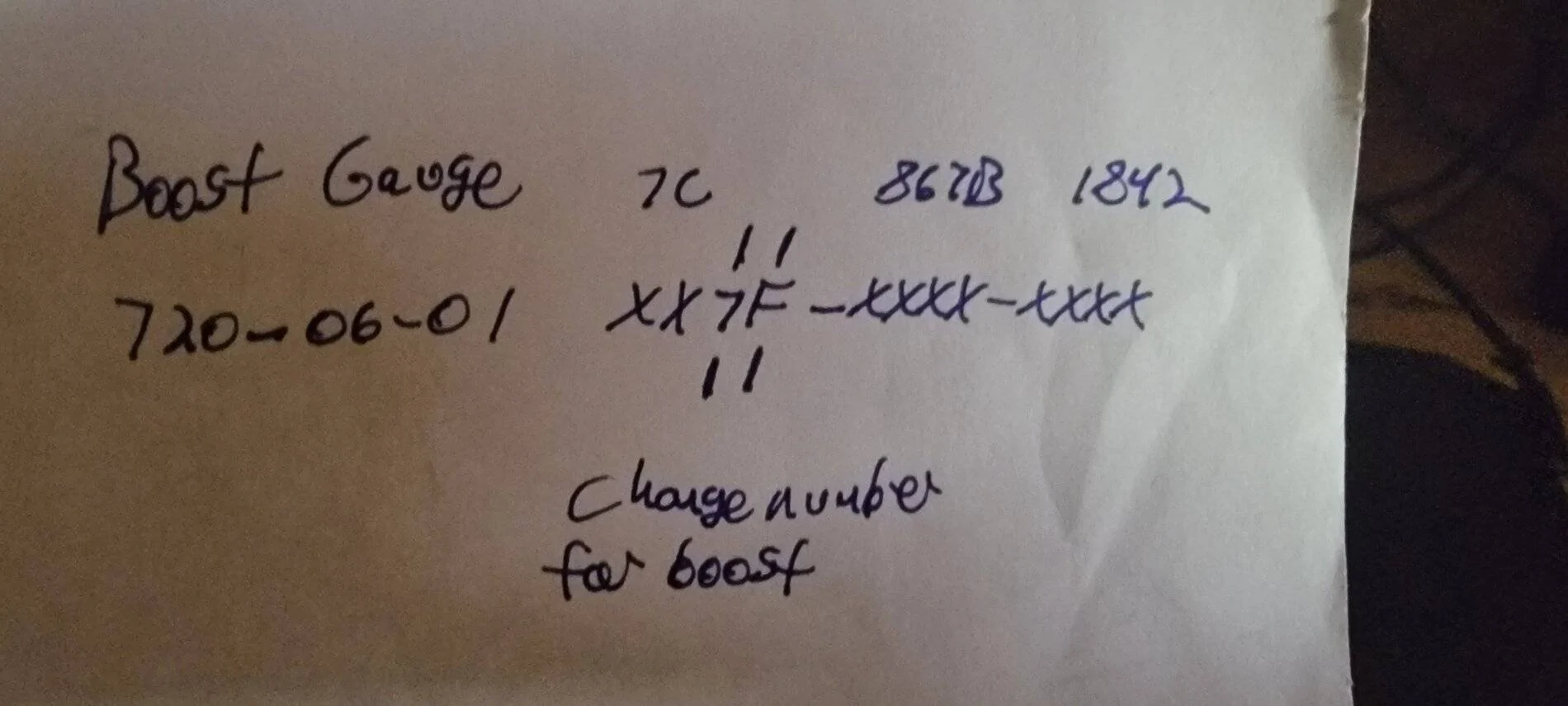

Sure thing.
This code change should work on 2015-2017 non GT350 clusters to enable the vac to vac/boost gauge:

Change whatever number is in the third place to 7?
I believe it's change the 3rd and 4th digits of the 1st set of numbers to "7F".
I need to read out my As-Built in the cluster to be sure....but just save your stock As-Built in case that's not correct and you can always revert back.
