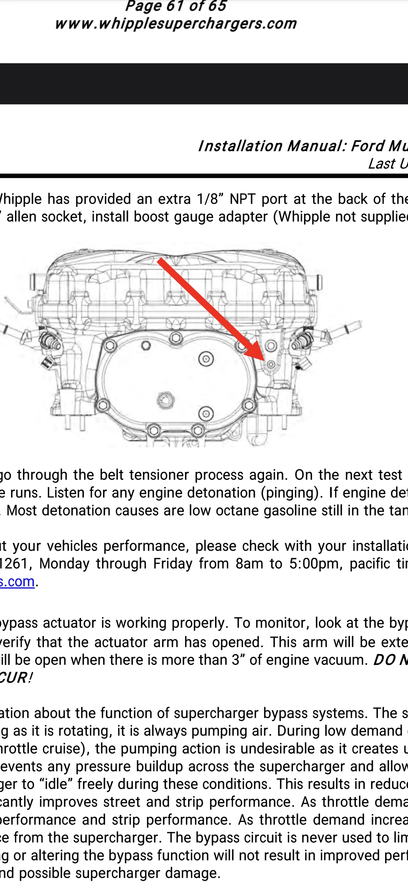

Is there a port or threaded anything that leads to boost on this supercharger? I'm looking to install a tap for a MAP gauge so I can get an accurate boost gauge reading from it. Any leads on where to look?

On the back of the blower, directly below where the air temp sensor is installed there is a port you can use
