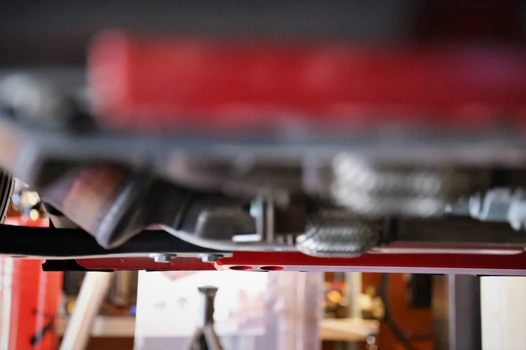

Nice little review by @Epiphany
Last pic references the amount that our Super Low Profile Rails stick below the pinch welds. Many people have questioned this, so I think that picture does a great job!

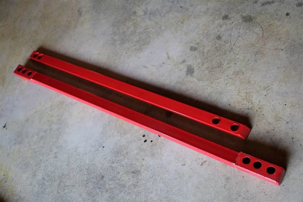

Had an opportunity to get a few things done today including adding the latest "Super Low Profile" jacking rails from BMR. I've had the standard chassis jacking rails from BMR (CJR001) since my car was new and have been very happy with them. But once I lowered the car with some different rolling stock I noticed that the boxed ends of the rails were making contact with the top of my low profile scissor lift each time I drove over it. I needed to gain some clearance back, especially if I'm to use the FP springs which lower the car almost 3/4". It'll be close.
The latest rails, CJR002, are a little shorter than the CJR001 rails and the profile is much shorter as well.

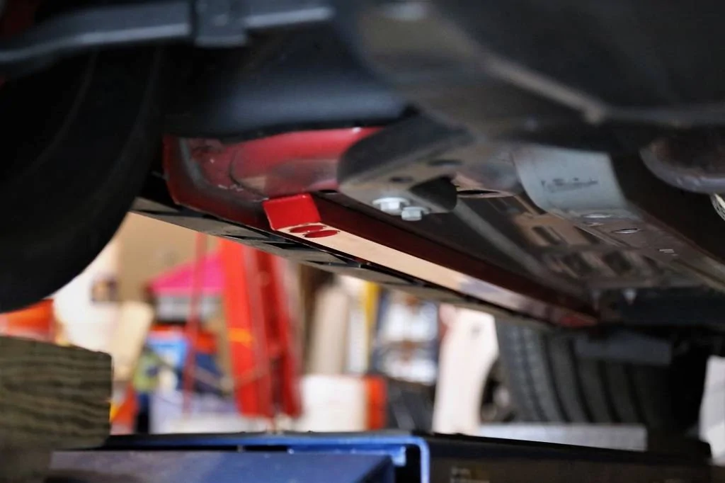

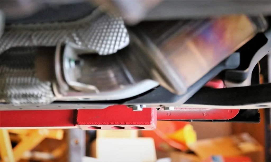

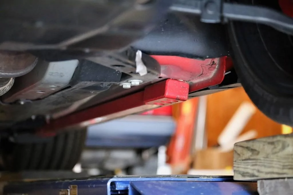

The CJR001 rails hang down a bit below the pinch rail.
With the passenger side swapped to the new low profile rail and the older, CJR001 still in place on the driver side, a comparison...
Aside from the small plate welded on the end, the full length of the new rails are from 1/16" to 1/8" lower than the pinch rail, exactly what I was looking for. Thanks again for offering even more choice Kelly. I'm very happy with more clearance and less weight that the CJR002 rails offer.
