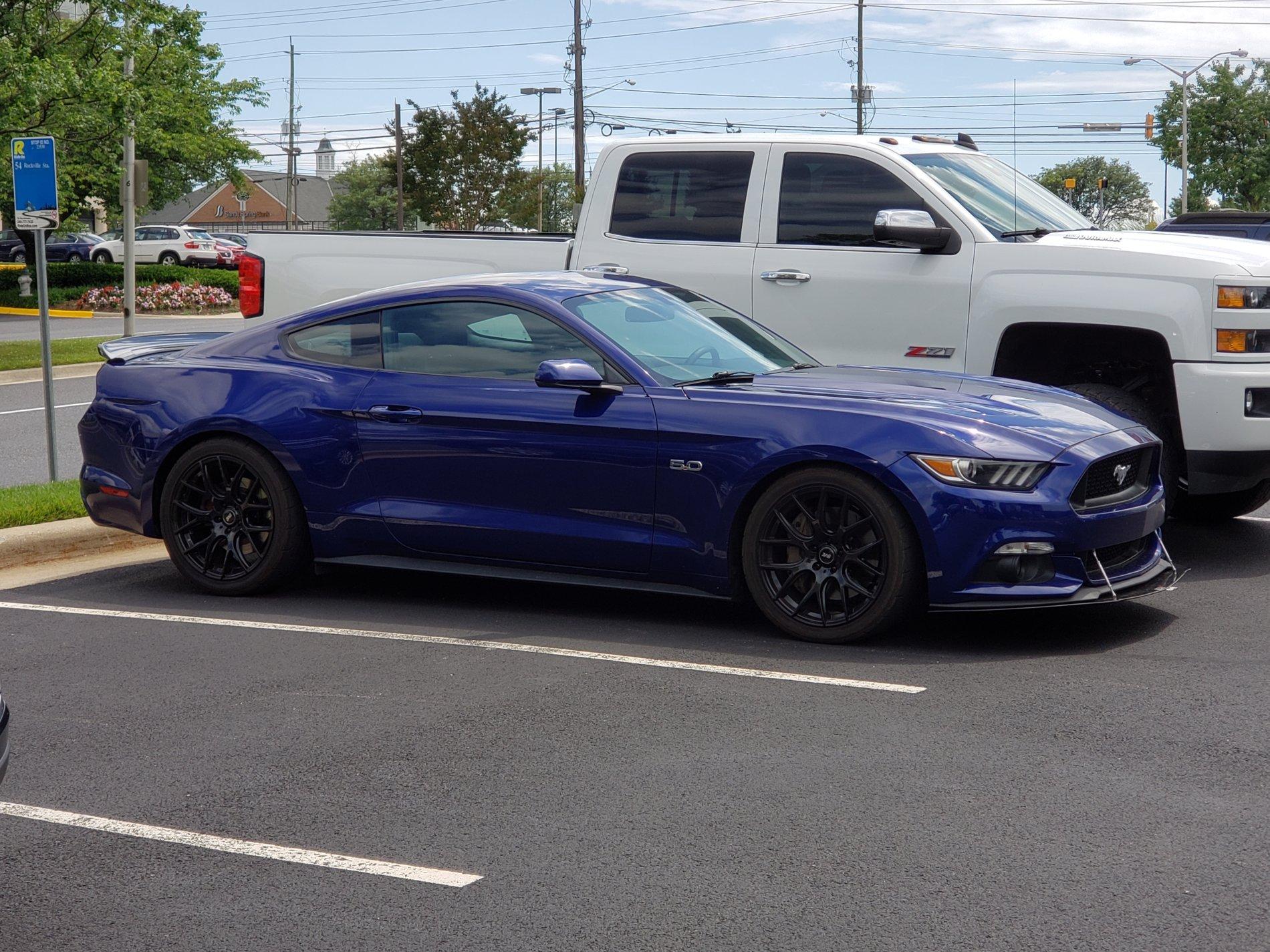

    I drive the BMR handling springs on the street also. No regrets. I highly recommend them over the BMR performance springs. The car has the perfect stance IMO with the SP083.
    Edit: I should also add that I have used the BMR SP080 performance springs on this car, with KONI sport dampers. So I have direct experience. With the SP083 springs and FP dampers I much prefer the ride and handling.
