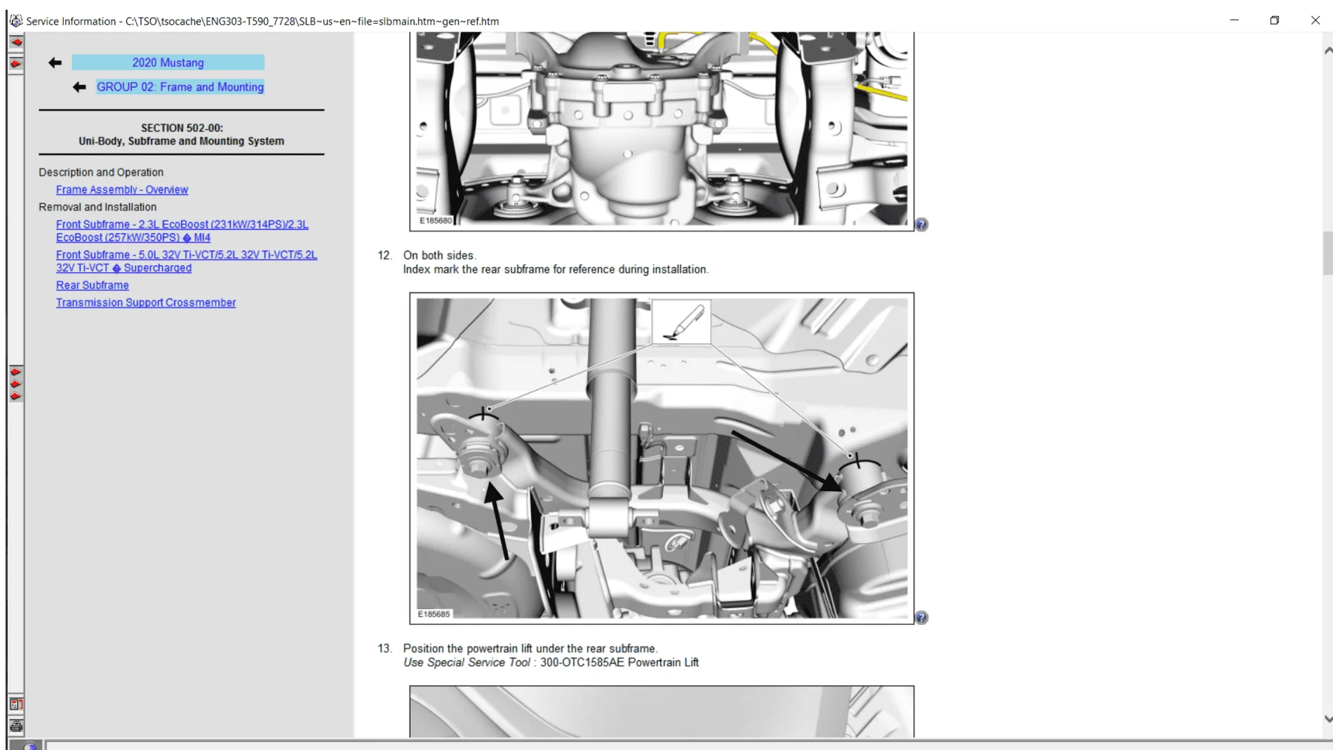

Thanks! I guess my only other question is do I need an alignment after installing the CB005?
This might help, notice the suggestion Ford makes step 12. could save an alignment. Reading above, now know these are the sub-frame alignment, adjusters.
Ford uses witness marks many places, another one seen is for the drive shaft removal and install.
