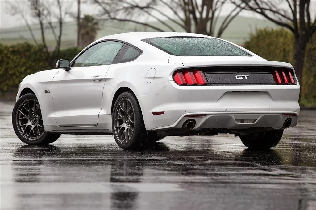

Thanks very much, ApexRP! You just answered my question as to "What fits?" I'm still undecided what color to go with though. My car has the chrome trim vs. the blacked-out look. Personal preference, of course, but I've never had any other than the stock 20s' on my car. Can't wait to get my EC-7s! :handsinair:
Basically, the white GT from the Apex website is identical to mine, save for a different rear valance, black exhaust tips and a 1" drop. Apex photo attached.
You can always try the wheels first with the OEM chrome lug nuts to get a feel for it. If you like it, great! No money out. Otherwise then you can purchase the Gorilla option in black if you're looking for something darker.
