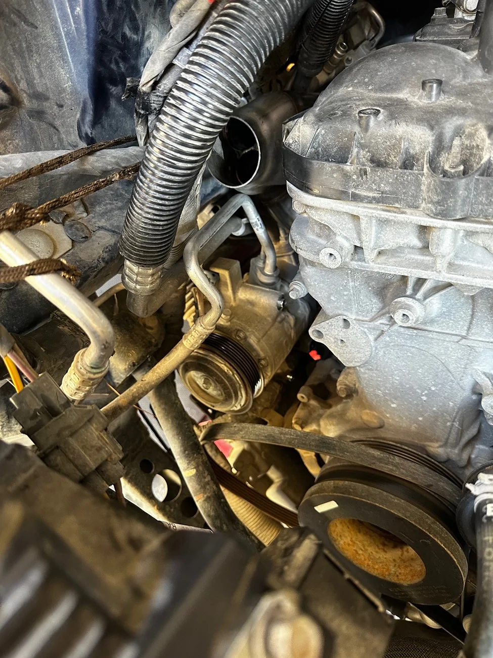

Anybody run the BL fabs forward turbo headers currently having a issue with the passenger side hitting the ac lines so it won’t bolt up at all, if anybody has tips would help alot

I’m gonna disconnect the ac compressor and move it out the way and see if it will work like that right now

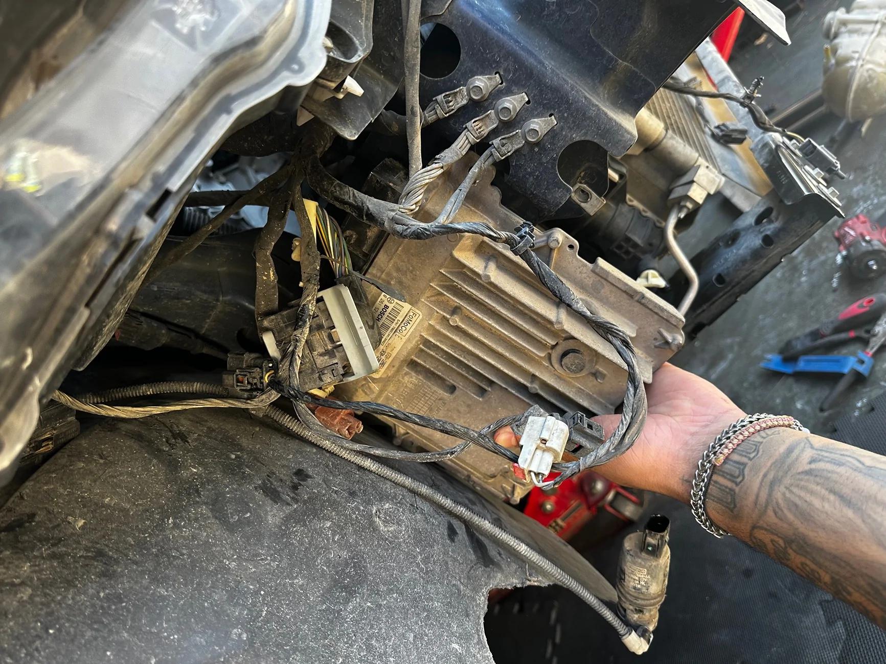

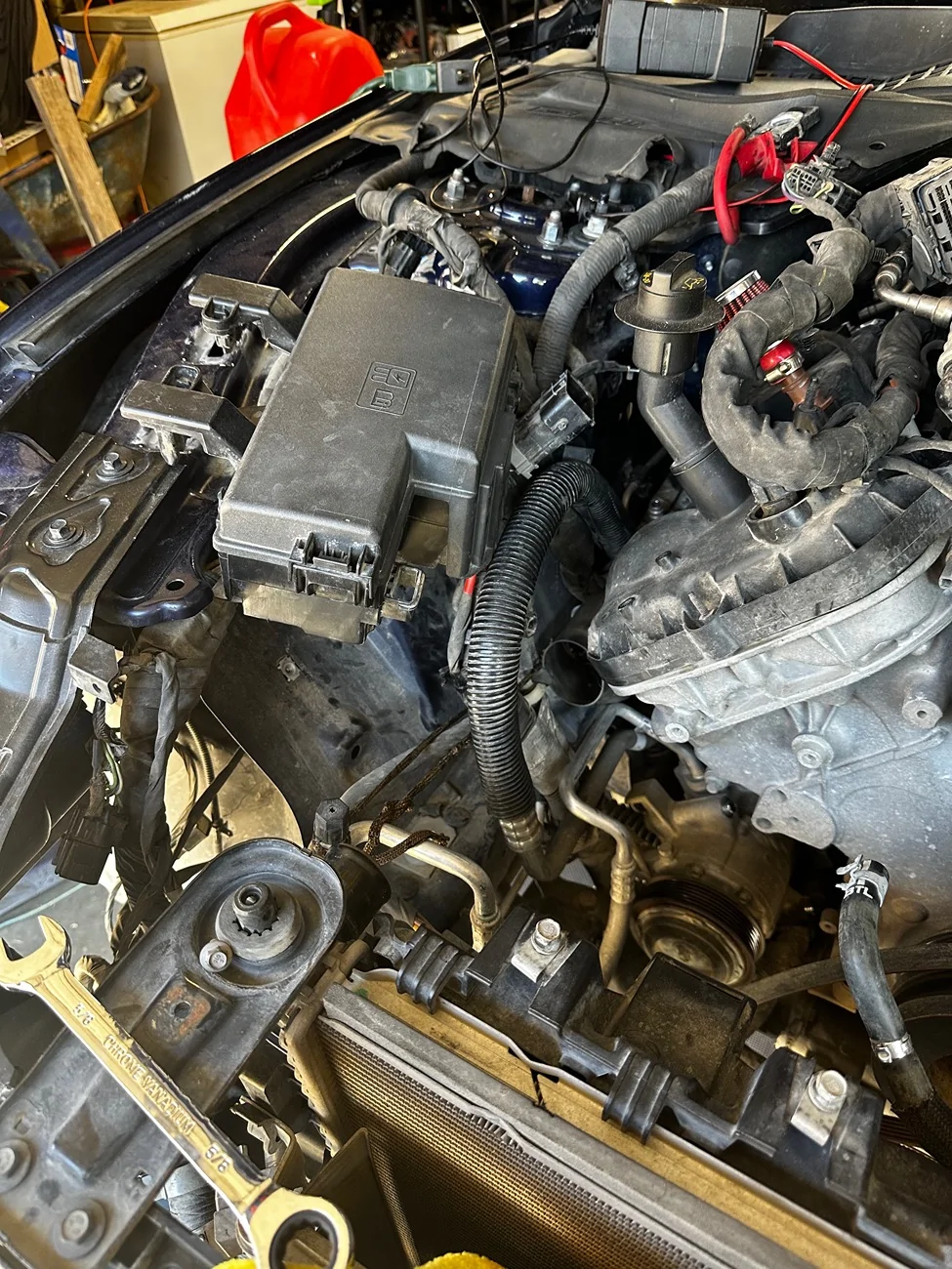

I ended up removing the compressor and have to remove the pcm, unclip a lot of the harness, remove windshield reservoir (that’s where the pcm is gonna have to go to now) and the w same time lower the engine while sliding the bolt on was a pain but managed to get it on his gonna have to reroute the pcm

I actually didn’t remove it boss I just have to move the pcm out the way

I’m pretty sure custom ones would make a lot of room but it does have a lot of room with the stock lines the only thing I’m worried about is the wires that run to the fuse box and battery I am gonna have to find a way to move them/relocate

On3 sells a PCM relocation bracket.
