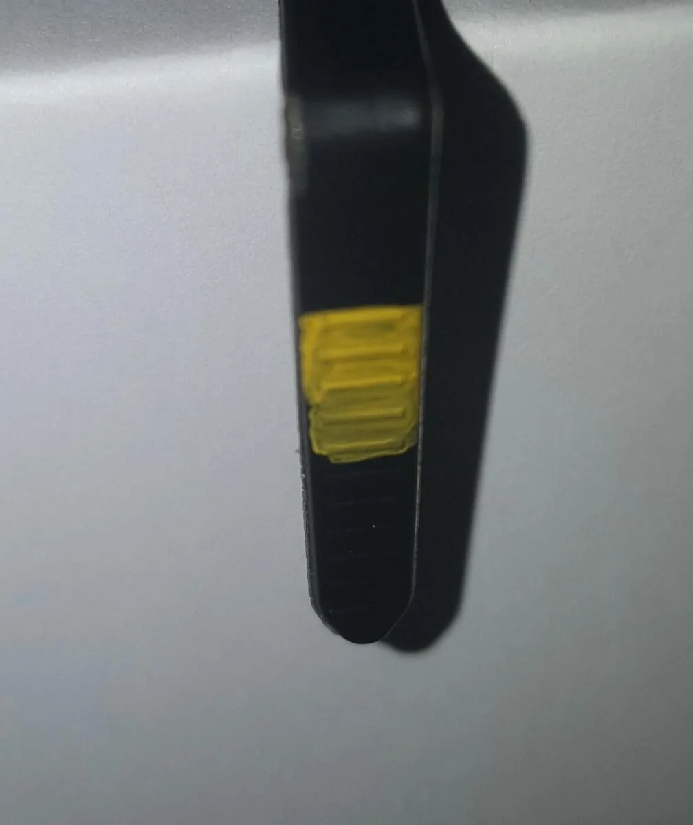

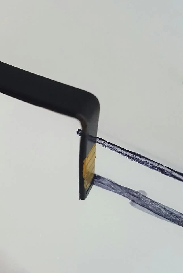

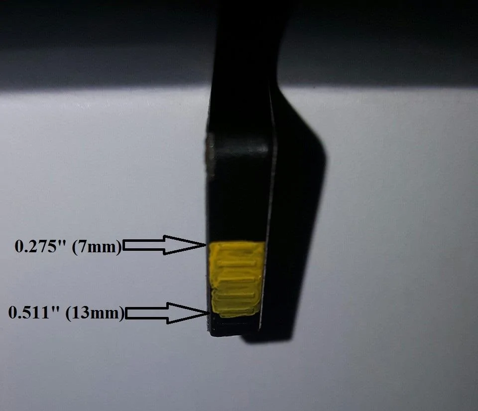

We have not verified it, but you can use a tie-wrap (Zip Tie) like we use in our Rear Axle Kit to check it.
This is new information in the 2016 Service Manual. You can try it and report back but as you said, close to impossible to get an accurate reading. The pump hose barely fits in the fill hole.
Take a plastic tie wrap as pictured and mark it with a range of .275"-.511". The fluid needs to end up there. Bend the end of the tie-wrap and heat the bend slightly (a lighter works) It will help maintain the shape of the bend at a 90.
We still feel our measured out method is just more reliable due to the lack of room to do much near the fill plug area.
Basically Ford doesn't want you to over-fill it.
We will try to verify it this weekend and add it to our kits if it seems reliable.

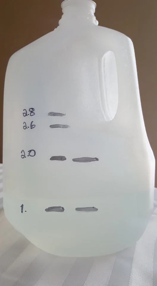

Level Comparisons
We used a 1 gallon milk container to illustrate what the difference in fill quantities really are. It is exaggerated in the milk container due to the smaller surface area. The transmission fill levels would be less pronounced.
We marked off 1Liter, 2Liters, 2.6Liters and 2.8Liters(3 qts.) The bottle starts necking down so it is a slightly more pronounced change.
We also marked off 1Liter and 200ml to show the difference of level where the bottle is the same shape and volume. It just so happens this is exactly the range of 10MM +/-3MM given in the new fill check procedure from Ford.
Obviously 200mL will not change the level in the transmission by the same amount as a 1 gallon milk container. Our point is to illustrate that in this case close enough will get you to where you need to be.
200mL is about 7 ounces rounded off. It's what is left over from our kit. The difference between 2.8L/3qts./96ounces and the fill specification of 2.6L

Yep, very odd. I have that manual right next to me. Never saw it isted in there. :eek: I always went by the serivce manual. Thanks for pointing it out. Attached is the factory method that was not in the original 2015 downloads, but are now in 2015-2016 that we have.
EDIT: Just found the online version, it looks like they standardized the fill, lowered the level slightly and raised it on the V8. 3mm (.119")below is basically filling so it doesn't pour out.
