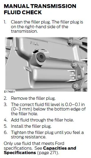

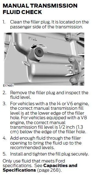

From the Owner's Manual for 2015 and 2016.
In both 2015 and 2016 OMs, they show the MT-82 fill capacity as:
2.7 qt (2.6 L), with a flag note saying "Approximate dry fill capacity. Actual amount may vary during fluid changes."
Here are the snip-its from the OMs. First one is for 2015, second one for 2016. Going by the level below the fill hole is what I'd be shooting for, so a 'dipstick' is the way to go IMO.
They do however say in the 2016 OM that right up to the bottom of the hole (0 mm) is OK. So just fill until it just starts to dribble out the hole.

My owners manual has this on page 221 and says this for all manual transmissions:
3. The correct fluid fill level is 0.0–0.1 in
(0–3 mm) below the bottom edge of
the filler hole.
So basically fill it as far as it can go.

So above assumes car is level - mine was slightly not level (front on ramps, rear on jackstands but not quite the height of the ramps) and after taking filler plug out, fluid was leaking a little bit. So it fill it with the bottom edge or just slightly below it, it is somewhat important to have it level.

Not to beat a dead horse :repost: but it seems Ford can not decide where they want the level. Our kit puts you really close to the Dry Fill of 2.6L. The car needs to be level front to back and left to right. Ford Service Techs are using the information in the Service Manual, not the Owners Manual. The serivce manual gives a different fill level than the owners manual(s), all versions :)
Fill it with 2.6L, or just below the fill hole. You will be fine. Keep in mind that if the car is lower on the drivers side than the passenger side you will be able to overfill it. Level is important.
Hopefully this is clear to everyone :D
