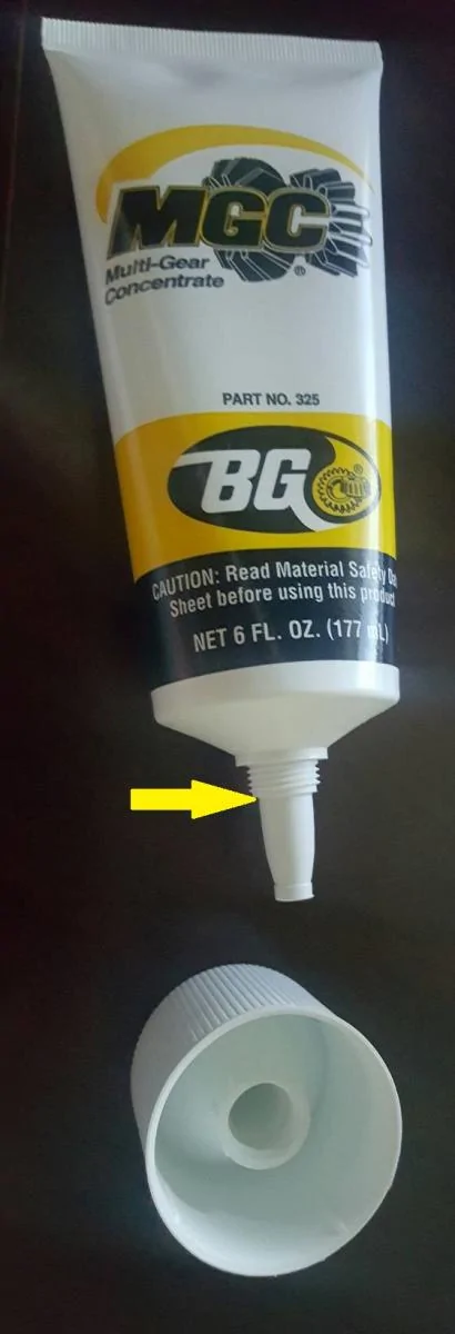

Very interested in this stuff...
How do I apply it if I already did the mt-82 and diff oil swap to BG? Could you post some detailed instructions?
Just take your pump from the BG kit and pump it in, it's only 6 oz. We have two different style containers so the conventional bottle is pretty straight forward, on the one we have that is a squeeze tube just cut the end off the tube and put the contents in a cup and then use your pump to pump it in. If you just jack up the passenger side of the car you will be able to get it in easily. Depending on how full the transmission is you may need to loosen the drain plug to let out a little fluid (the cup that came in the kits worth- to below the tape) but in the end the 6oz's isn't going to terribly overfill it if it was at the correct level. It will come down to if you used all the fluid or did the measurement with the cup.
While you may be able to cut the nozzle off of the tube and stick your pump in the end (pictured) I would just squeeze it into a cup.
If you are doing the fluid change you would just simply pour it in the container with the fluid as you fill the transmission.
