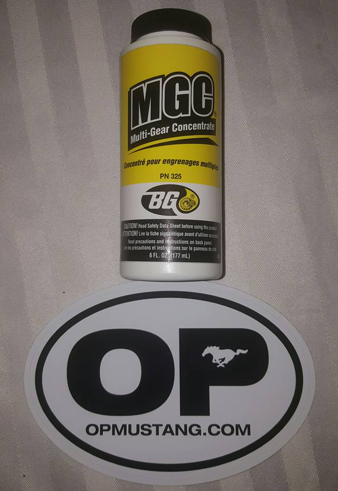

MGC Multi Gear Concentrate from BG
We have added MGC to our site and recommend it to everyone. It will work with any of the Transmission/Gear Oils. Think of it as an additive supercharger. It may help some of those who are experiencing shifting issues.
