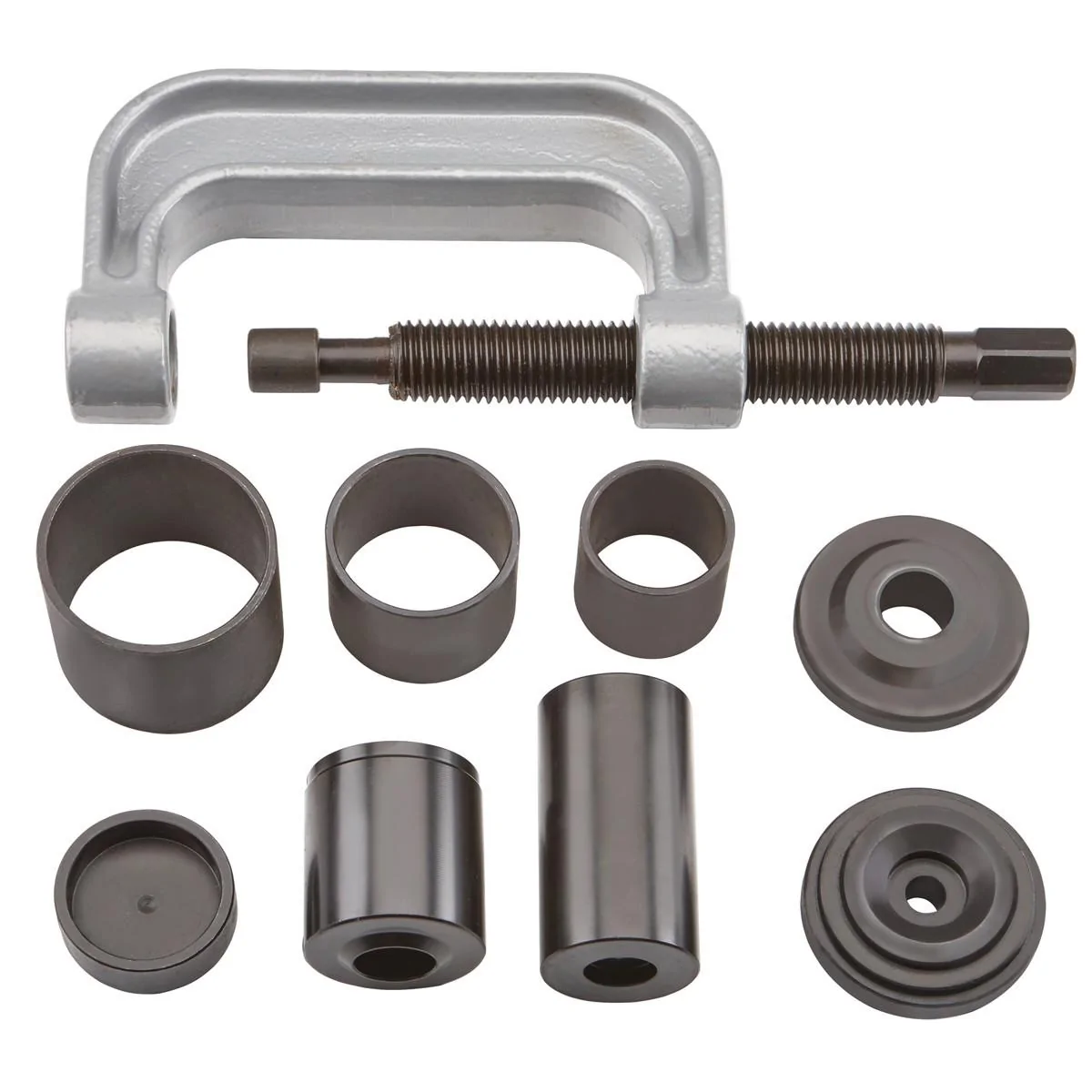

Im about to give this another shot in a couple of days. Does anyone have any advice? Last time my C clamp as shown in the picture wasn't large enough to accommodate A sleeve on on side for the bearing to pop out into, and a socket on the other side to press the bearing out. What tools/ Techniques are you guys using to remove the toe link bearing? Im trying to avoid having to pull the knuckle off and taking it to a shop, or resorting to hammer and socket to pound it out.

Just thought Id offer up some follow up since I got all this done. I used jack and jack stands.
You MUST use a shallow socket if you have the standard ball joint service kit. Most C frames are only 8 inches and a deep socket will be to large to fit everything in (Receiver mount, receiver tube, bearing,socket).
A 1 1/4 in socket (which is what the Ford directions call for) equates to 31.75mm. I tried to use a 32mm socket non impact (so the walls are thinner) and it only pushed out the rubber part of the bushing but left the metal housing. I then had to use a 33mm impact socket to push it out. It takes a LOT of strength to push the thing out. I couldn't get an impact to fit in there do to clearance issues and did it with a 1/2 in drive ratchet.
Overall it isn't to hard. The hardest part is trying to hold 5 things at once while you line your clamp up with everything. After that its just muscle power to push the thing out. Make sure everything is centered before you start to push it through. You dont wanna ruin the knuckle and is soft aluminum.

I'm going to give this a shot Saturday with a 33 mm short impact and a rental ball joint service kit.
