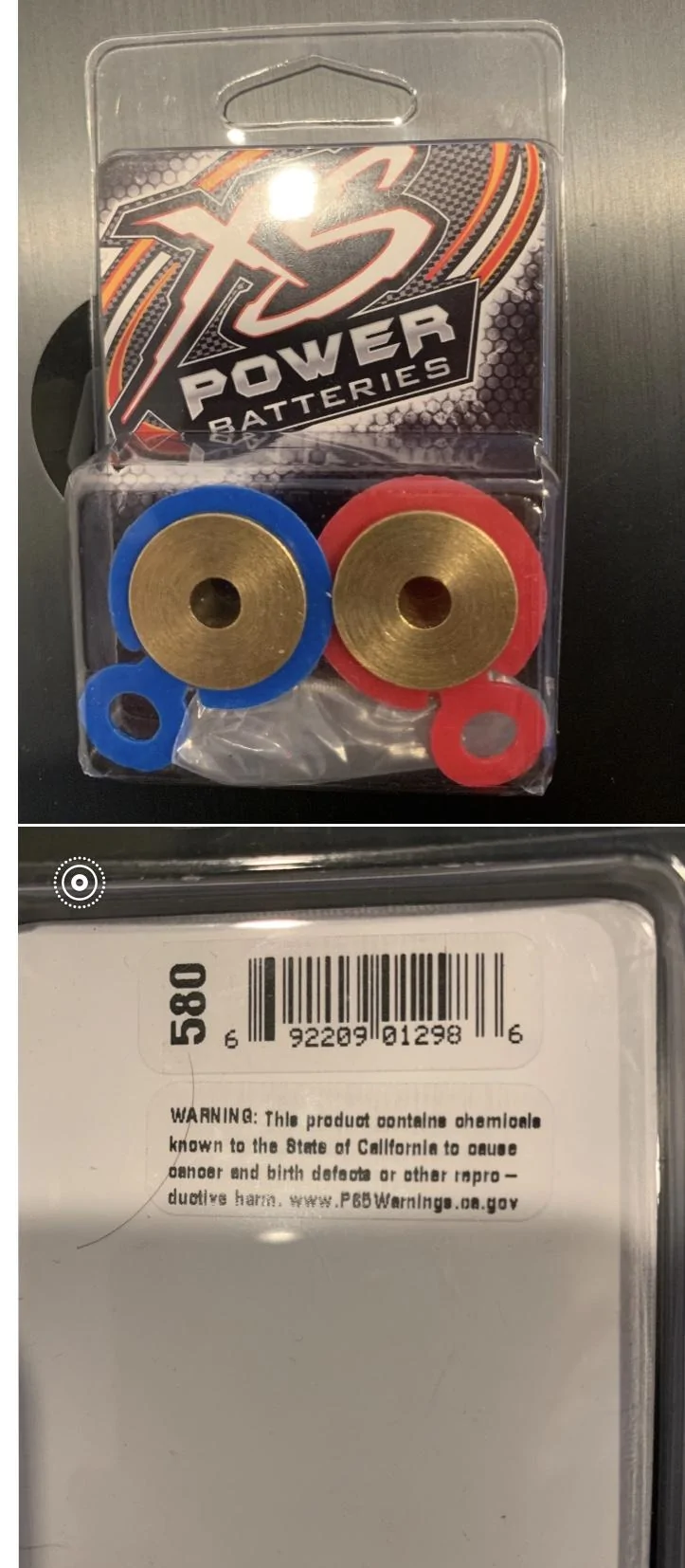

I'm pretty sure 580 was what I used.

Came across that too, just not sure which one I'd need to fit our positive cable. I'm thinking it'll be either 557, 580, or 586.
@Nagare
These came with my new D4700. I’d assume the same for the D3400/r series as well.

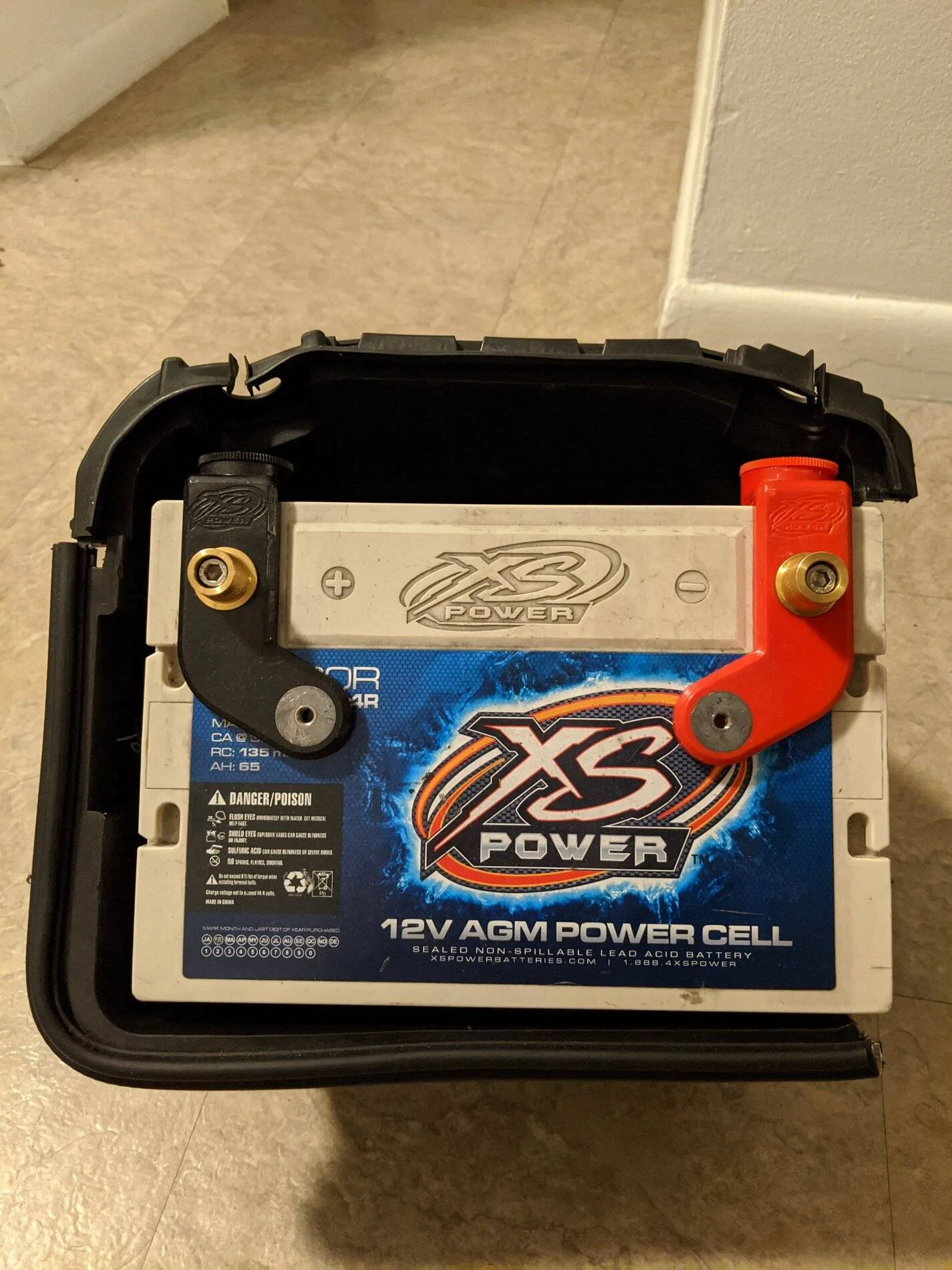

After @abeauvier's post above, I did a search for the D3400R on eBay and came across a listing for a guy that was literally 6 minutes away from my buddies house where we met after C&C yesterday. Stopped by and tried a test fit, here are some pictures.

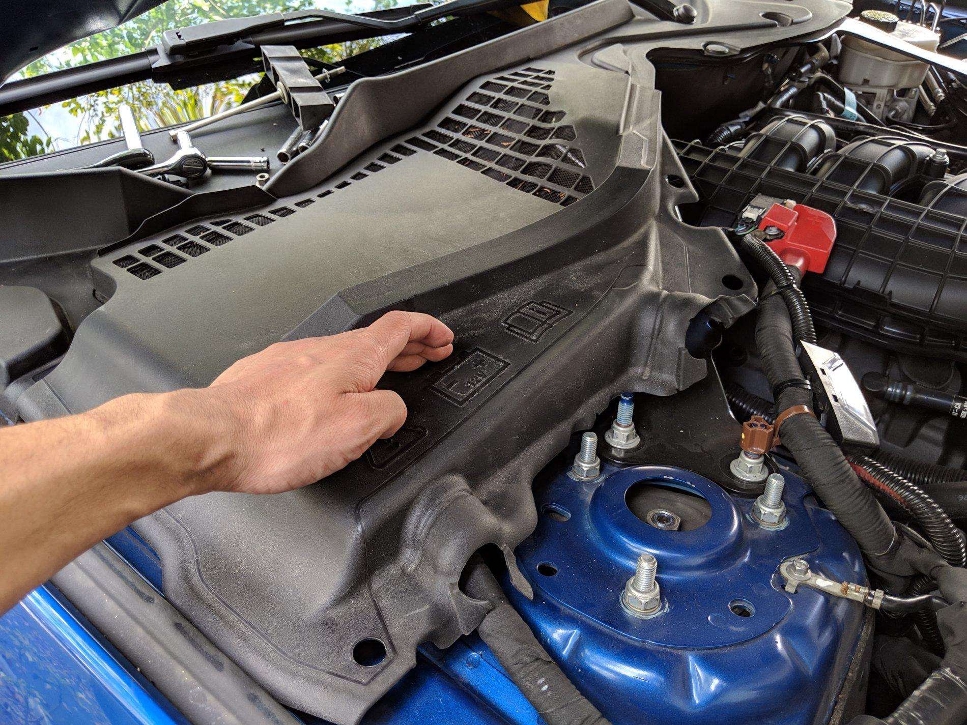

Seems like the box narrows down from the opening at the top as there were some lines from the battery about a 3/4-1" off the bottom. I bought it anyway and I'm going to try and make it work, I tried dremelling out the step at the bottom but that didn't take care of it from what I can tell. I didn't want to spend too much time in his driveway though! Without the cover on, I was still able to close the hood with no issues. If I can get the battery to sit lower in the box (maybe cut out the bottom corner), the cover will probably fit back on as well.

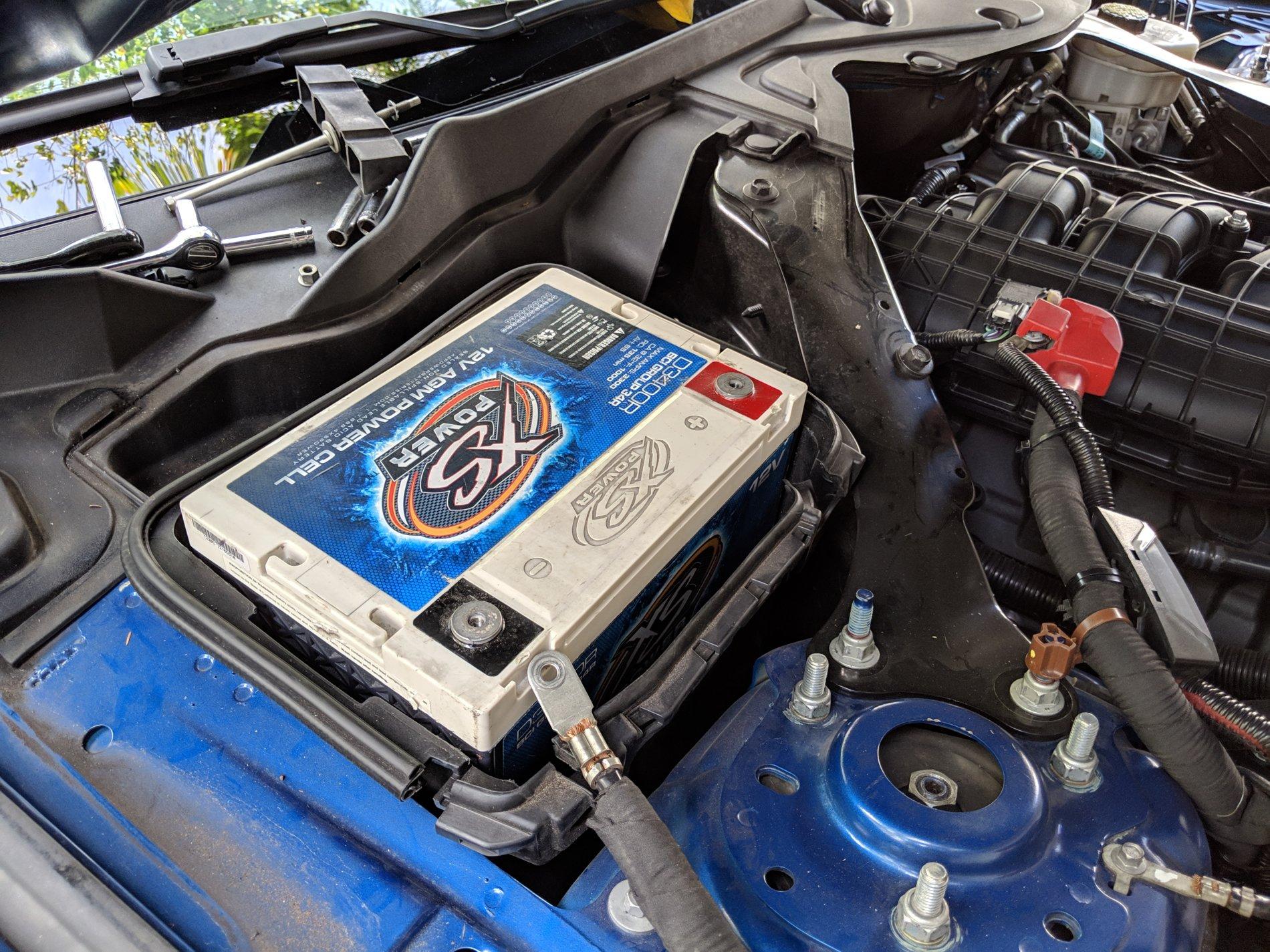

Go with the smaller one unless you're comfortable cutting the battery box. I still have it sitting in my kitchen because I don't have anything to cut the box and I forget about it every time I see someone that does have the tools!

The D4700 fits like a glove, no trimming or modding, cover fits on perfectly.

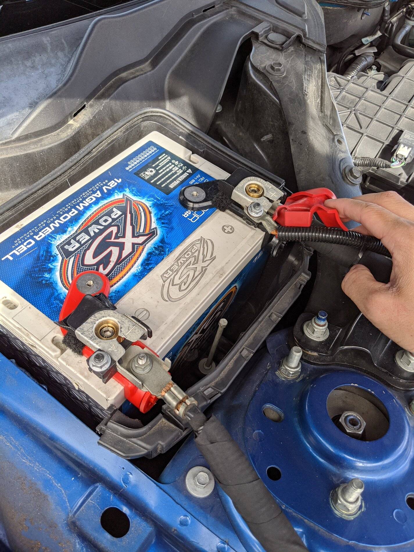

No I would have needed to change the power cables to fit it better because it was still going to hold the hood up the way I adjusted the battery box and posts anyway.
The post sticking up was the problem?
Looks like I have a couple pictures of it. If you move the posts towards the front of the car and have the cables bent down, it might work fine but I wasn't confident in that working without some more major cuts to the battery box and then you're close to touching the frame at the strut towers.
