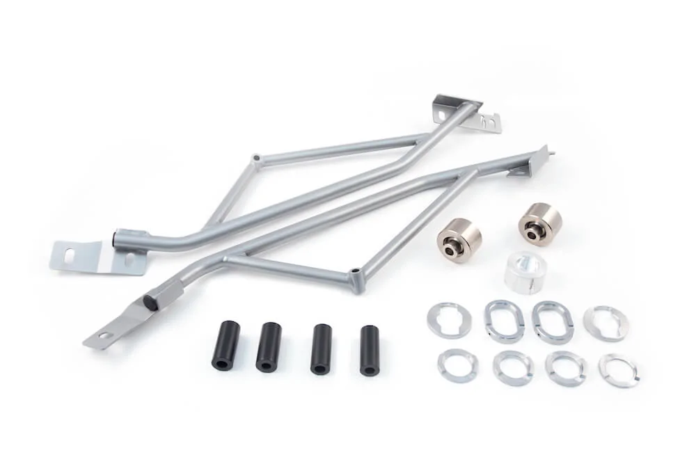

We currently have up to 20% off during our Extravaganza Sale - based on your input above, start with the IRS & move up from there if you are keeping the springs stock:
https://www.steeda.com/shop?keyword=Stop+the+Hop+Kit
550 Stop The Hop Kit
Upon launch of the S550 Mustang generation, it was the first of its kind amongst the Mustang stable to ever come standard with independent rear suspension (IRS) for all models. This launched the Mustang into the twenty-first century of modern sports car performance. Enthusiasts everywhere were raving about how it would finally corner like a Mustang should, not to say the Mustang didn't handle like a dream before with its live-axle counterpart.
For over thirty years, Steeda has been the leader in Mustang performance suspension, so it was a no-brainer when the S550 came out that we would give enthusiasts precisely what they needed to tear up the competition. What Ford created was nothing other than an engineering marvel to bring the Mustang to modern suspension status. Like every performance vehicle in the market today, there is always room for improvement. One of the IRS's characteristics on the S550 Mustang is a tendency to wheel hop due to the IRS subframe moving irritably when launched hard.

Not only does it move when launched hard it moves when in a corner.
Start with the stop the hop kit or the IRS braces at a minimum.

If you stop the IRS subframe movement, even the stock springs and dampers work pretty good, even on the track.
