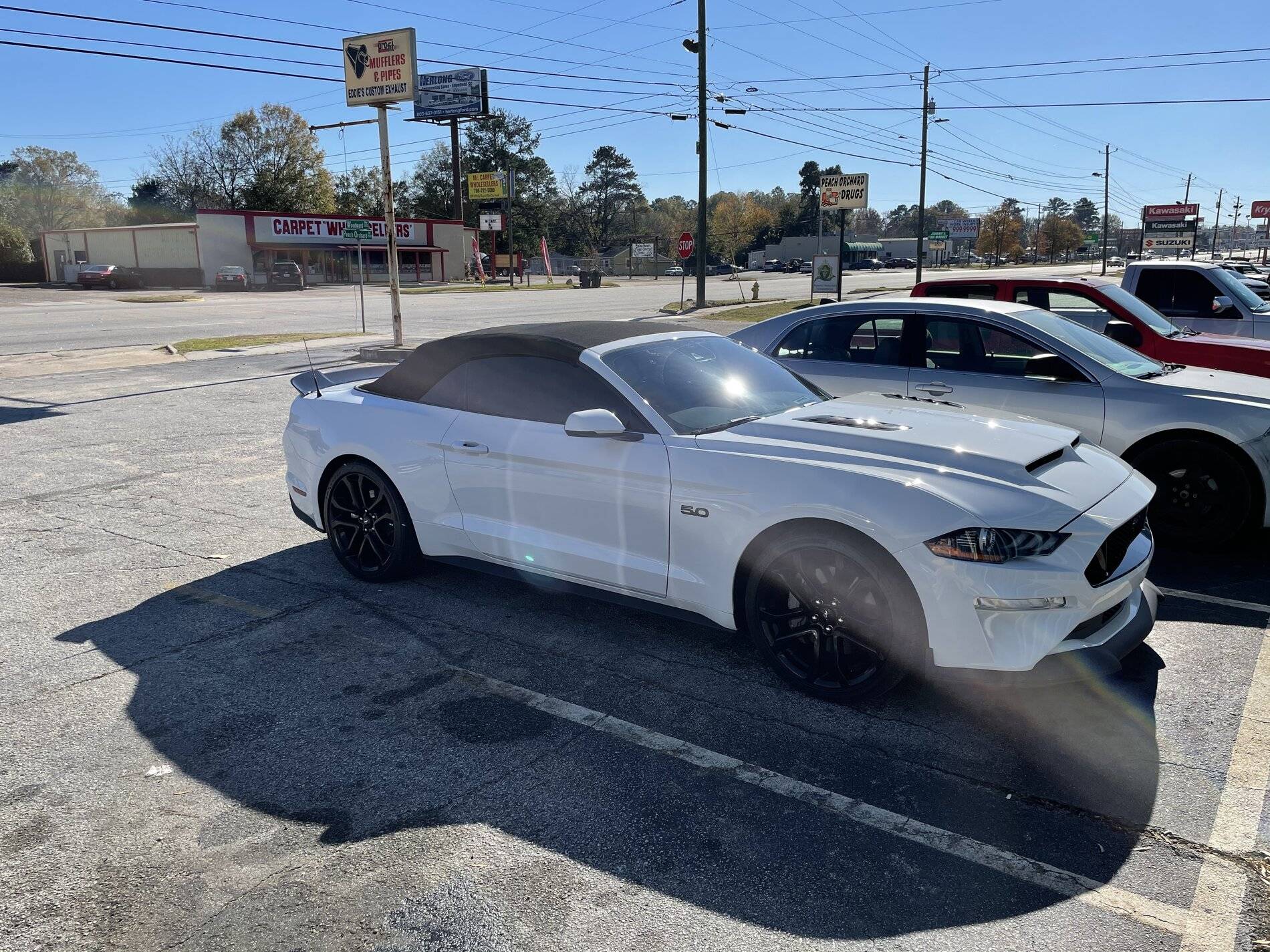

I know this subjective, but I would like opinions on the best lowering springs as far as ride quality and appearance. Wanting a 1” drop.
2019 GT premium convertible, non PP.
