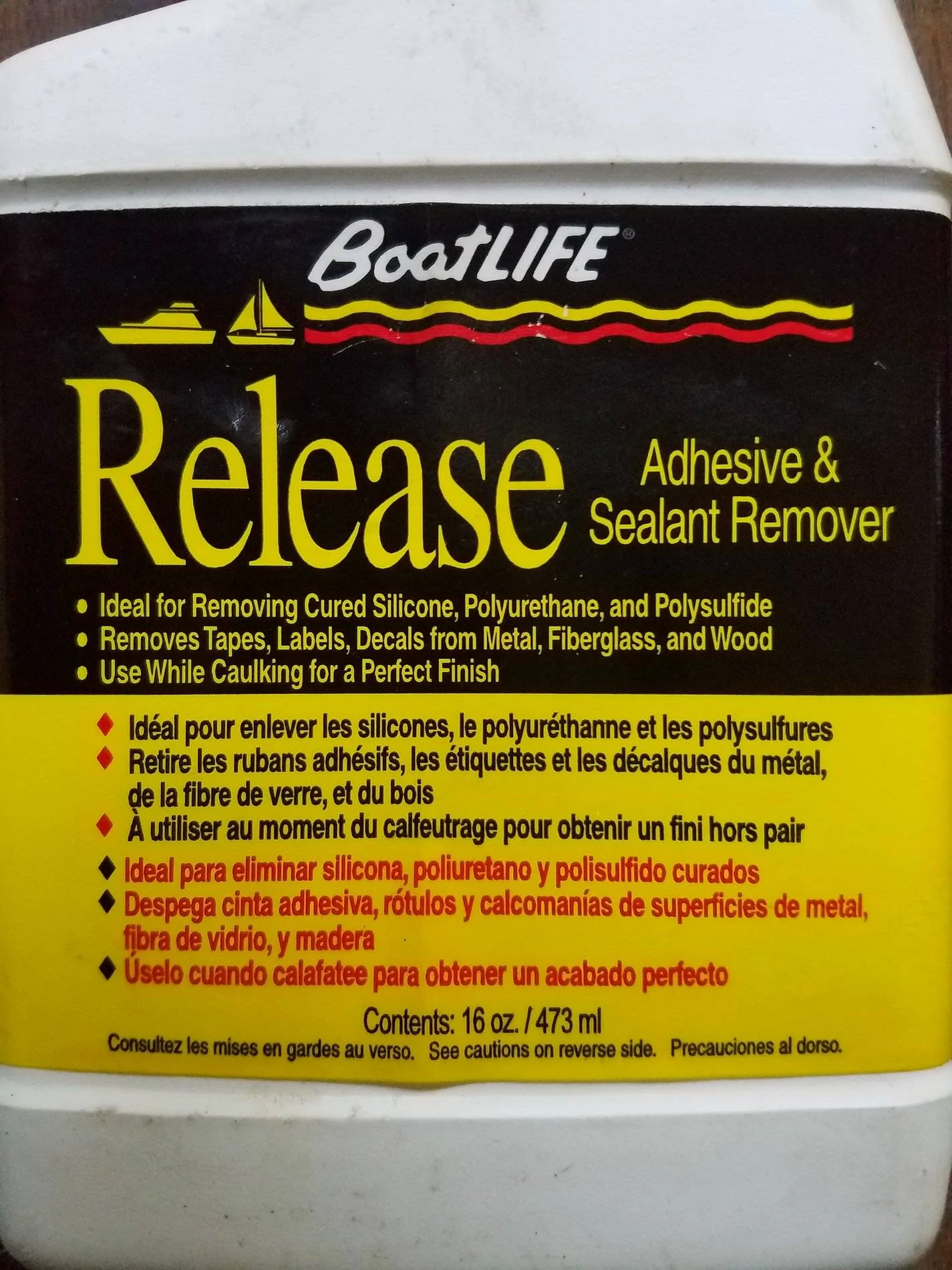

I've used this stuff for years. Has never damaged any hard surface, paint, fiberglass, etc. Never tried it on fabric. Doesn't take very much, usually spray on a rag and wipe.

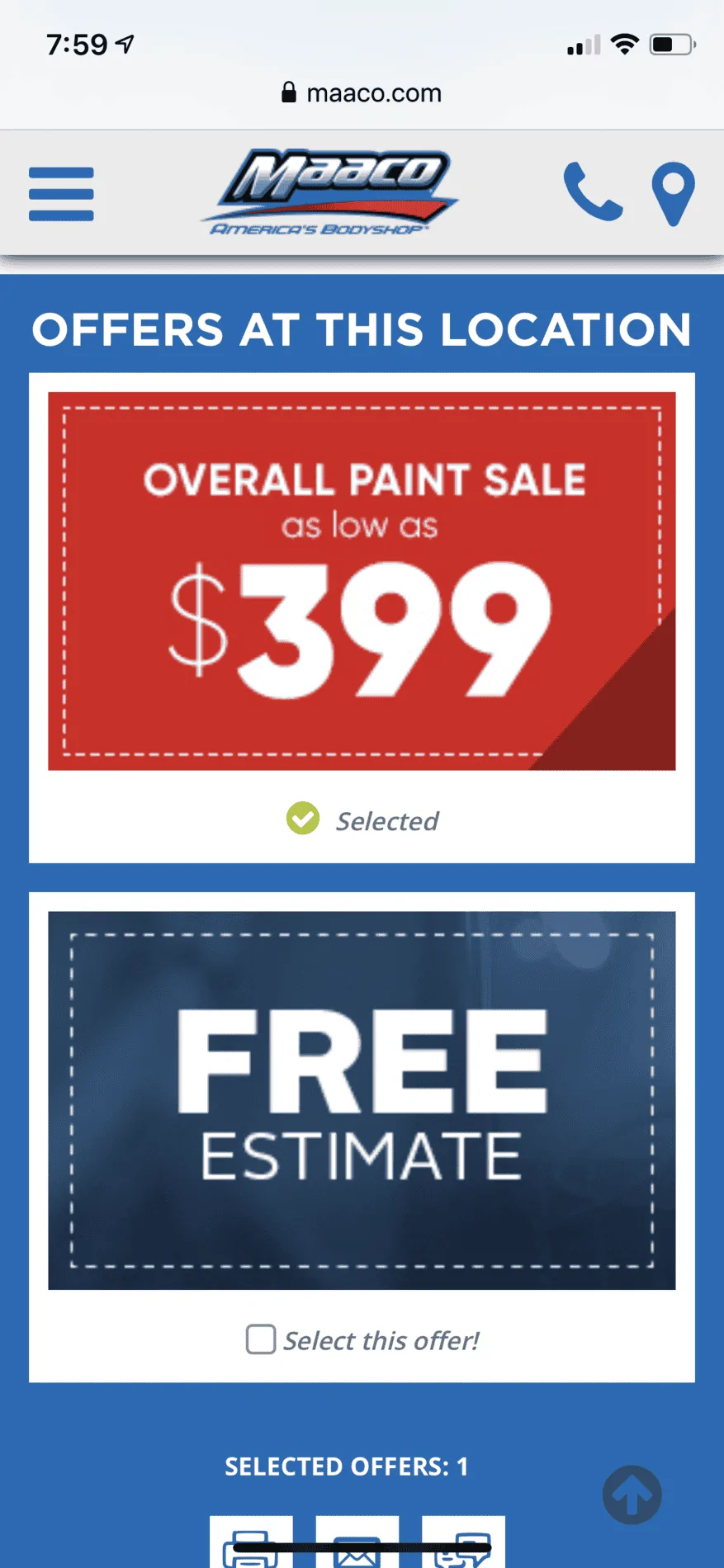

How about this stuff - too strong?

Ok I will spring for the 3M. Macao was a joke btw
