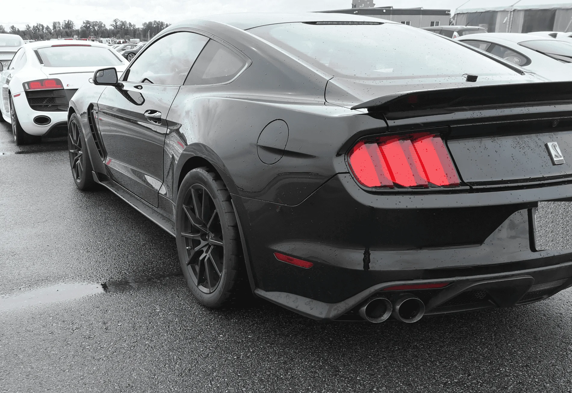

Sorry, being lazy too...anyone running the Conti's 305/35 19 square on stock non-R wheels?

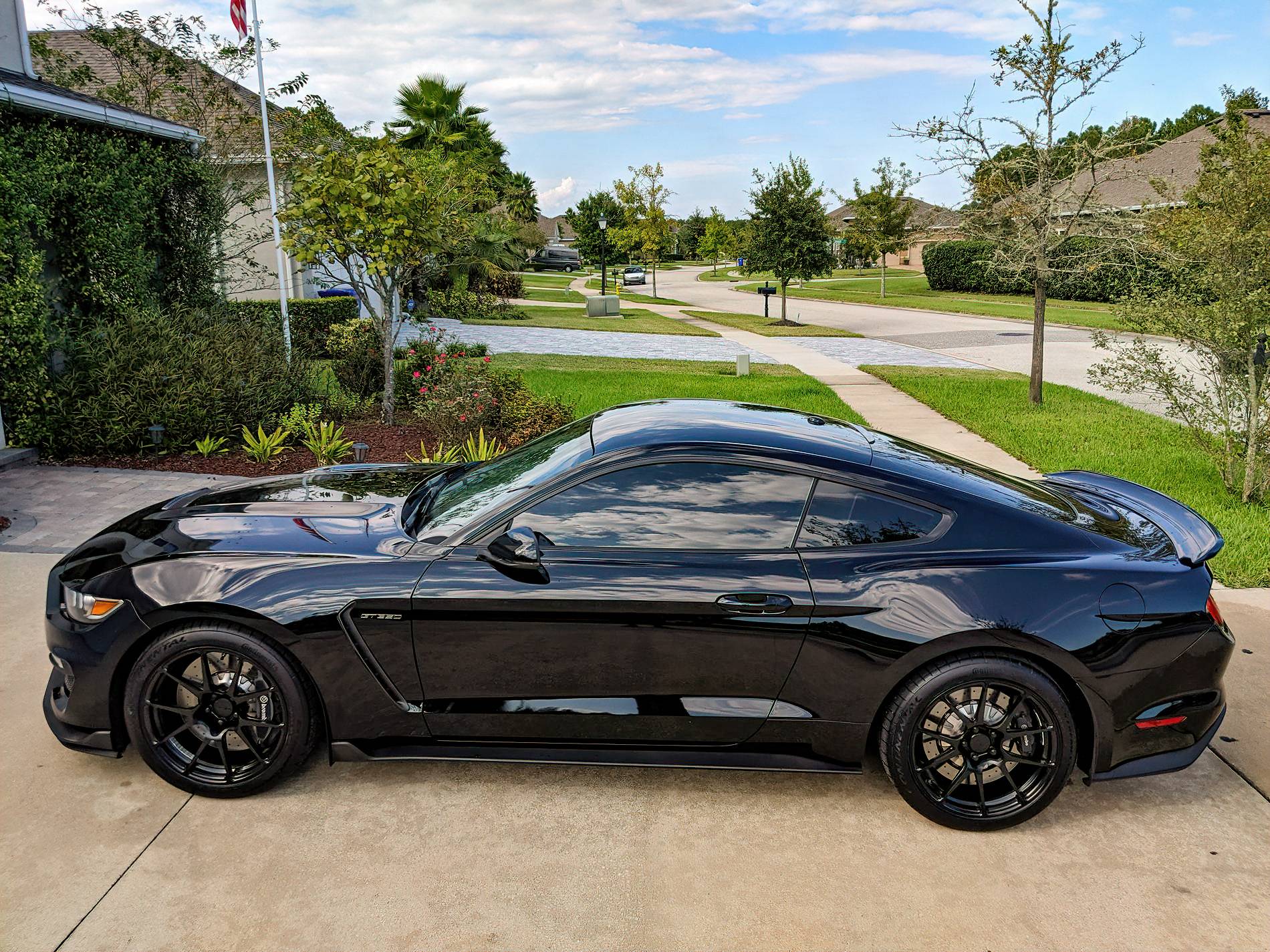

+1, Contis, 295/35 19 all around here, can't notice the difference in size. Softer ride, no tramlining. My wheels are the same exact size as the stock GT350 wheels, 19x10.5s up front, 11s in rear.
Car looks good. What wheel you running?....
