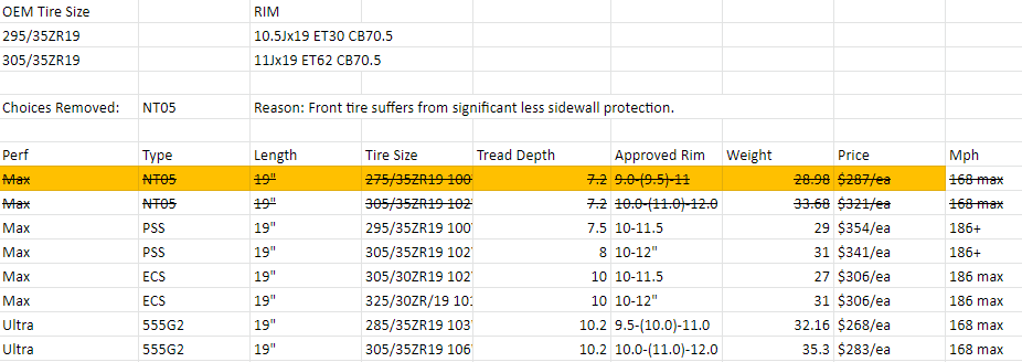

Currently I have the 555G2 with 9,500 miles at 6/32 (F) 5/32 (F). Reasonable I suppose, still have plenty of life and maybe I'll see 15,000 out of them. A little early here but maybe this discussion will help others who are in the market for new tires.
The above was collected from my own research through the internet and through previous discussions that were made here. Obviously, the main known trackable tires are the PSS and the Cup2 (non-r/ r) tires. All 3 offering you different results and feels. What I do not know is has anyone tracked the Nitto 555G2 or the Extreme Contact Sport tires?
I like the fact that the continental tires would give me meatier tires on the front and on the rear but that could negatively affect the performance. In fact, Billy Johnson mentioned when he drove the GT350R he suggested going with a 295 in the front for better handling.
For myself, I'd like to get 2 things out of this discussion.
1) Has anyone tracked the Nitto 555G2 on the 350?
2) Has anyone tracked the Extreme Contact Sport tires on the 350?
For the readers, feel free to take advantage of this 1 stop shop thread for all of your tire discussion and refer to it as needed. I'll update the picture above with a new image as new tires are added. Be advised, Cup 2 in any compound form will not be added as this thread is focused on spirited driving with maybe a track day in the year.
