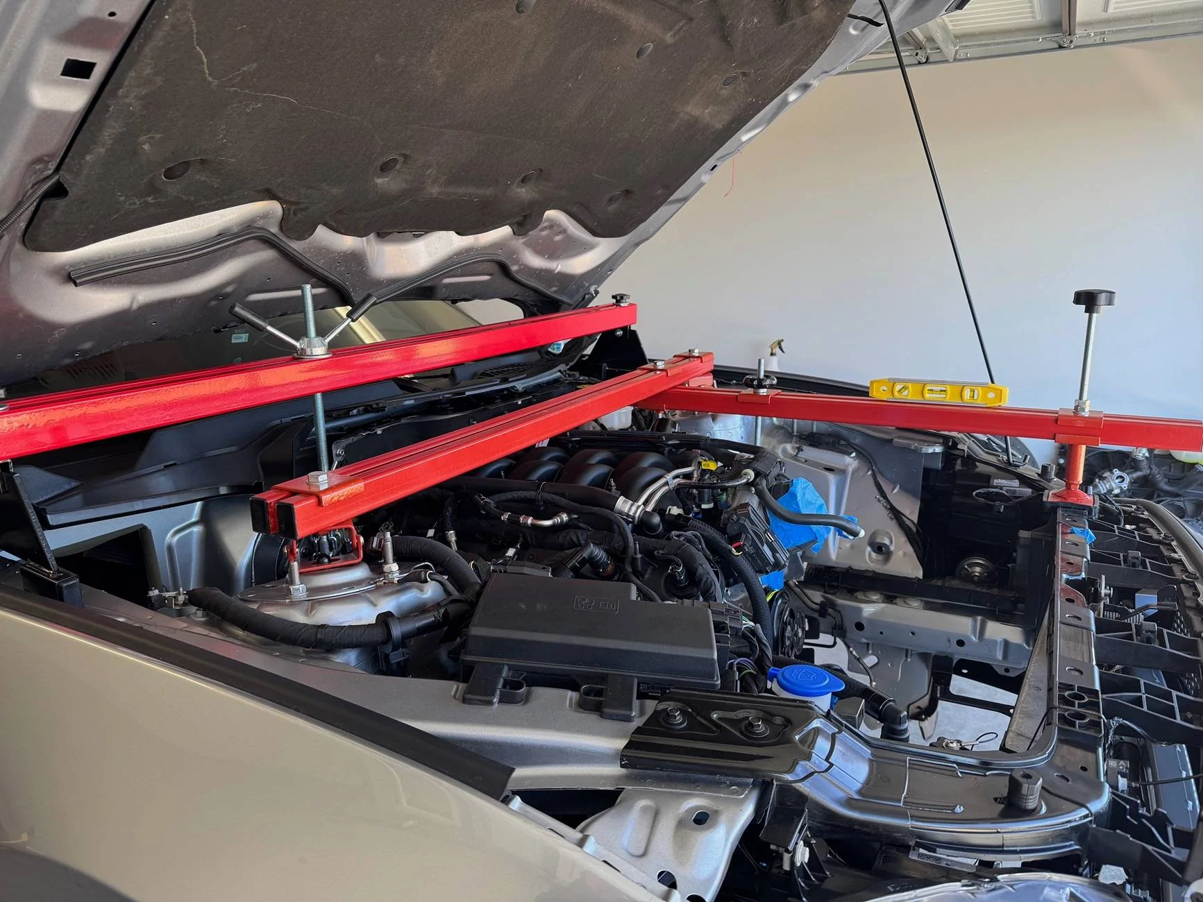

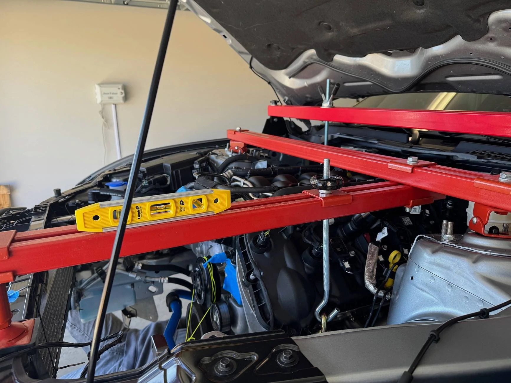

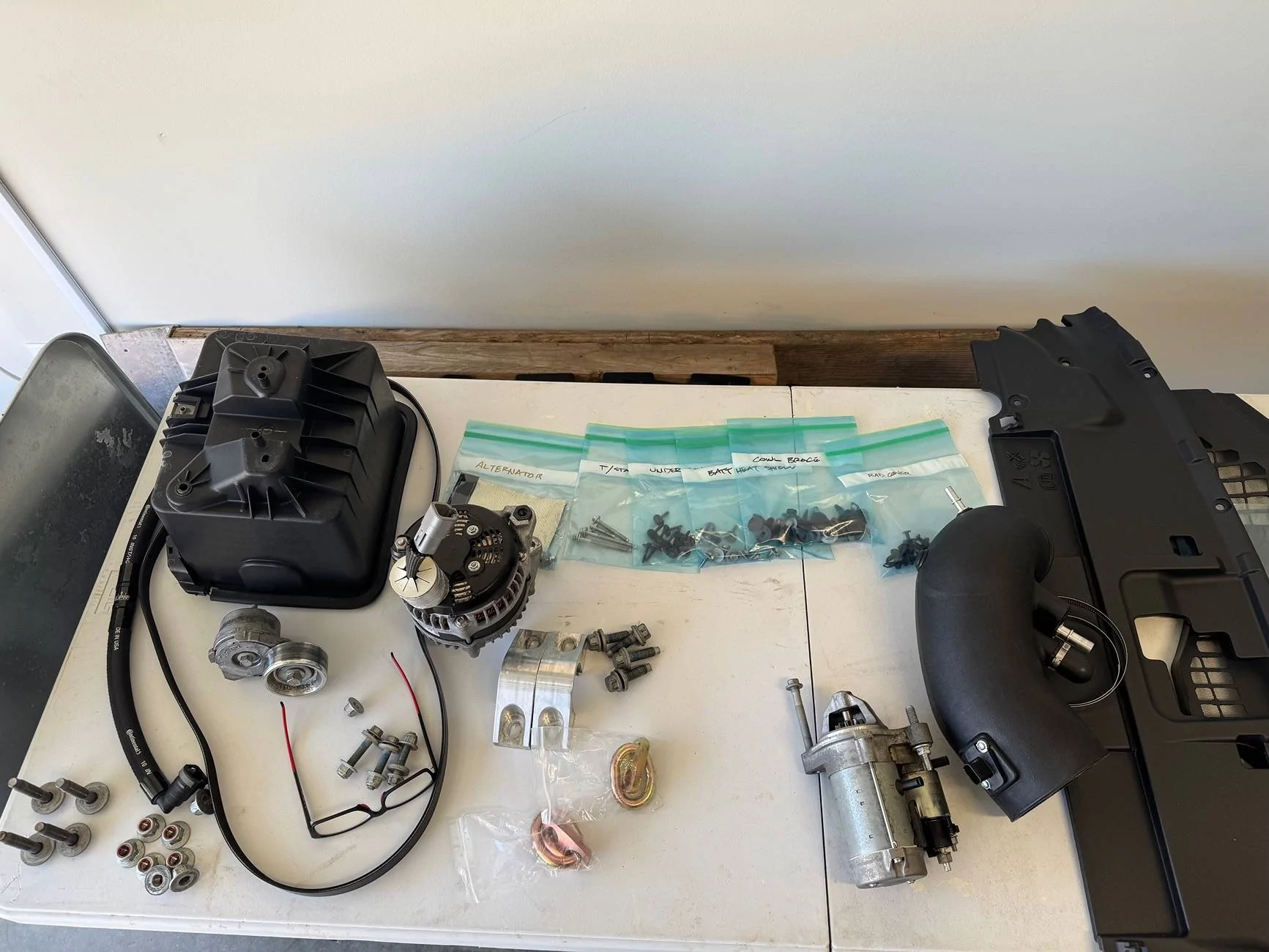

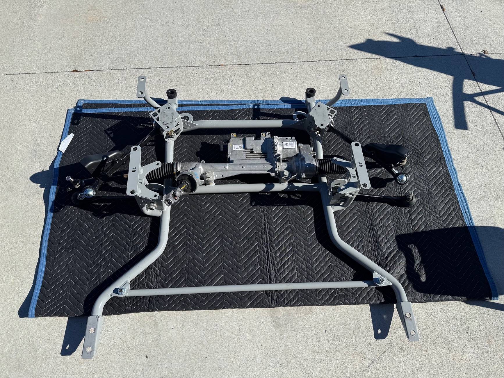

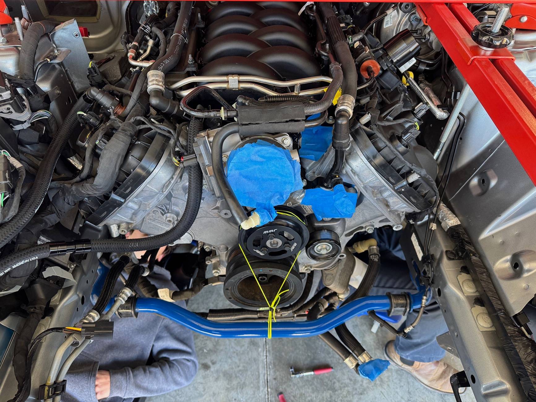

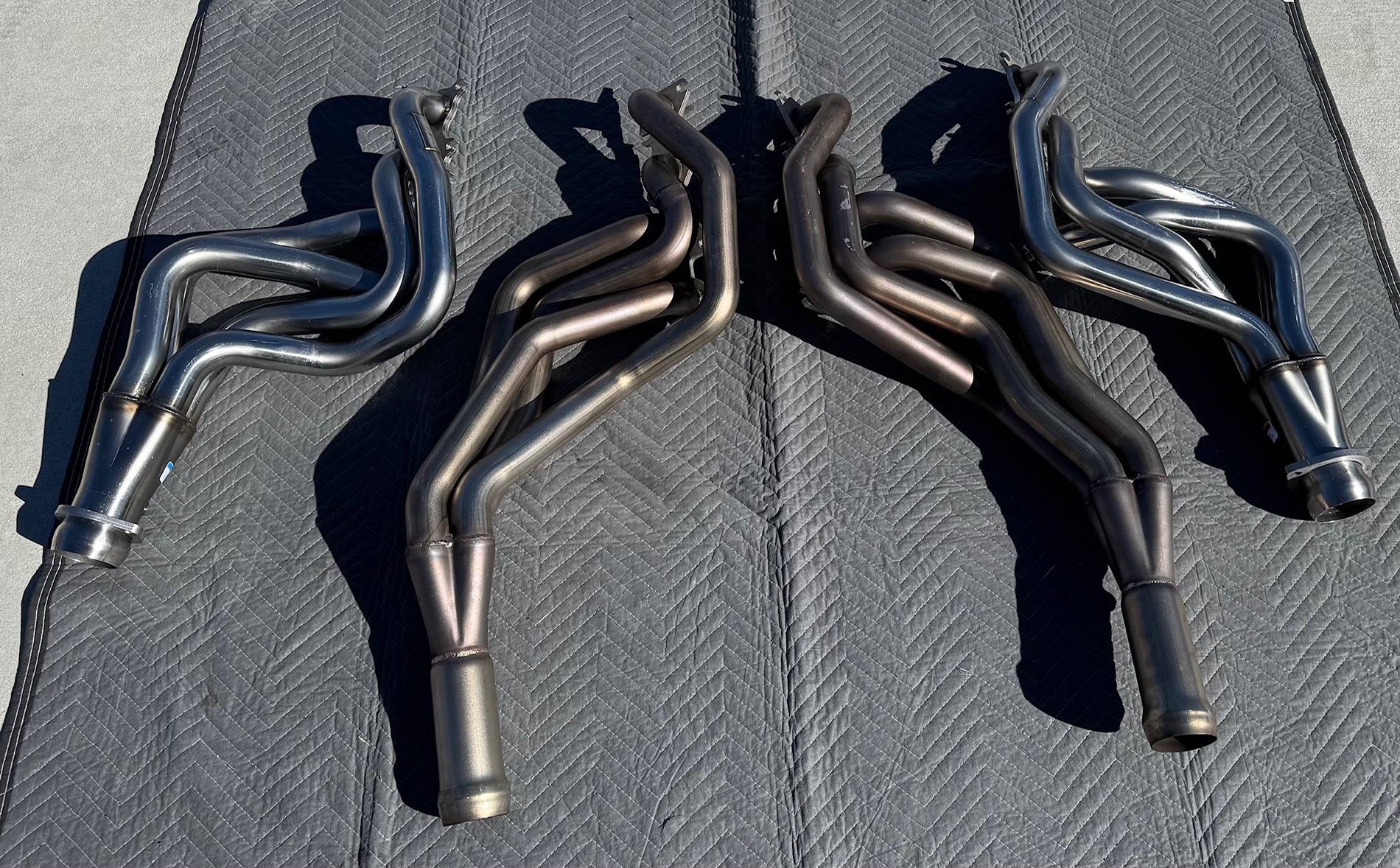

Ok, I've mentioned in a couple other threads that I ran into an issue with the 2M Fabrications headers. The 2Ms are longer than other headers which moves the upstream O2 sensors further downstream and long story short, the shift linkage (10R80 trans) hits the O2 sensor.
So, after right at six hours of work today, we (my nephew and son are handy wrenches) dropped the K-Member, dropped the oil pan (because I needed to replace the gasket), removed the starter and engine mounts, 2Ms came out, Kooks went in, and then reversed the process. Replacing the hanger studs for the K-Member is a pain, but there's a reason they're one-time-use.
Many know how I feel about 2M and why, so I'll speak now about Kooks.
They. Are. Friggin. Awesome.
The fit is far better than 2M, not that the 2Ms fit was bad at all, but the Kooks primary tubes are tucked closer to the block and they bent the tubes with a high amount of precision and more thought went into the design. There's tons of clearance for the steering shaft, A/C plumbing (if I had an A/C), and the O2 bungs are perfectly placed.
My son and I will button up the few remaining things tomorrow and we'll fire it up.
