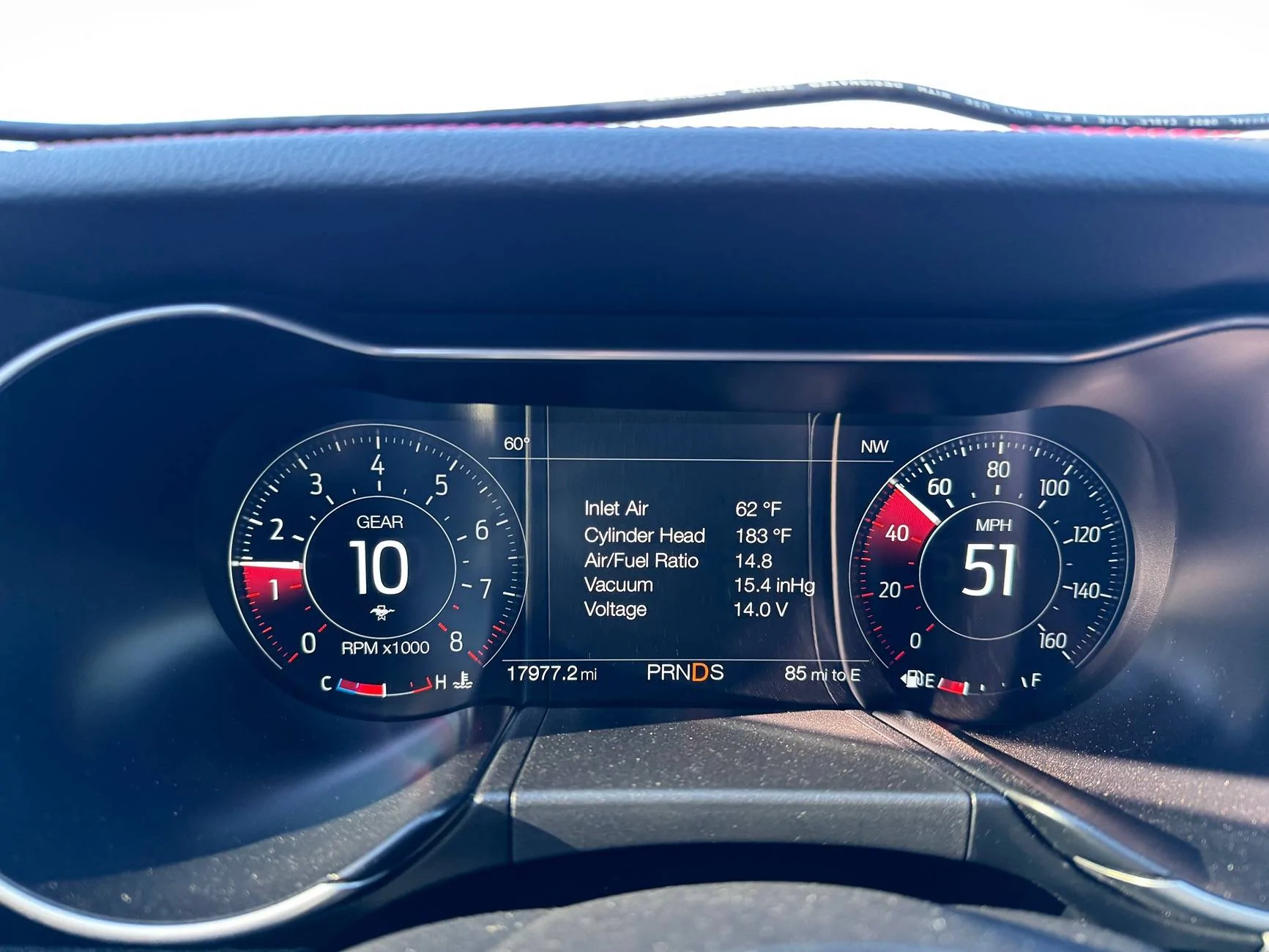

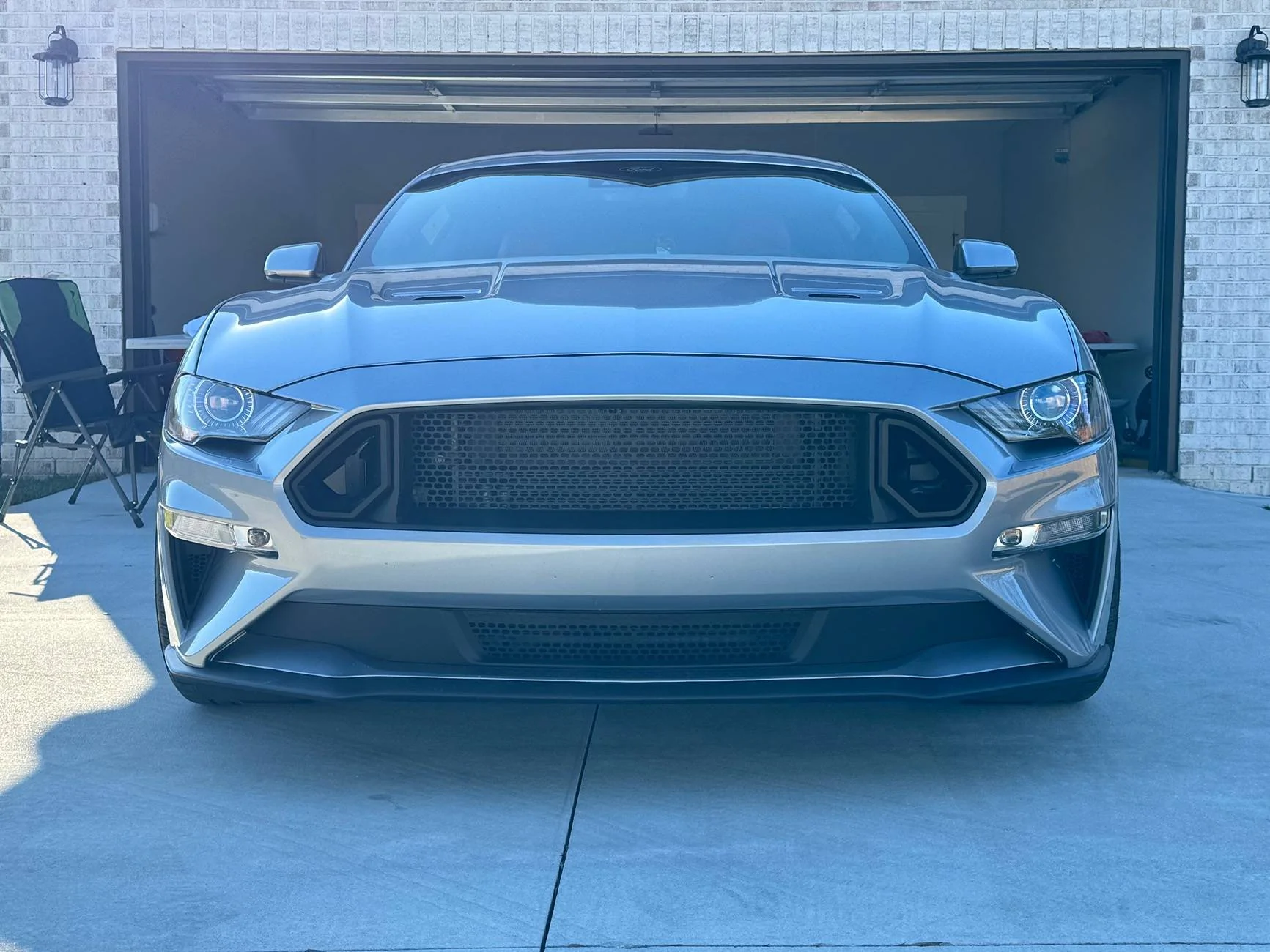

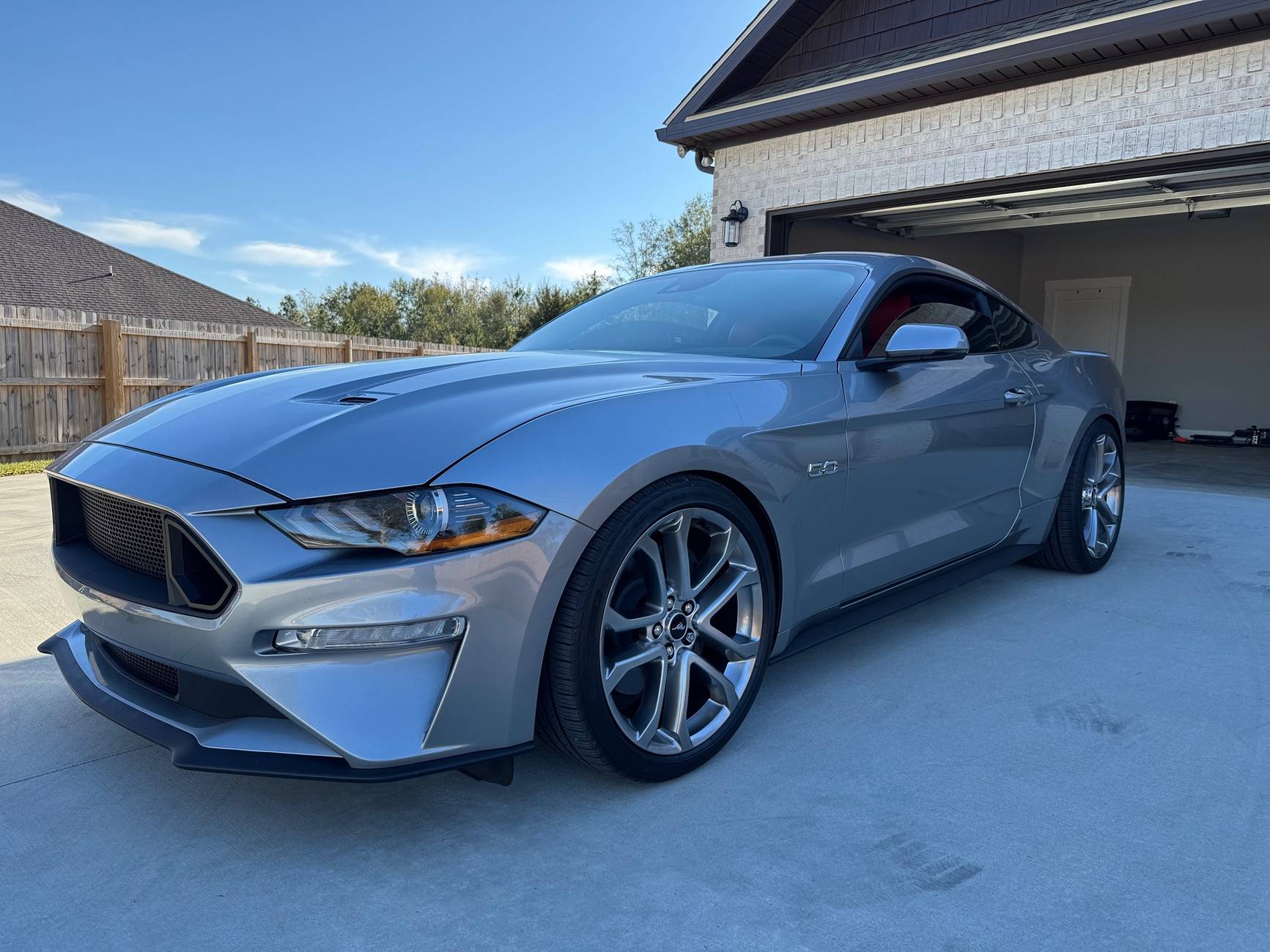

After leak check and rolling around underneath on the creeper, all was good. The front end went back on, front tires installed and torqued, fired it back up to idle and come up to temp. Then, it was road test time.
I don't know how much each individual heat management item contributed, but all-in-all, I'm highly pleased with the results. With a CHT of 183* (coolant temp about eight degrees lower), ambient at 60*, the IAT toggled back and forth between two and three degrees above ambient. I'll also add that my belief that the coolant pump impeller is undersized for this engine for performance applications has been validated by what I'm seeing. Comparing the Coyote coolant pump impeller to the GT500 impeller reveals quite a difference. Even with the 170* thermostat and stock coolant pump, I wasn't seeing CHTs this low. Also, evacuating heat and making the baffling that isolates intake air from engine bay heat seemed to do the trick. Could be there's also something to the heat shield on the bottom of the intake.
After five or so miles of shakedown, punching it is quite different than a month ago. It breaks loose at 50 mph, front end jumps, an he gawn....
A little bit left to tidy up on the baffling, tighten up one wiring harness and run about a 1/4 tank of 93 out, then it's fill up with E85 and squirt the tune in.
