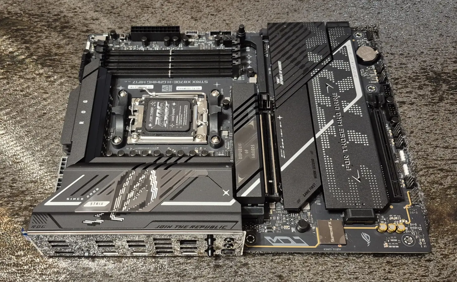

Motherboard: ASUS ROG STRIX X780E-H. So much I don't need but checks the boxes I do need. This will be my first AMD build.
CPU: AMD Ryzen 7 9700X. Will be running it at 65W to minimize heat.

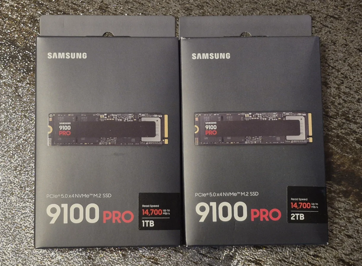

Storage: Two Samsung 9100 NVMe M.2 drives, a 1TB and a 2 TB. These will run at PCIe 5.0 speeds up to 14,700 Mb/s simultaneously.

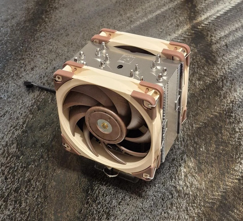

Cooler: Noctua NH-U12A.
This cooler includes two Noctua case fans attached to the tower.

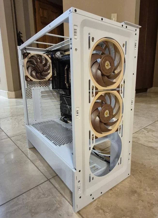

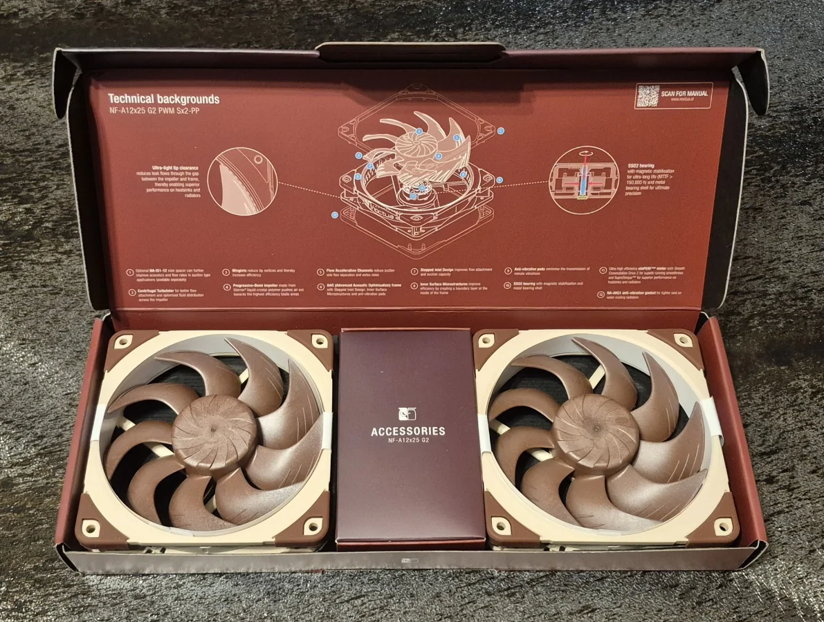

Noctua has released an improved version of that size case fans BUT have not announced a version of the cooler with those fans due to lack of production capacity. In this build the cooler fans will run faster than case fans. So..... I will be removing these fans from the cooler and using them for the front of the case. I purchased a pair of the Gen 2 fans to use on the cooler. When bought in pairs, the two fans operate at slightly different RPMs for improved acoustics of air flow thru the tower. I also bought a single to replace the factory NZXT rear fan. Stock fans still on in this pic.
The pair of Gen 2s for the cooler:

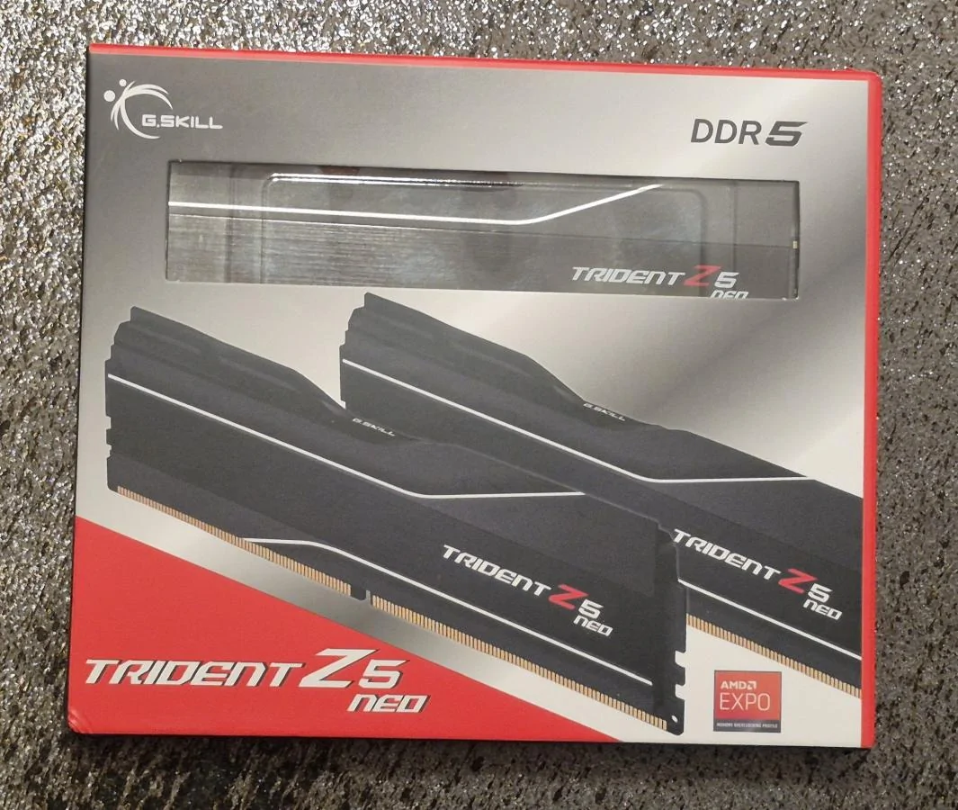

Memory: G.Skill 32GB (2x16) DDR5 6000 CL30. Were hard to find without RGB.

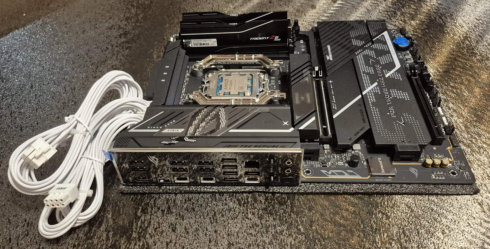

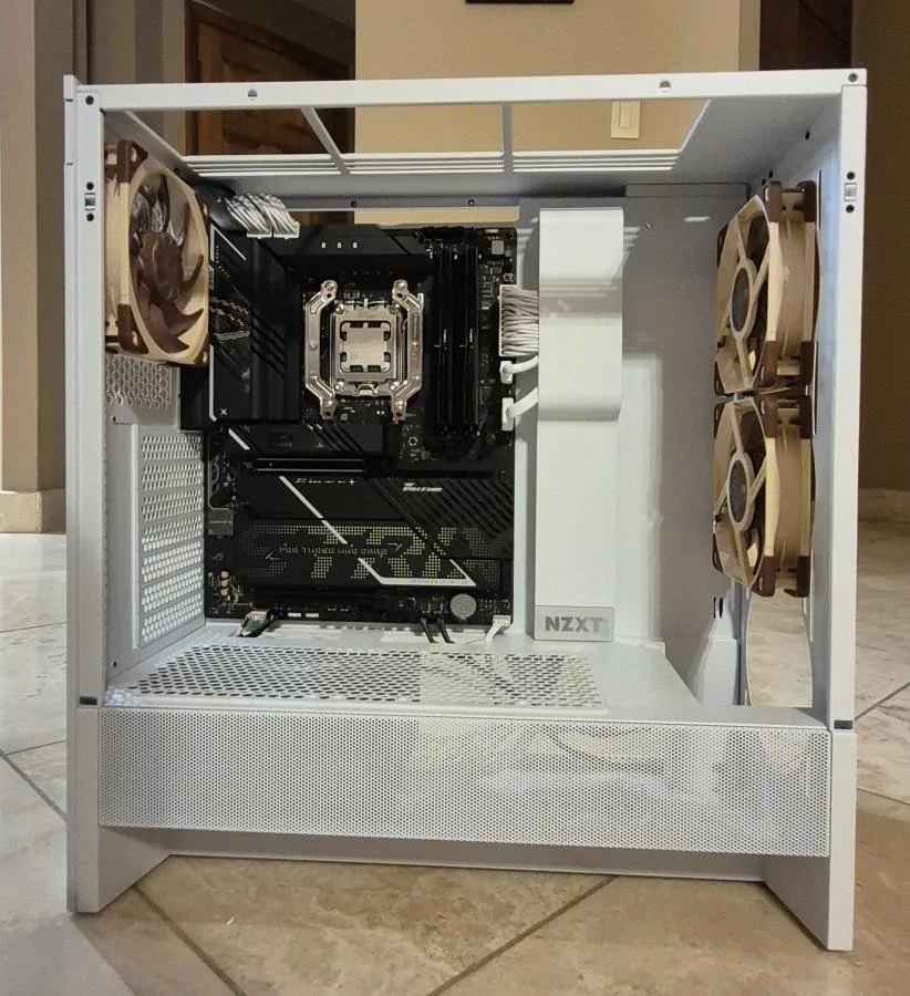

Motherboard fully populated with CPU, cooler mount, memory and NVMe M.2s. NVMes under MB heat sinks to right of CPU. CPU power cables on left preinstalled due to difficulty accessing the ports when MB in case. Cooler mount installed offset 7mm (to right in pic) since Ryzen 7 9100X is hottest that distance from center.

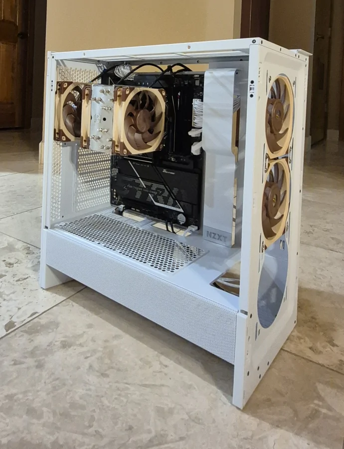

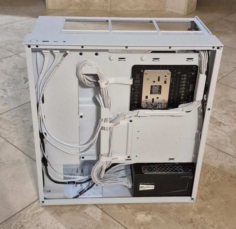

Case with power supply, fans and motherboard and all cabling done (motherboard power on right of CPU, case audio 3.5 and rear fan PWM on lower left, front fans PWMs and case power/reset on lower right, 20Gbs case USB and 5Gbs case USB on right under motherboard power). What a change in cabling from the 2019 build! 2019 had all those mechanical drives. None of them were used more than 1/2% of the time but they each had data and power cables in the case and all in front of the MB and in the air flow. The much fewer power cables are all hidden behind the front compartment and there are zero drive data cables.

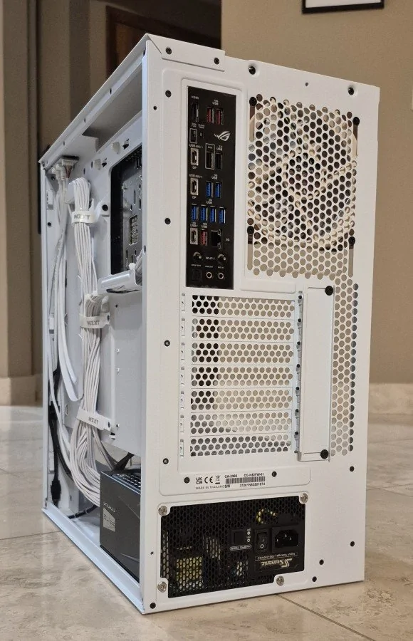

Back view showing cabling:

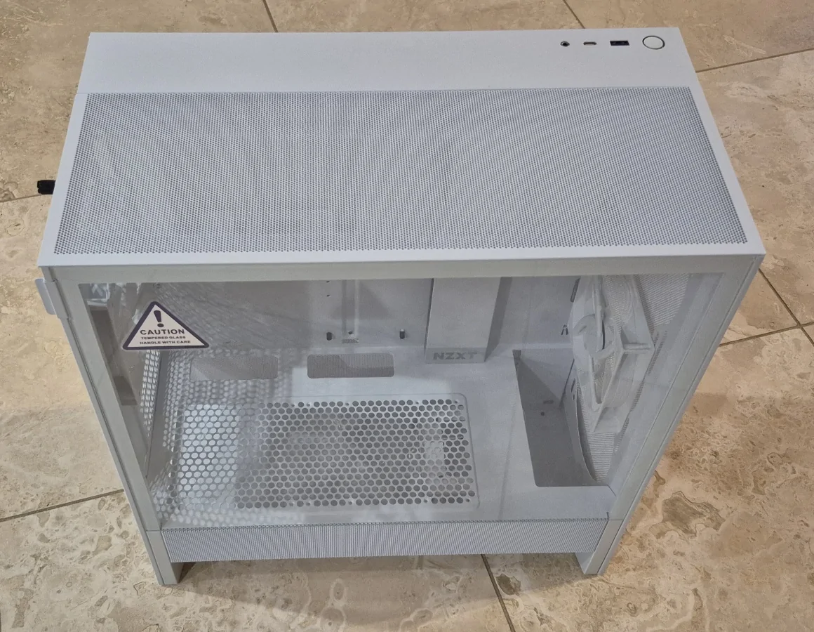

Front 3/4:
Rear 3/4:
Only thing left is the cooler tower and its fans. Tackling that fresh on a new day along with installing front, top and both side panels.

Done.

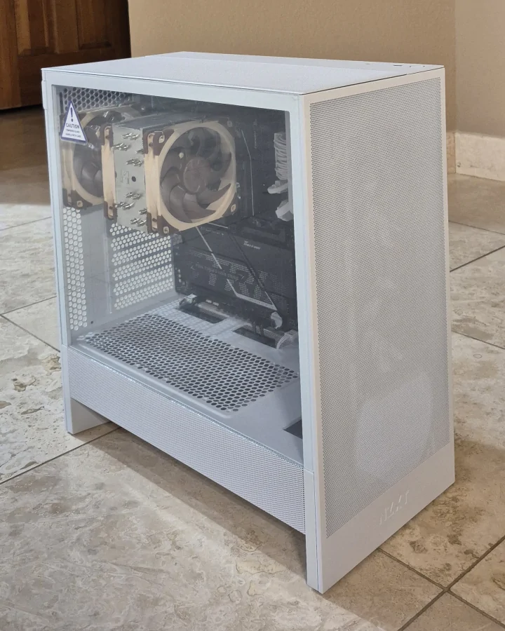

Cooler installed:
Buttoned up with front, top and both side panels in place: glass still has peel off protection film on it. Film is very cloudy. Will remove after in final location.
