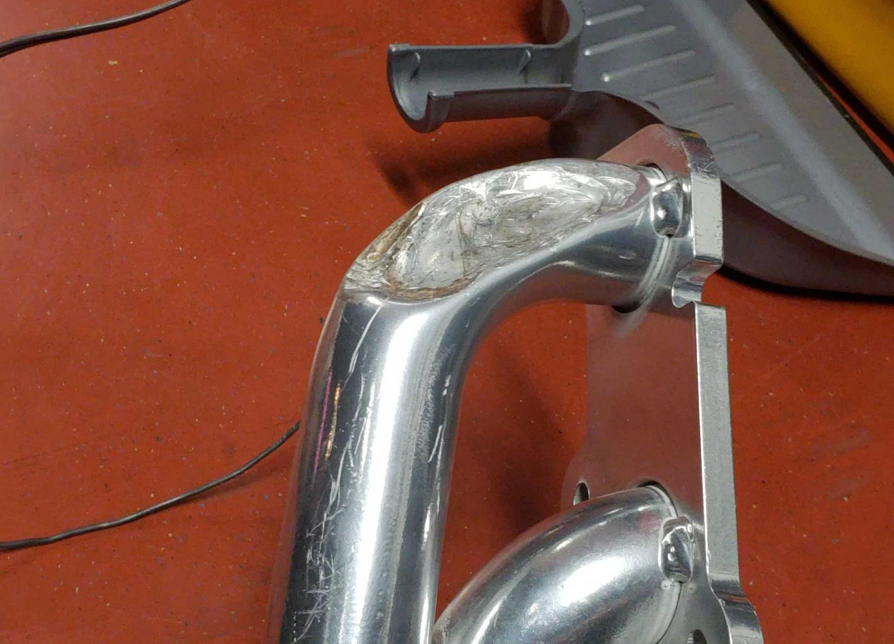

I have just installed 2017 bbk long tube headers on my 2018 mustang. I am writing this to let you others know that they do not fit on the passenger side. I made mine fit by heating up the one pipe that was in the way and banging it into the shape i needed to fit around the AC compressor.
It was an enormous pain. Due to how these headers are designed i had to put the motor mount on before the passenger side header went in and work around it.
I also had to extend the driver side upstream 02 sensor as the extensions that came with the kit were for the 17 and below 02 sensors.
Took me about 12 hours of actual labor hours. Car was on 4 floor jack stands. Passenger side took me about 9 hours. Drivers side took about 1.5. The rest of the time was for the mid-pipe and clean up.
Point is, if you get these, you will have to form one of the pipes to shape otherwise it will not fit at all.

You should have taken a picture of what the headers looked like after conforming them to make them fit.

Good idea. I remembered i actually took a picture of this. I added it to the original post.

Damn, you beat the piss out of that header! Are you concerned at all about exhaust flow?

Not at all. There is actually an Engine Masters episode in regards to this as this type of thing as it is not that uncommon. The link for the episode is below but essentially they did not lose power and sort of gained some. Either way that was not much of a dent anyway and only on one tube. As far as back pressure, it would create such a tiny amount more that it would be completely unnoticeable. So no worries there. After these headers and a tune. The car got a lot faster. I will be doing a dyno tune soon, but my butt dyno tells me it is notably faster.

Yikes! Good looking out to let others know. I agree it probably won't affect performance much if at all but my OCD would kill me over that. I know what its like to be in the middle of a multi hour install and get stuck like this and just say EFF it though!

Lol yeah. At that point i already spent 3 or 4 hours taking out the stock one. I was not going to let that stop me. Plus i do not really mind. It is only visible under the car and only if you use flashlight and look behind the motor mount.
