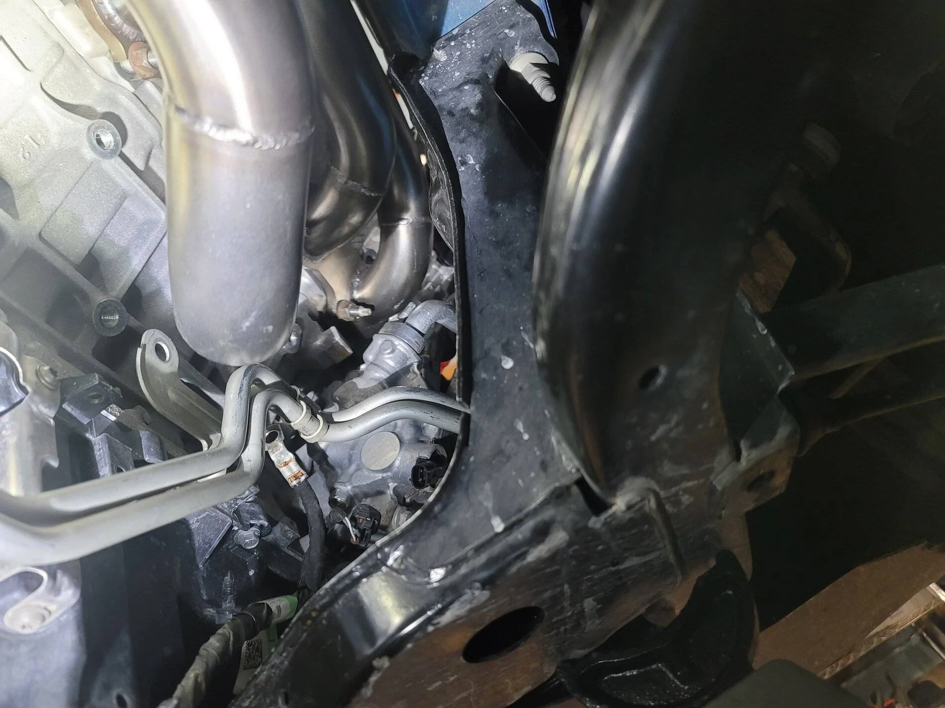

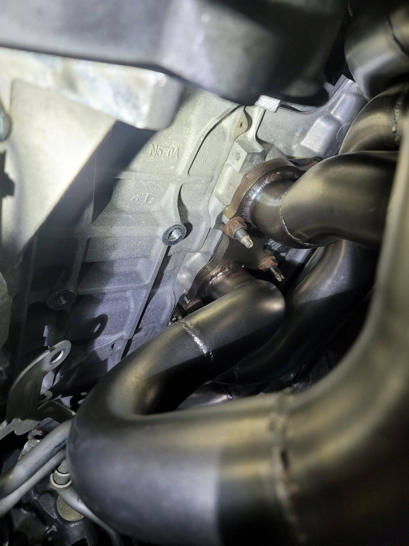

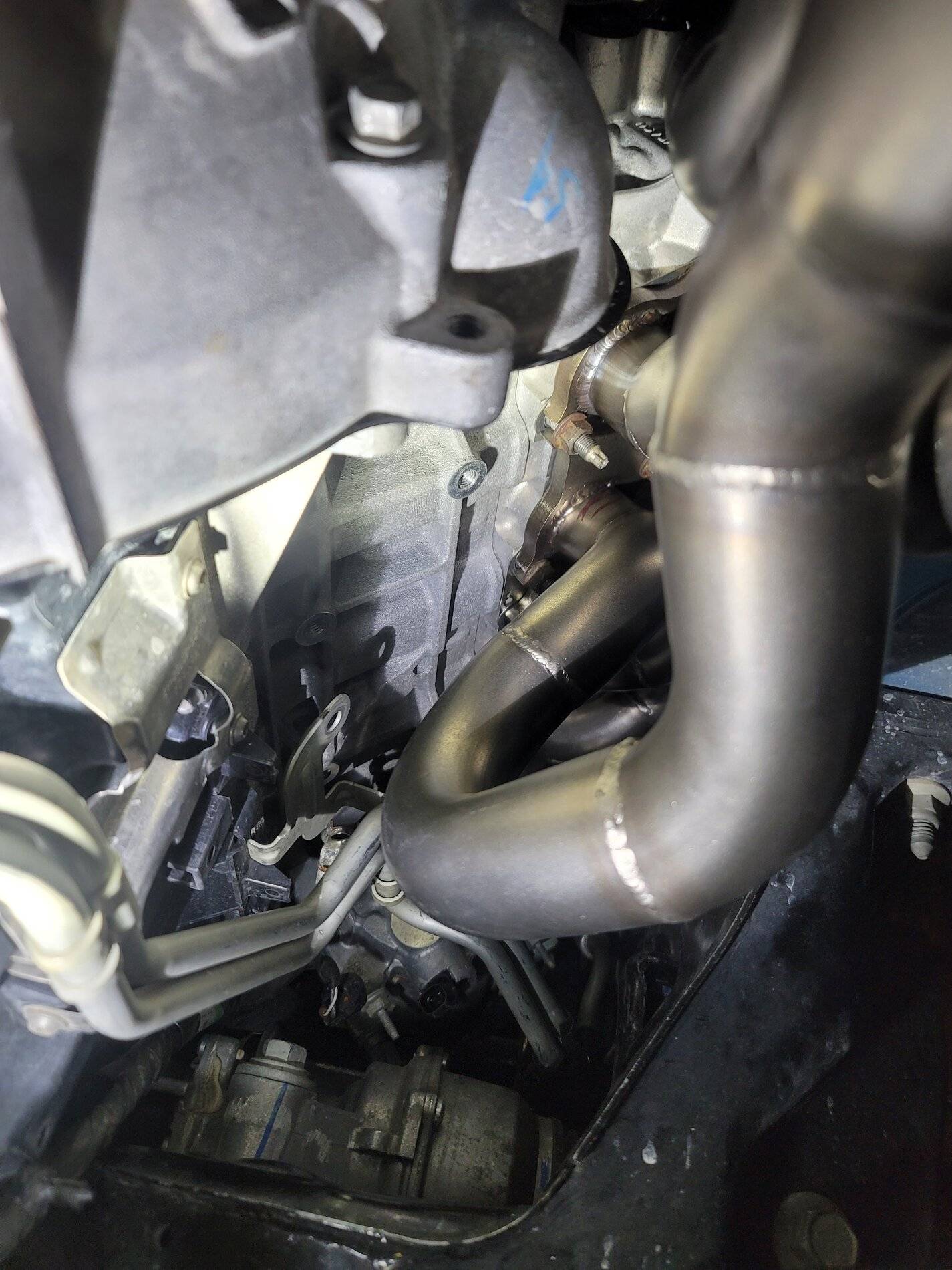

Here is a few pics not the greatest I cant get the mount behind where header loops out most other brands don't have that big loop

Yeah it sucks that its the passenger side but you might actually need to pop that pipe into place. Will the bracket actually sit over the holes or is it because you can't get the bracket behind the piping?

Wow! I’ve never seen any GT headers that have that huge loop in the primary tube like that. You may have to check with the manufacturer to see if they offer motor mount brackets that will clear the loop.

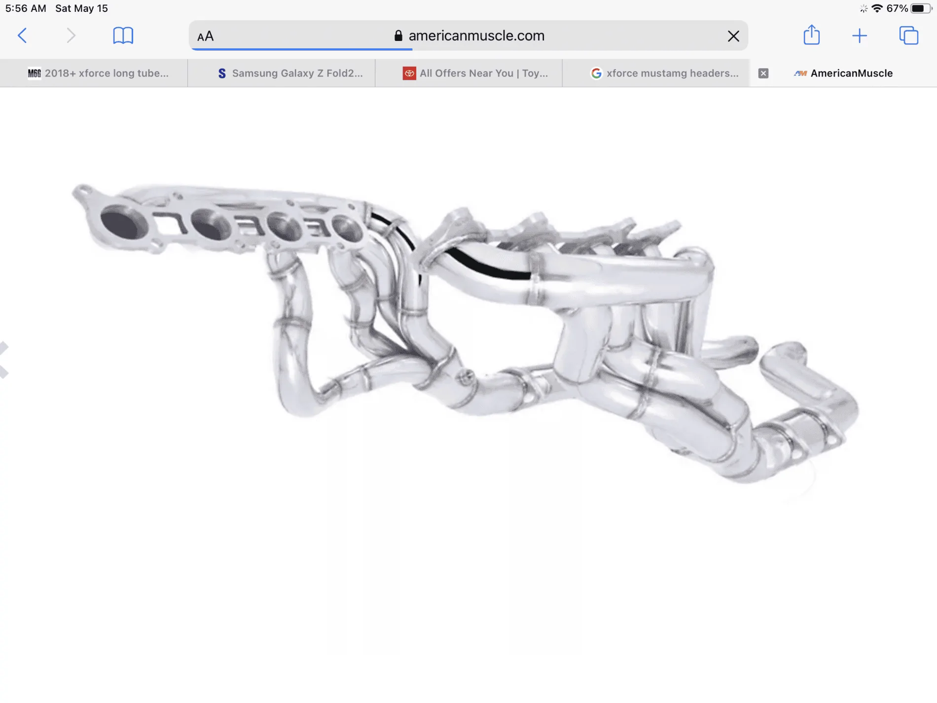

The loop looks really tight in your photo, but based on this photo from American Muscle’s website, you might try to turn the bracket on its side, insert through the loop and then rotate it back down flat into place in order to bolt it to the motor.
