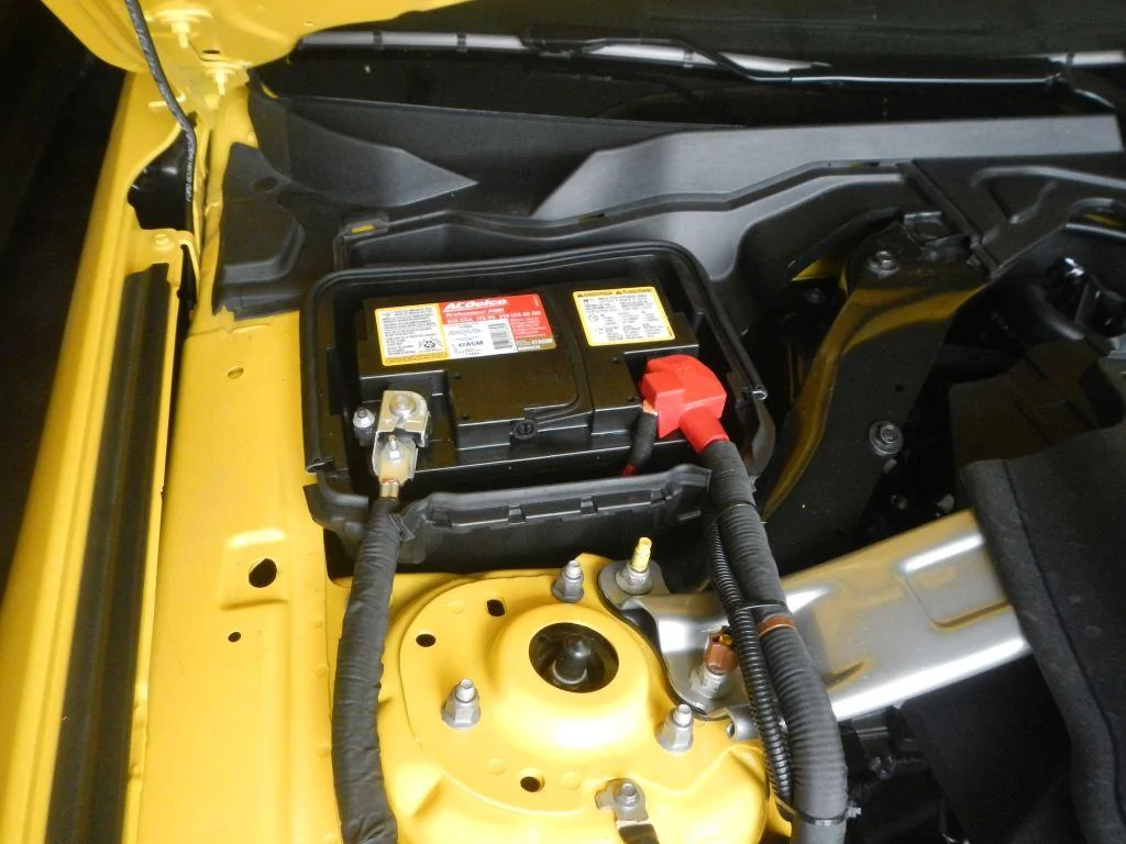

I had the car-shuts-off accessories-to-protect-the-battery effect that would stop everything after about five minutes. About a month ago I.replaced the battery with a stronger one, and the shut-off came after half an hour. It still seems as if the interval is longer after a lengthy road session. I believe the problem is in the Battery Monitor System, which apparently requires a "reset" when a new battery is installed. If no reset, the System thinks the old battery is still in place, and regards it as "aged", so it is treated differently as far as charging rate, etc.
I offer this as evidence that the BMS sees the new battery as "aged": I have a modern Schumacher battery charger which fully charged the new battery, but when left on overnight claimed the battery needed desulfating. After ten hours in desulfate mode, it declared the battery BAD and showed a few codes to support its contention. The BMS had told it there was an old, aged, failing battery in place.
I think the new battery is faultless—it behaves normally except for the half-hour shut-off—and the BMS is just doing its job as if there were an old, decrepit battery installed.
After perusing several forums' threads about BMS reset, I've begun the process necessary to using FORScan to do the deed. Got a laptop, downloaded the software, acquired the connecting bits. But just in case, tonight I put the car to bed with everything turned off and all locked up, which some have said should let the BMS reset itself.
We'll see. It would be a shame to have to go the the dealer and ask them to apply their tool, which I presume they have and know how to use.
