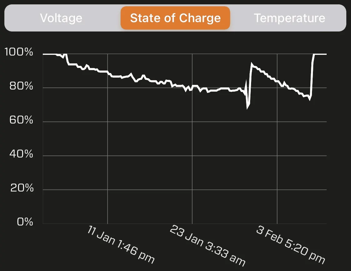

I have noticed that the decay in battery voltage / SOC is much faster following a 20 mile run than it is following a stint on the battery maintainer :
WD :like:

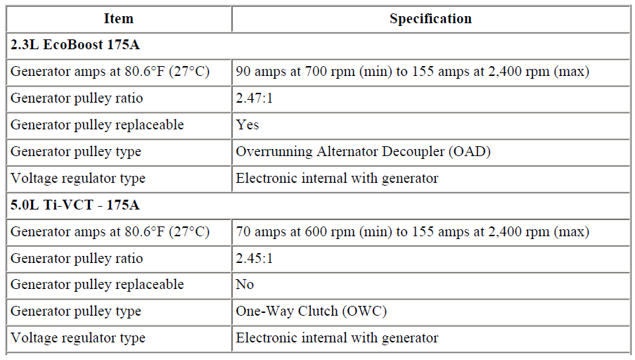

Here's what the service manual says about the alternator:
Strange that it's called "175A" when in fact it will max out at 155. Kind of like Mercedes 6.3-branded cars which are actually equipped with 6.2 liter engines. :giggle:
But anyway, it seems to charge at idle, too. I think 70 amps should be enough to charge a depleted battery, given enough time with no massive consumers turned on. Of course it will be slow, but at least it will charge, eventually.
