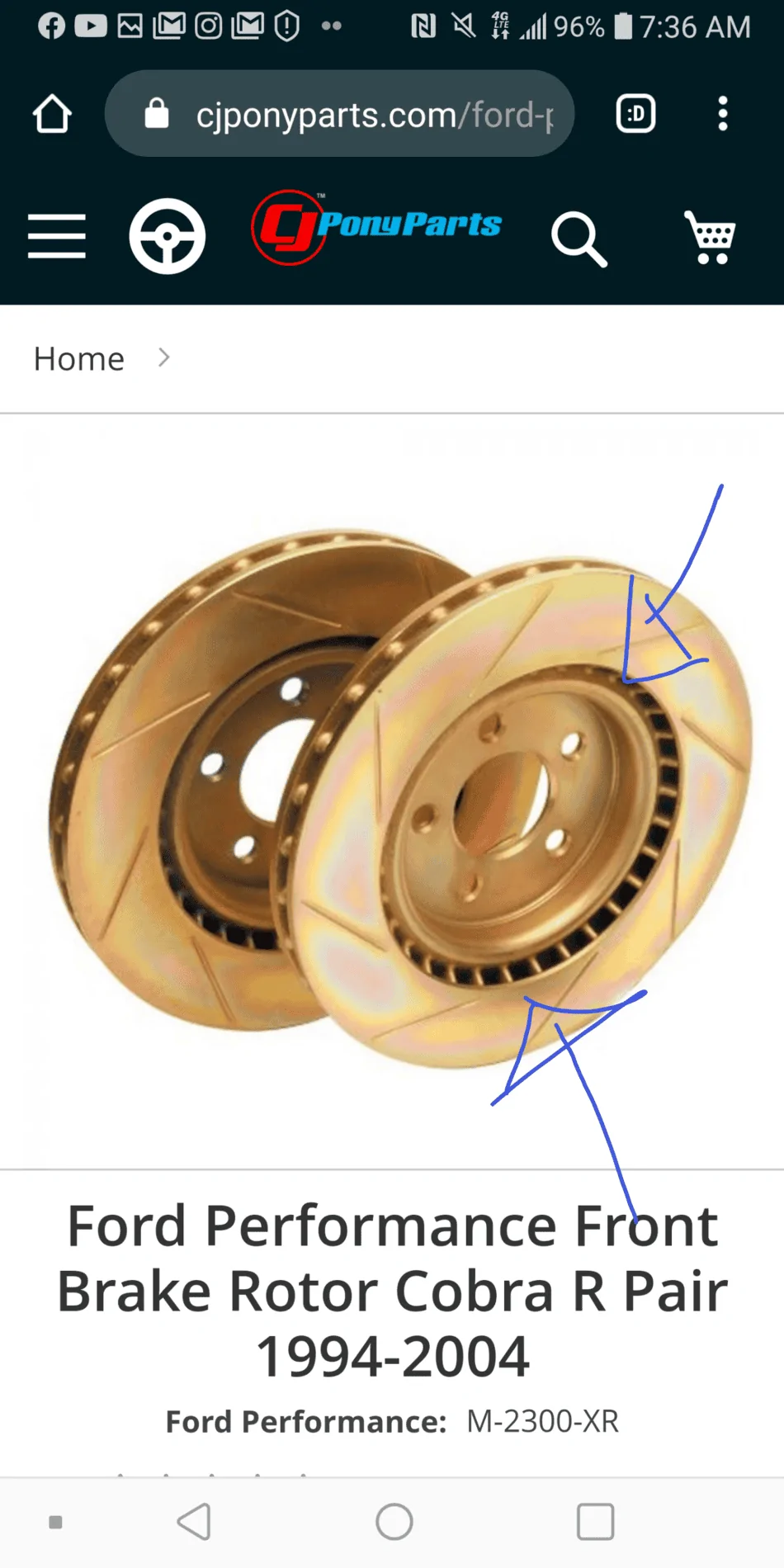

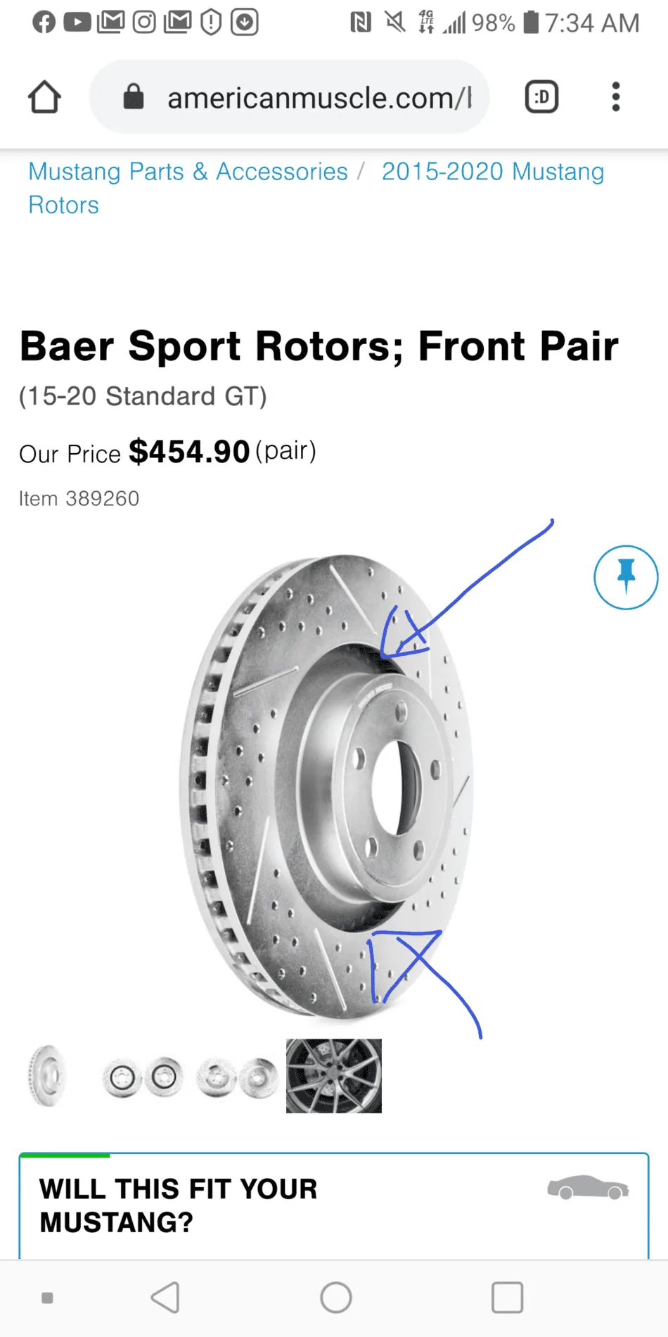

Care to elaborate on the reverse rotors?
Sure
The base model has a 4 piston brakes in the front with smaller diameter rotors
Rotors are also "reversed" meaning the vents for cooiling are outside ( grey rotors pic ) instead of inside as normal ( gold rotors pic)
Pointing vents outward means that no air is getting through because the bumper and the rotation of the wheel "push " the air away.
While when inward the rotors receive way more air from under the car (another difference is pp1 has tunnel in the splitter that are targeting the rotors trhough a deflector to push more air into the brakes.
Many people have tried to make those brake working on the track.
It is not just impossible. It also dangerous. Cause when u are in a straight at 140 and u need to turn at 60 loosing the brakes is not nice :)
